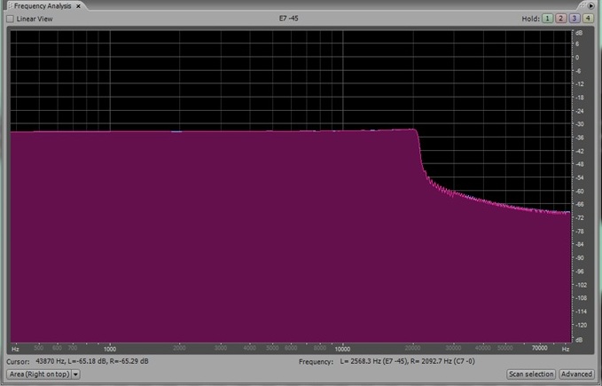

1nf is too large, try around 200pf. That should give you an f3 around 150khz.
Thanks Bill,
I tried this out, but the 1 nF had no impact in the visible audioband.
I asked David Carter. He told me that the 1k resistors after the Dac were responsible for the early frequency roll off.
He was right. I removed them and now I have a perfect frequency response!
The sound is extremely good, much better than before, but I do get a very hot signal now.
Maybe I should try the windings in paralell instead of in series...
