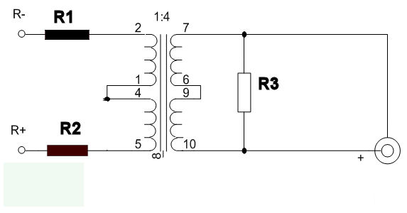

What is bothering me with this PCM1798 board is the two op amps we see under the board. I want to get rid of op amps. Op amp are devil for me.
But I did it. I got rid of opamps, I desoldered them and connected transformers right to the chip's legs. And grounded center taps.
Frequency Response with Lundahl 1674
I am listening to my DAC with Lundahl LL 1674 for some weeks now.
I attach a picture with how I connected the Lundahls. I use two 1K resistors for R1 and R2 and no resistor for R3.
I also have a 1nF MKP cap connected between the output sides of R1 and R2 as a very light filter for high frequencies at the input side of the Lundahls.

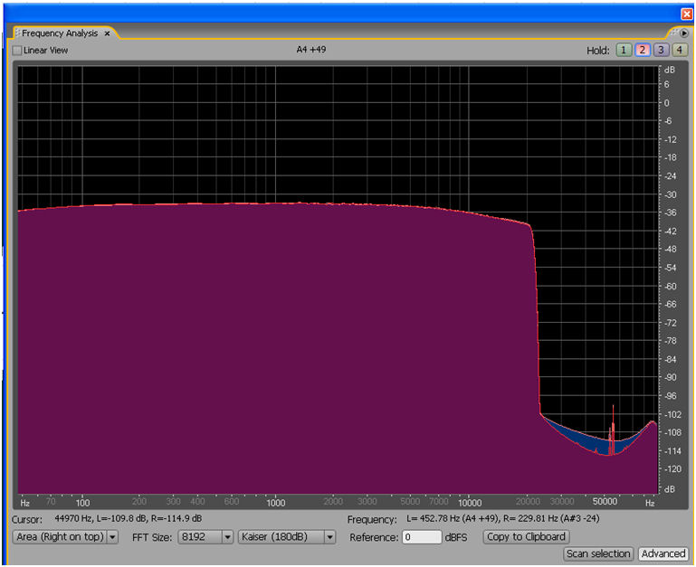

Today I measured the output of this configuration, and I wasn't pleased to see the frequency response. As you can see on the picture, already at 20 kHz the level is down by some -6 dB
These Lundahls should be quite flat up to 20 kHz, so apparently my connection is not optimal.
Can anyone give me a clue as to get better results?

1nf is too large, try around 200pf. That should give you an f3 around 150khz.
