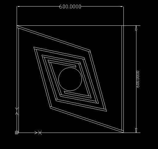

In fact, the main idea was about making the most effective use of a pair of drivers that are still sitting in a box: CSS 125 FR.
At first I was very enthusiastic about building the Spiral Cornu, but the enthusiasm subsided as I realized that this driver is not really suited for horn loading...(so no Cornu for them)

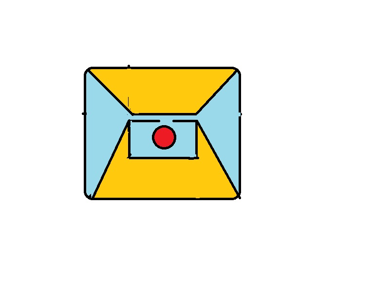

But...how about building the "Cornu-like" box which will in fact be the bass-reflex design, but with the ports expanding into mouths, not much unlike the Calhoun", but in Cornu style
I tried to make a rough sketch. A reflex box with the ports expanding on both sides. The area filled in yellow serves no purpose. It could be entirely cut-out or filled with something...

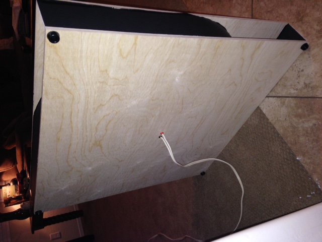

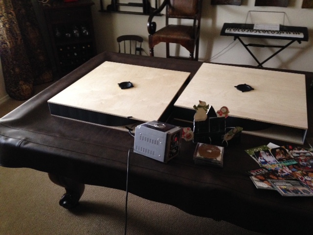

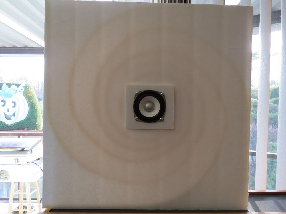

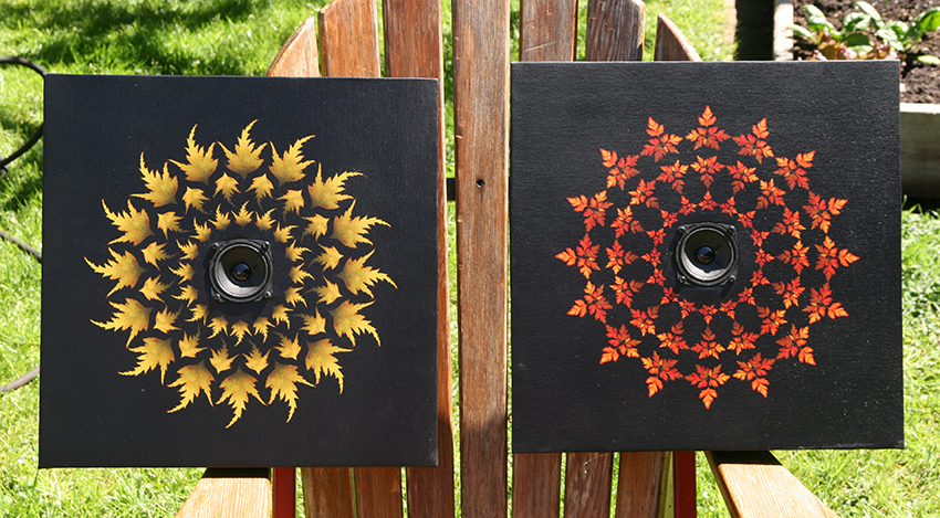

To X and Cal, thx again guys for the inspiration and inputs last month. November was busy closing out our fiscal year at work, elk hunting for a week (actually just camping wearing funny camo outfits as there were no elk to be had), a few days in Mexico, Thanksgiving, etc.
I finished up the speakers and got to install them for my friend's new venture. I love the detail and clarity these bring out, had a great time setting them up the morning of 12/5 and having them be part of his party later that night. Easily filled the room with great audio and was a conversation topic throughout the night.
I'd consider these "prototypes" after now having done my first run of these. Time will tell if I do more (the ideas to improve build construction, better materials, resonance elimination, etc. are all there!!)....but very glad I did something a bit bespoke instead of just picking up something from Craigslist or BB. Much more time-consuming than I'd initially estimated but aren't all projects like that?
No pics (today) of the grills with the screen-printed logs I did - just forgot to snap pics of those but they turned out much better than I'd ever hoped they would - really was a nice touch.
Go for it if you think you want to give these a shot....they truly do sound 100X better than what the little drivers seem to be capable of producing. Pics below (you can see them hanging in the background of the last pic if you look close).....take care!!!

Congratulations tli!
What driver did you use and what is the size of the speaker? Those look like Faital Pro 4FE35's?
Nice party! Never seen anyone hang them up so high.
Good eye, those are indeed the 4FE35's (you recommended them back when I started out in early November, very happy with them).
The installed location (height) really worked out well for the office setting. They were intended to service background music but really do lend a lot of detail when there aren't 75 people milling around and you can spend time doing a little critical listening from about 25' away. Quite a few members of his staff were doing a little listening with me during the morning and were all really impressed. Fun stuff!
Cabs are 29.5" x 29.5" (cuts worked out that way based on what was on hand at the local supply store), foam board is ~3.5" tall (from memory).

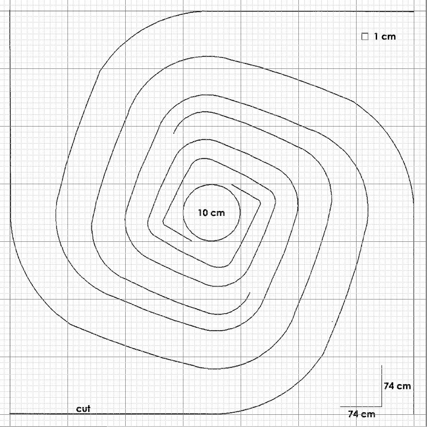

Design
The "spiral" in the original design is mostly made up of straight sections. There is an alternative smooth-spiral design. The designs can be scaled up or down to accommodate different drivers. The 70 cm (29”) version shown in the image is appropriate for drivers with an 11cm (4.5”) diaphragm. It should be scaled down to 60cm (24”) for 7.5cm (3”) drivers and up to 90cm (36”) for 6” drivers.
Note that both of the above designs are labelled 74 x 74 cm (29” x 29”), but the layout of the underlying grid and the 10cm central section both suggest that the actual dimensions of the speaker are 70cm x 70cm (27.5” x 27.5”). Since it is expected that the design will be scaled up or down according to the size of the driver, this inconsistency does not seem particularly important, but it might be confusing to a newcomer.
The total throat area at the exit from the cavity behind the driver should be somewhere between 0.5 and 1 times the driver’s diaphragm area, Sd. That is, if a standard Cornu design (with two channels exiting from the cavity) is used, each of those two channels should have a throat area of 0.25 to 0.5 times Sd¬. For an Alpair 10 driver with an Sd of 88.25 cm2 and a channel with a throat width of 2.5cm (as on the original plan), the channel walls would be between 8.8cm (3.5”) and 17.7cm (7”). Making the channel walls higher would necessitate in narrower throats, which would attenuate the bass.
J.A. Dinsdale’s 1974 Wireless World article about horn design has an alternative formula that produces a similar but not identical result.
For a given cutoff frequency, f, the throat area, St is given by
St = 2 π f V / c
where V is the volume of the cavity
c is the speed of sound (340ms-1)
So for a cavity with a radius of 7cm and a height of 17.65cm, and a cutoff frequency of 100Hz, the total throat width would be 2.8cm, so each of the two throats would be 1.4 cm wide. This is at one end of the range given by the with the “make the throat area between 1 and 0.5 times Sd” rule. It is thought that the sharp turns help in filtering out high frequencies from the bass channels, but smooth exponentials have also been used successfully.

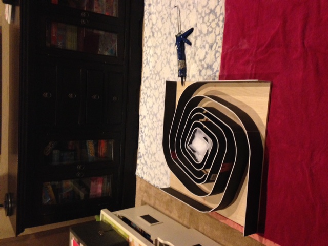

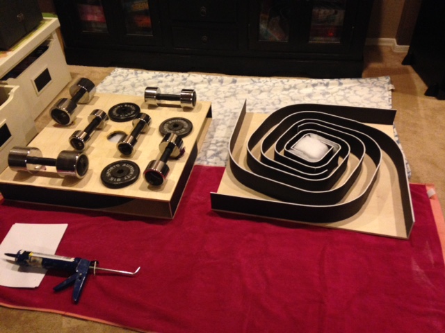

Construction
Channel walls are most conveniently made of foam core material such as picture framers use for backing on watercolour paintings or prints. It is light, easily bent, easily glued, and comparatively cheap. Plywood and mdf are significantly inferior for this purpose.
The preferred method of construction is to hot glue channel walls to the back baffle, following the pre-marked spiral path, from the middle to the outside edge, taking care to ensure that the junctions are sealed. Hot glue grabs well in a few seconds and allows a short time for adjustment of the channel walls. It helps to pre-form the foam core by bending it around some convenient edge, such as a counter-top, and also if slits approximately 3mm (1/8”) apart or less are cut on the inside faces of small-radius curves.
It is not feasible to attach the front baffle with hot glue, so an alternative technique is used; anoint the tops of the channel walls along their entire length with a liberal amount of caulk, place the front baffle carefully in position on the caulk, weight it down, and go away for several hours until the caulk has set. If the height of the channel walls is not consistent, it may be necessary to build the low points up with hot glue or sand the high points down before applying the caulk.

Palmiepaul:
Great summary! You really did read the whole thread - wow! One important thing to add to the "Construction" section:
is that the foam core channels should be scored every 3 to 5 mm (perpendicular to the length of the channel) with a sharp razor sufficient to pierce through the paper cover layer of the *CONCAVE* side. This allows the compressive forces felt by the paper to be relieved when bending the channels on the preformed curved surface. If you score the convex side, the bending will break it apart. A good way to precurve it is to lay it on soft carpet after scoring and roll a 3 in to 5 in dia object like a large cardboard tube, a can, etc on the channel slowly back and forth to curve it.
Otherwise, you are spot on! I would ask Cal to link this particular post to his first post as a "Quick Start Guide"

And do you think my suggestion about a front-horn, rear-chamber design, which seems a logical consequence of a couple of the other posts (yours about a larger chamber and Cal's about a flowerpot - which seemed as though it might be a bit fragile, so I thought of a recessed front horn) made any sense? I've included a sketch.

Sorry I missed you calling it slits. To me that sounds like cutting through it where scoring or just piercing surface of paper is how I would have said it. You can only edit a post after 30min if you are the thread starter and it is the first post or if you are a moderator like Cal is.
Your front horn with back chamber idea is pretty cool - give it a try but don't make the bake chamber too big. You can use your formula to calculate cutoff frequency.

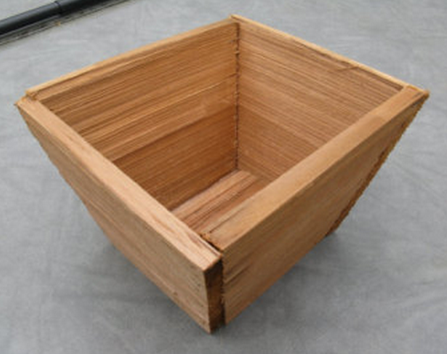

I am thinking of the flower boxes made from red cedar. I keep forgetting they're not available everywhere. It's a very common wood around here. It's like it grows on trees. This one here looks to be hand split and resawn on the ends. Not perfect but that's the idea.Cal's about a flowerpot - which seemed as though it might be a bit fragile
Joined 2009
It should work and the sharp edges will filter the mids and highs out better. This design does not have the dual length horns so will not be as smooth in response. Should work though given you use some math to calculate the expansion and length needed. Combined with chamber volume and throat gap.

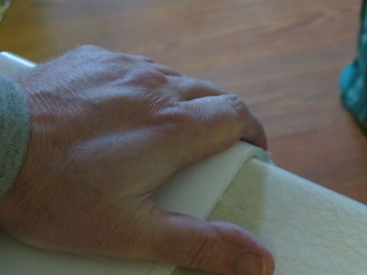

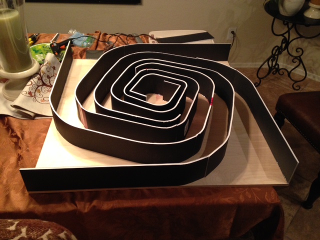

So, I just finished the first of two cornus and I'm pretty sure I messed up. I'm getting nowhere near the copious amounts of bass that probably requires stuffing to attenuate. Quite the opposite, I'm just barely getting enough, even with the speaker stood halfway up the opposite wall. I believe I didn't get the channels sealed enough on the baffle (that I added last). I initially hoped getting it good with adding a few, thin pieces of wood at the mouths and in the chamber and screwing the halves together using them. After that failed, I tried sealing it up with wood glue but I think it's just not good enough.
Anyone have any tips on rectifying this? The front and back are sturdily glued to the channels, but maybe not everywhere. It's like I can hear the bass energy getting sucked out by the movement of the foamboard.
That's too bad. Air leaks will kill any bass - it's like leaky pads on a flute, can't hit the low C.
If it's all made of foam you can surgically poke some "windows" in the back to access the channels and add more glue like caulking. Glue to windows baxk once done. Might just have to start all over. Make sure your foam channel is of uniform width. That is what makes a good deal when you cap it off.
Yeah, starting over is always an option, I guess. A bit bummed since I started this one this spring but only got around to finishing it now, so it seems like a monumental project. Also, I could only get a hold of 3mm foam core at the time, so I built it with two layers of it, for a total of 6mm, so it's close to twice the normal work, I guess. Maybe getting hold of 5mm and making more even cuts would help. Quite hard to make sure of that before it's too late, though.
