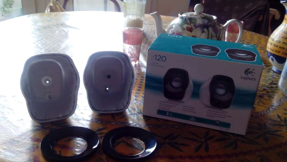

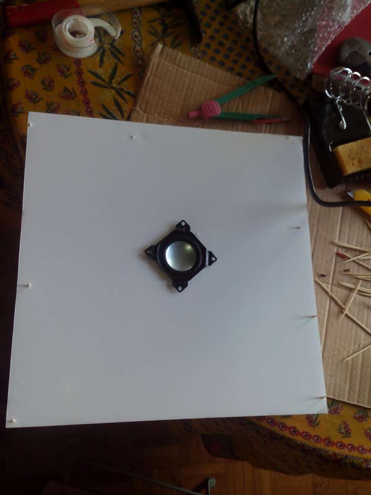

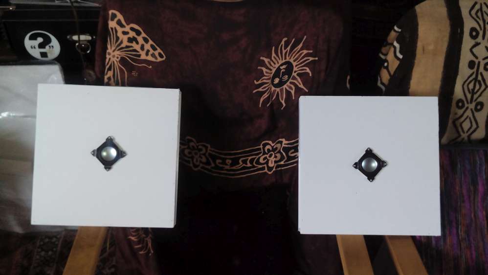

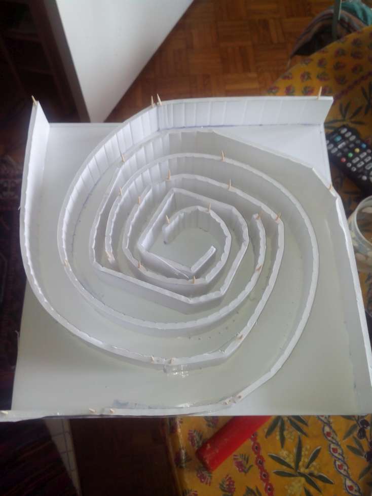

Some pics and comments about the 14in (actually really 30cm / 12in) Cornu.
I used 5mm foamboard for both front/back panels and channels. Depth is 4cm (1.6in). Throat depth circa 8mm (0.3in).
I didn't have a hot glue gun so used universal glue for the foam (and mastic to fix the drivers to the foam). Holding the 5mm foam channels while glueing was a bit of a pain so I used toothpicks to keep everything in place.
I'm still looking for a way to make them look pretty(sh). Maybe I will cover them with some hand-made crafty paper.
Overall sound is nothing spectacular but definitely much improved from within the original Logitech z120 plastic enclosures. All in all a fun 4 hours project

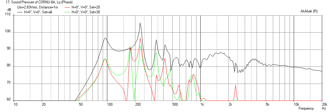

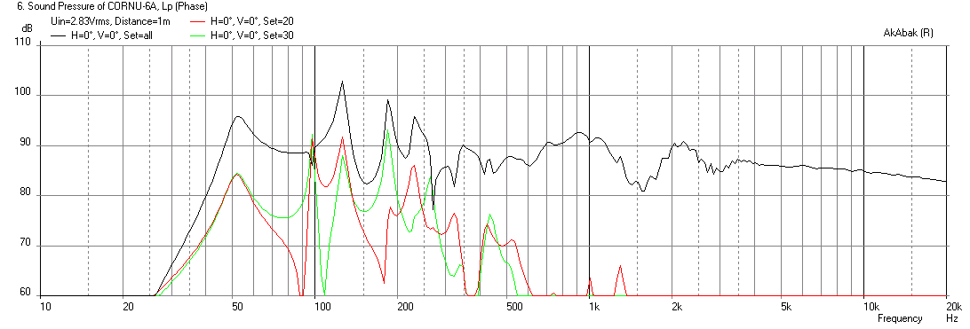

The Monacor SP50-X can work in as small as 30in x 4in but I would go all out and make it 36in x 5in and you will get some real eye-opening bass down to mid 40Hz. You will need to add damping material in channels to tame the bass peak, but that is easy and you will have a quite the conversation piece. As Cal has said, the 36in wins hands down and this is a 5.25 in class driver and deserves a big Cornu.
Here is SP50X Freq Response mounted on wall 1.34cm above floor (don't worry about those peaks - they all smooth out with foam core channel flex and stuffing in channels):
Here is the RS100-8 (really a 3.5in driver) in a 20in x 2.5in Cornu:
Two very different speakers - one is huge and the other is a very moderate size for most types of music with bass down to 85Hz.
