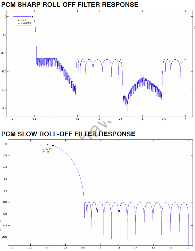

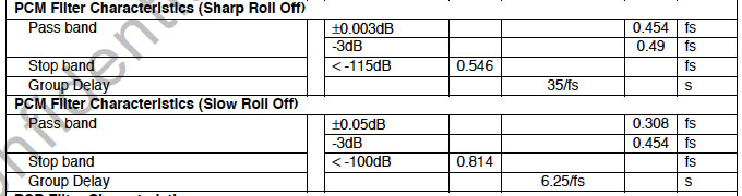

Looking into the possibility of adding a few dB of headroom to the es9018, I have to learn everything from scratch. Those of you with specific knowledge about the es9018 can probably save me some time, if you would be so kind.
We know that the es9018 has two built-in FIR filters in the OSF stage. Note below the specs and traces from the data sheet. The slow roll-off filter, which sounds nice in my system, looks like the simpler of the two functions. The fast roll-off profile almost looks like a second low-pass filter was added to the result of the slow roll-off function. Is that impression correct? If so, then perhaps my best approach is to a) learn which of the two built-in filters results in the slow roll-off response and continue using it, then b) add a gentle high-pass function to the other filter block.
...and just confirming: the filter's operating frequency should be 64*fs, which would be 2.8224 MHz for 44.1kHz I2S?
Can anybody comment on this and/or add helpful information?
Many thanks in advance!
Frank
Frank
