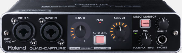

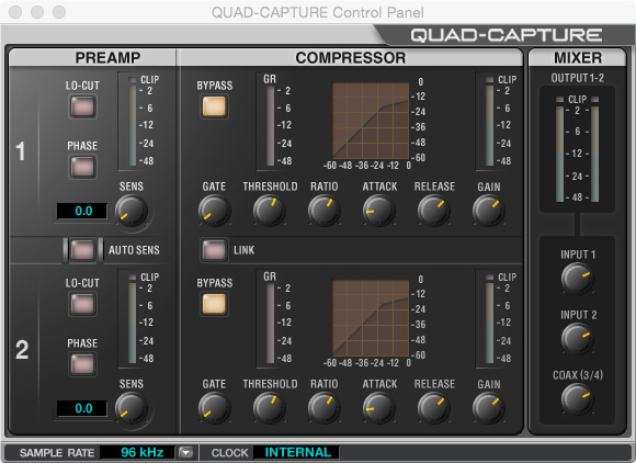

The input sensitivity is set with the dials (one for each channel) on the front of the Quad Capture. The box can also be controlled from the desktop via a control panel software. Images attached. The specs say:
I'm using 1/4in TRS (phono) - RCA adapters. Hmm, if the input is being attenuated then presumably my scale is way off? (even if the pre-amp gain is correct)

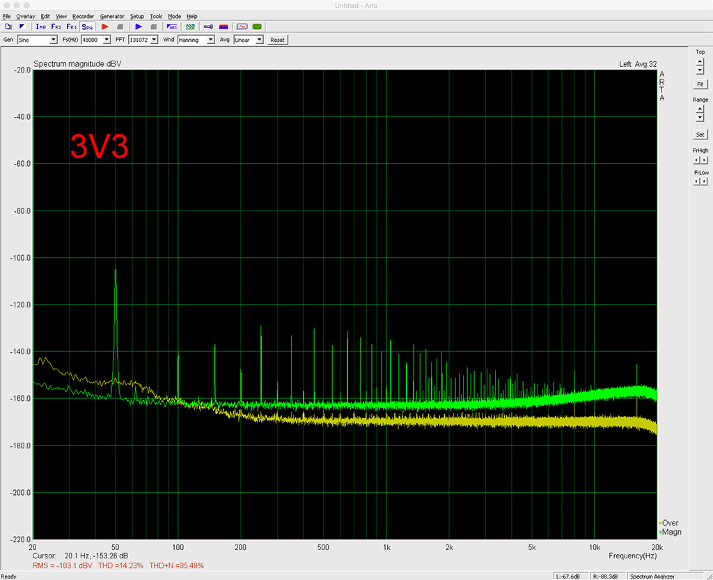

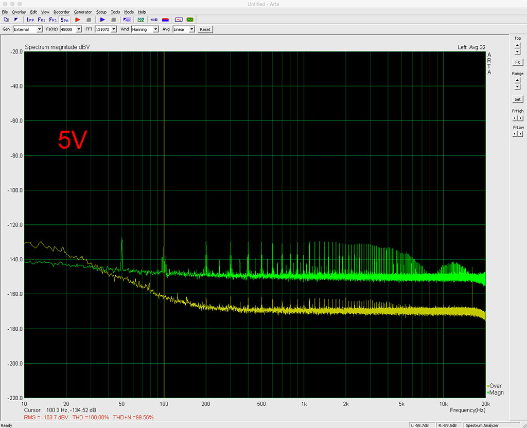

BTW what would be the cause of the 50Hz spike in the spectrum analysis? I thought rectification ripple was 2x mains frequency which in my case is 50Hz.
Yes, pretty sure. If the scale is somewhere near accurate, that'd be something like 10uV @ 50Hz, times 300 = 3mV output swing of the preamp.
If that's all you want to measure with it - ripple on the psu - you'll be fine.
NOMINAL INPUT LEVEL
Input jacks 1, 2 (XLR type) -60 to -6 dBu
Input jacks 1, 2 (1/4-inch TRS phone type) -50 to +4 dBu
Should be ok at the input sensitivity was calibrated in ARTA against a known output voltage with the input sensitivity set at the level then used for measurement.
Hook up your preamp, fire up ARTA (without averaging and a smaller FFT value for a higher refresh rate), and then watch the spectrum as you move a plugged in mains cord along your preamp. Then try to arrange and route all your cables and stuff on the bench for the lowest possible noise...
50Hz, 150Hz, 250Hz, 350Hz etc.
Ok you are suggesting it is likely EMI. I will do as you suggest. (I had actually watched that video quite some time ago.)

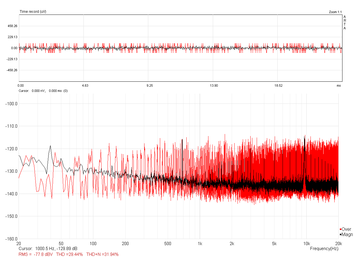

16 averages at 128k take almost a minute. Raising Fs increases the bandwidth, but noise floor, too. Maybe there's something 'wrong' with the mac sound interface. When I use Windows Multimedia Driver WDM I get worse results (and a much worse noise floor) than with using ASIO, since one works with 16Bit only and the other with 24Bit.
Edit: 16Bit WDM (red) vs. 24Bit ASIO (black)

At 48kHz, 131072 for FFT I do 32 averages in 1 minute 30 seconds. Raising the frequency to 192kHz it takes 23 seconds but, yes, a slightly higher noise floor.
WDM isn't a direct path to the sound card. ASIO is.

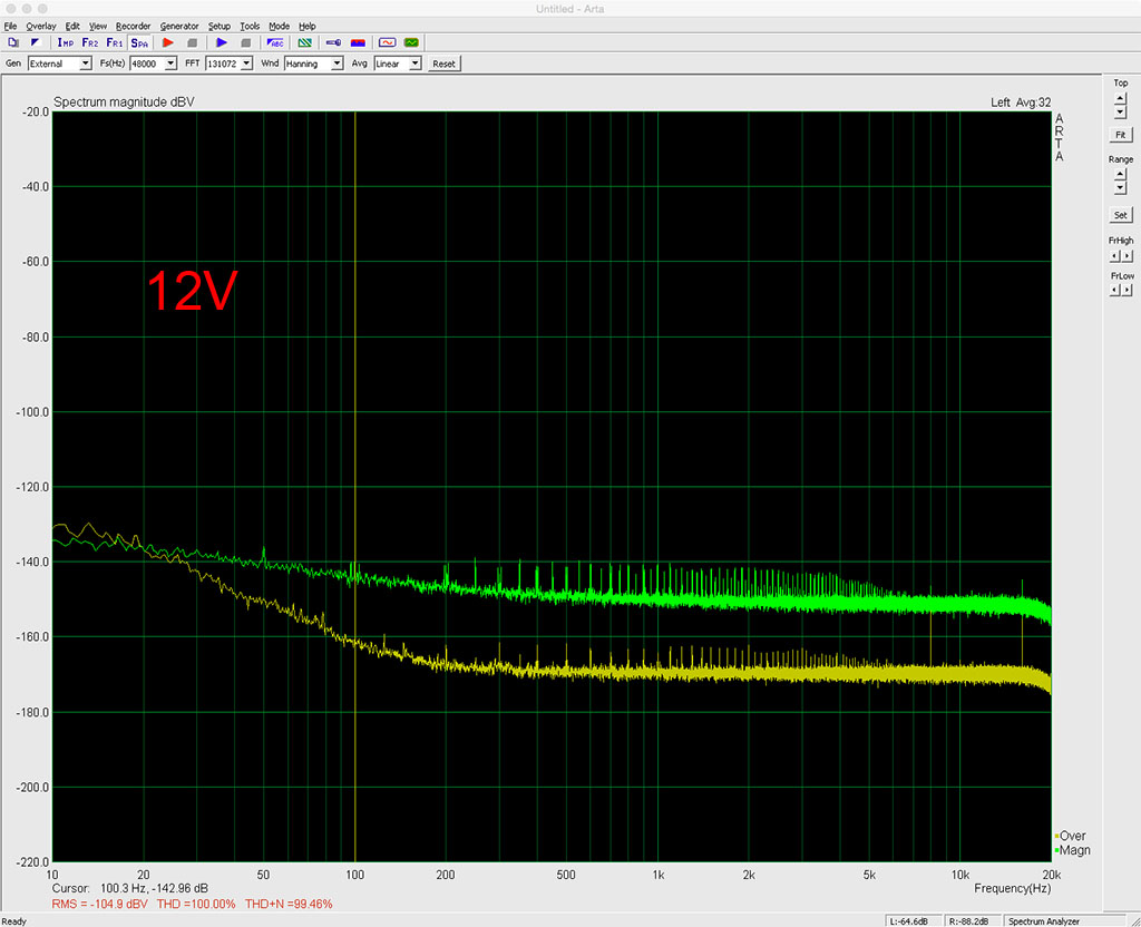

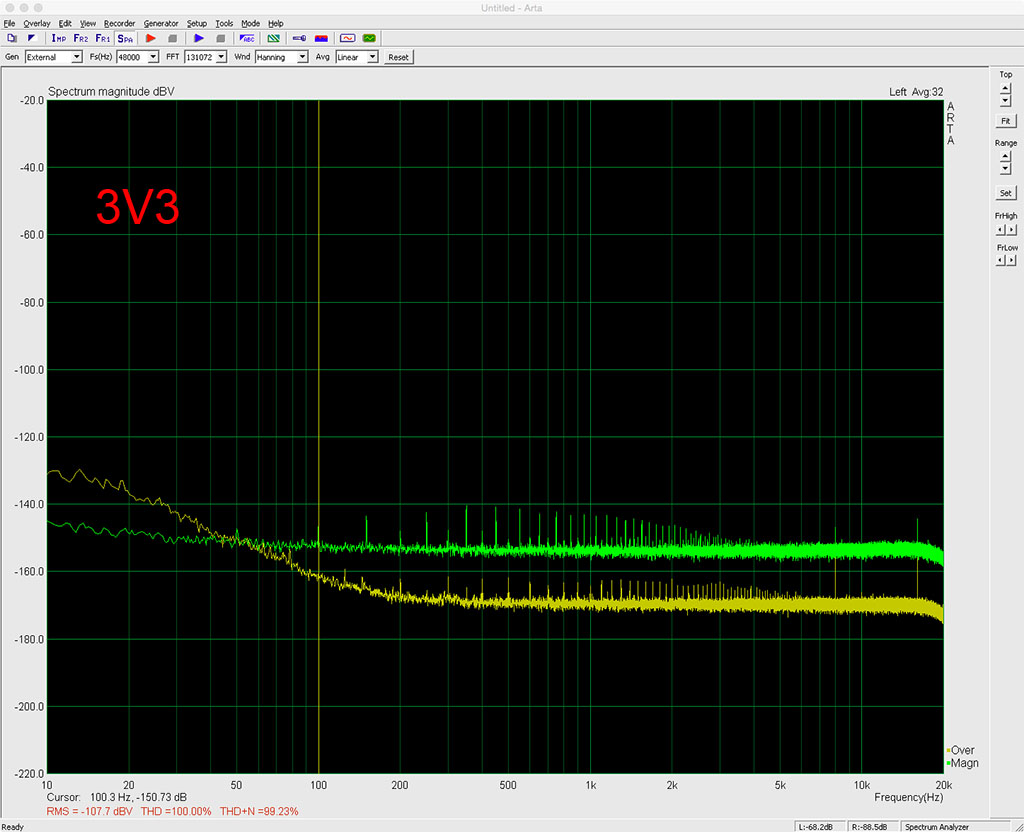

FWIW here are the three voltage supplies using 48kHz, "128k" and Hanning (32 linear average).
One thing in particular is puzzling me: the 50Hz spike appears only on the voltage rail measurements and not when the pre-amp input is grounded. Yet all three voltages are transported to the pre-amp board and 'on' during measurements (just not connected to the pre-amp input) and the pre-amp is powered by and its Vref is provided by the 5V supply rail. If the 50Hz spike is EMI-related then I am surprised it's not also on the noise floor (grounded input to pre-amp). (I'm also a bit surprised that the noise level below 100Hz for a supply rail can be below the pre-amp grounded-input noise floor.)
I suppose that's all right. What does the noise floor look like with the preamp input connected to one rail, but no mains input to the psu? If I'm not mistaken, you'd have to power the preamp with another 5V supply to test this out...
That's strange indeed. I have no clue.

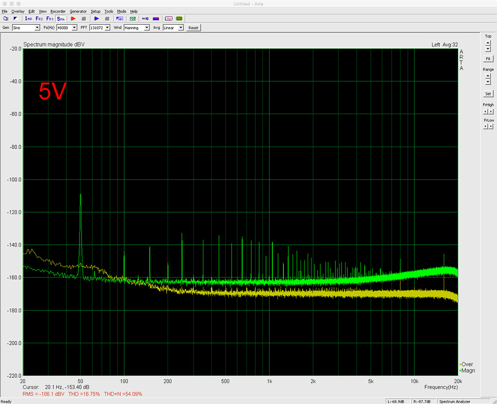

Ugh...Ignore the plots in post 314; they're complete rubbish. (I forgot to ground the PSON pin of the TPS3510 to allow voltage to flow through the pass transistors.) It's a wonder they're not identical though...
Revised attached. Still with no output load on the supply rails other than the pre-amp/control board (and leakage etc). Interesting that the 5V is the worst and has that larger 50Hz spike. It powers and biases the pre-amp and supplies the TPS3510 circuit.
I ordered a Juli@ xTE card which should have a better baseline THD+N.
BTW, push the resistor values down too far and it seems one risks gain peaking. See attached .asc. I will take them down to the values marked in blue on the LTspice file and leave them there. I may as well round the total gain to 50dB while I am at it.
Looks minimal in your sim. I put a couple dozen picofarads in parallel with the upper resistor to counter that. Of course you can't go lower than a certain point; 100R and 1R seems to be much too low for the LT1028.
