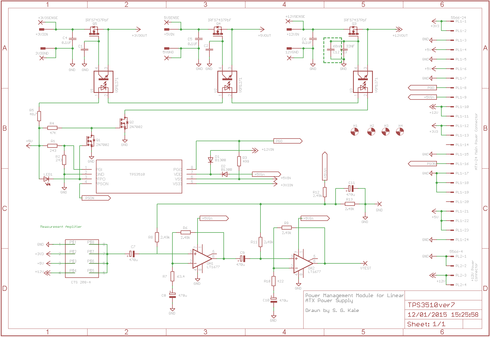

SGK,
Remove C1, C2, C3.
Paul
I took another look at the calculations for these and it would indeed seem possible to remove them. The guided to capacitive loads that need to be handled are 8,000uF for 12V and 6,000uF for the 5V and 3V3 respectively. The SOA of the IRFS7437pbF is:
If we use Mark's calculations from post 95 but with these capacitive loads and a more conservative 10msec ramp up, even the 12V rail would seem to be okay - assuming I have done things correctly. Inrush = 0.008 x 12 / 0.01 = 9.6A. This is well inside the 10msec SOA curve. (A longer ramp up would mean less current rush.) If I have made a mistake in judgement here hopefully Mark will challenge my thinking! He might say something like "for the sake of one little capacitor would it not make sense to protect the pass transistor at a level well above the desired operating spec of 5A yet comfortably below the SOA limit" but then one is back trying to estimate the current provided by the VOM1271 to charge the cap from Mosfet gate to ground.
I suggest you read post #27 again. It said,... but then one is back trying to estimate the current provided by the VOM1271 to charge the cap from Mosfet gate to ground.

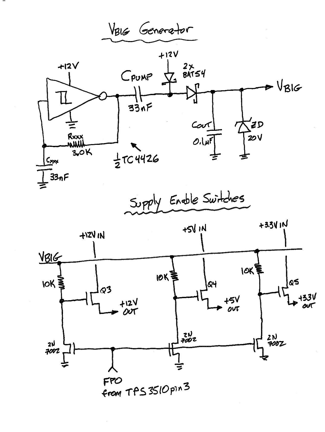

If you discard photovoltaic optoisolators, and if you confine yourself to BJTs, JFETs, MOSFETs, resistors, capacitors, diodes, ICs, and inductors, these are native elements in LTSPICE. Which means that you can try out your circuit design in simulation and see, with your own eyes, exactly how well it performs. If adequate, rejoice. If not adequate, redesign and resimulate.
One way to do this is shown below.
It discards ten of your circuit elements (U1, U2, U3, C1, C2, C3, R5, R6, Q1, Q2) and replaces them with fourteen new circuit elements (3xNMOS, 4xResistor, 3xCapacitor, 3xDiode, 1xIntegratedCircuit).
The circuit can be simulated and indeed I simulated it myself, this morning, between coffee and shower. (LTSPICE simulation .asc files attached).
It is powered from the +12V input supply and consumes 250 milliwatts.
Please note that the Schottky diodes and the NMOSFETs are available as "duals" with 2-in-a-package.

Mark, as much as I'd like to start again I think that's a bit too much work for what would appear an unlikely problem. The data sheet for the VOM1271 provides good guidance for typical short circuit current for a given IF; only component tolerances make this imprecise and if I have done my calculations correctly I have a reasonable amount of headroom to play with. It would appear easy to conclude there's no issue with the 3.3V and 5V (although I will leave room for caps on the board; why not). Now the 12V...
I set myself an arbitrary spec of 5A capability. A very rough interpolation of the IRFS7437 SOA chart suggests it can sustain at least 10A for 10msec. The ATX Power Supply Design Guide sets guidance for capacitive load of 8,000uF for 12V power rail. (There may be some headroom there as well.) On the basis of:
Imax = Cload x Ipu / Cgate
where Ipu is the current charging the gate capacitance of the pass transistor, ignored, and Cgate (Cgate connected from gate to ground)
and IF = 20mA => Isc = 30uA (from VOM data sheet)
(just to use something closer to the mid-point of the VOM1271 current capability)
then Cgate = 33nF slots things roughly down the middle of the current range above.
If, for whatever reason, Isc is closer to 20uA then Imax will be closer to 4.8A. If for any reason, Isc is closer to 40uA then Imax will be closer to 9.7A. If all other things are typical except Vf for the VOM LED, then Isc 40uA => IF = approx 26mA (interpolating the info on the VOM data sheet) which means all 3 of the VOM need to be at around Vf of 1.33V versus their typical 1.4V+ (Fig 7 VOM1271 data sheet; 25C). Now maybe that boils down to very little room for manoeuvre across three VOMs and maybe I get unlucky. If I blow a pass transistor I will replace it and double Cgate.
So that leaves determining the value of R6. Using a basic diode model to simulate three diode drops of 1.42V each suggests 34.8 Ohms would be good for R6.
If I am making a fatal error in judgement/calculation please let me know.

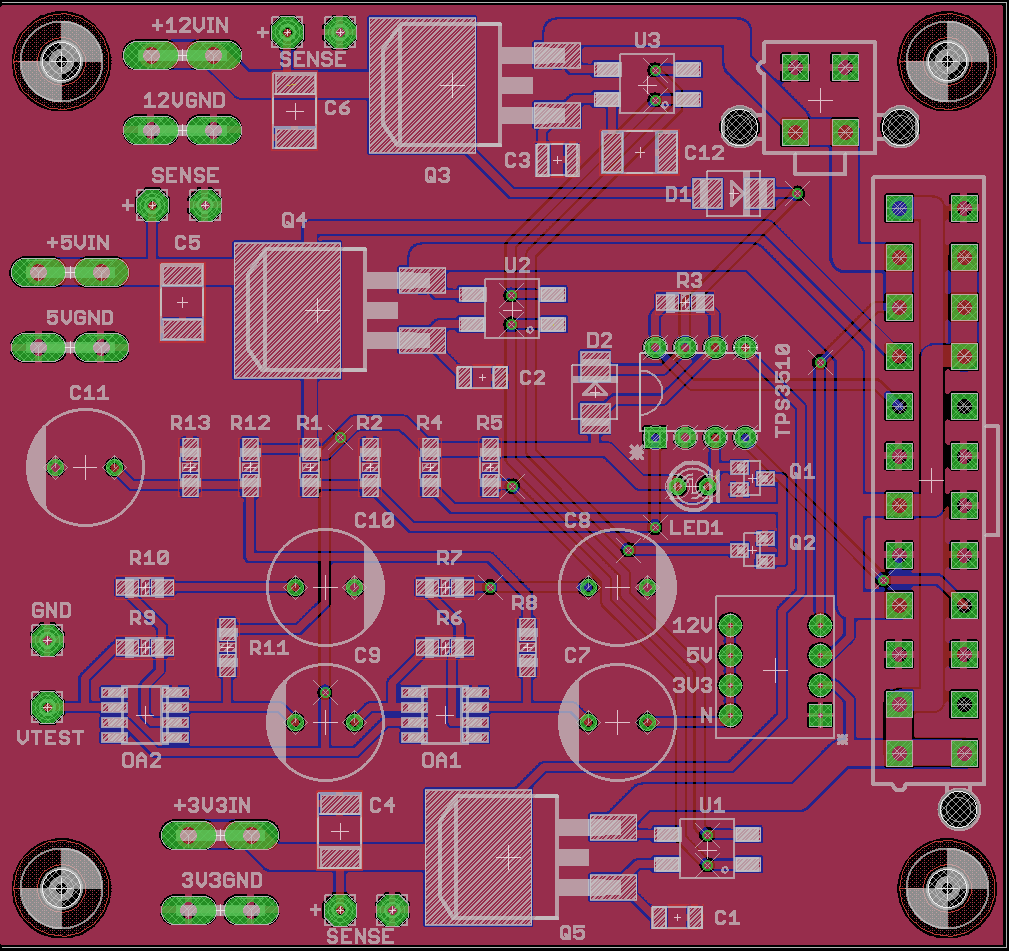

Hopefully almost there. Schematic, board and BoM attached. Any comments/suggestions welcomed.
(I'm getting nervous ahead of sending it to the board house and ordering parts from Mouser. )

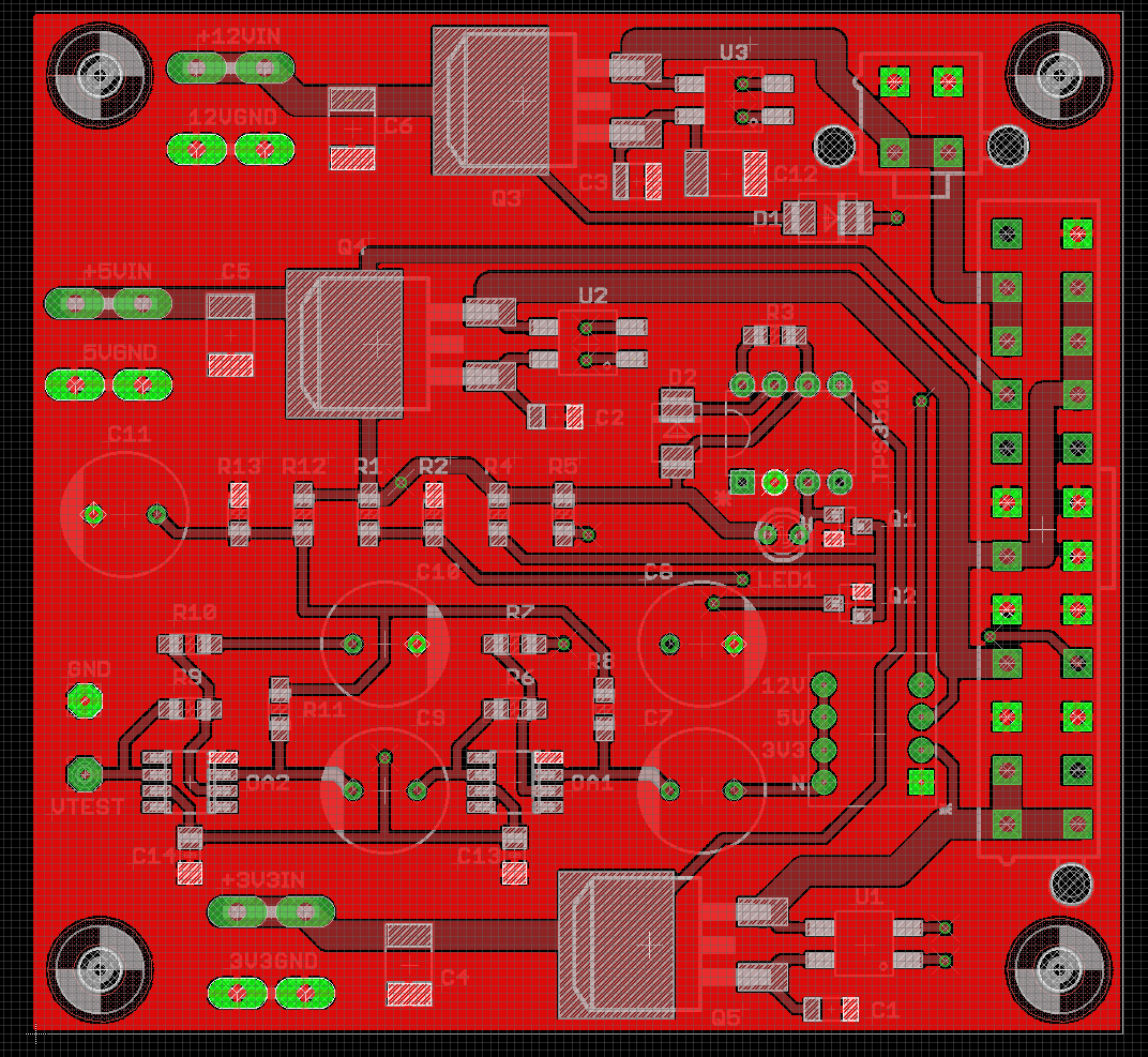

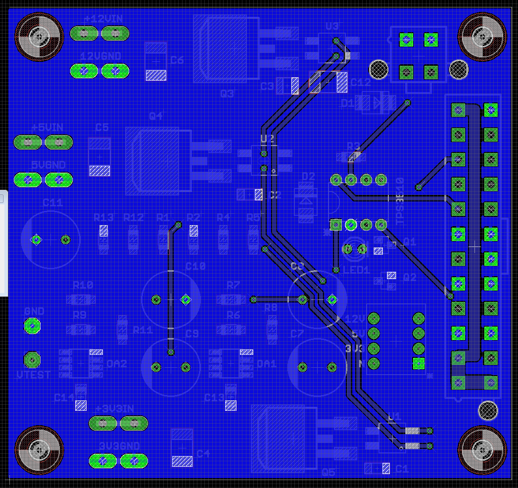

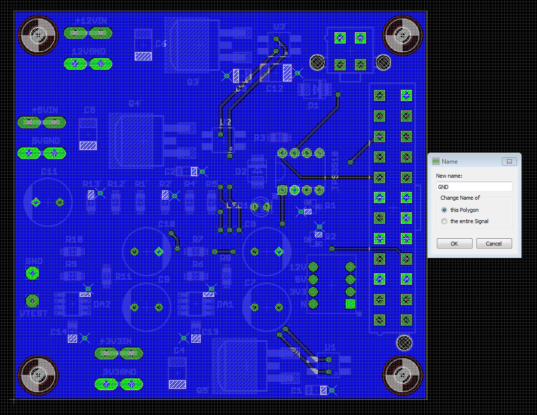

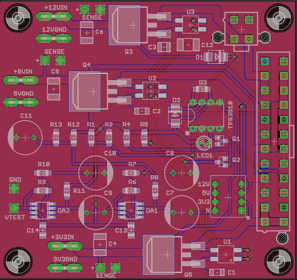

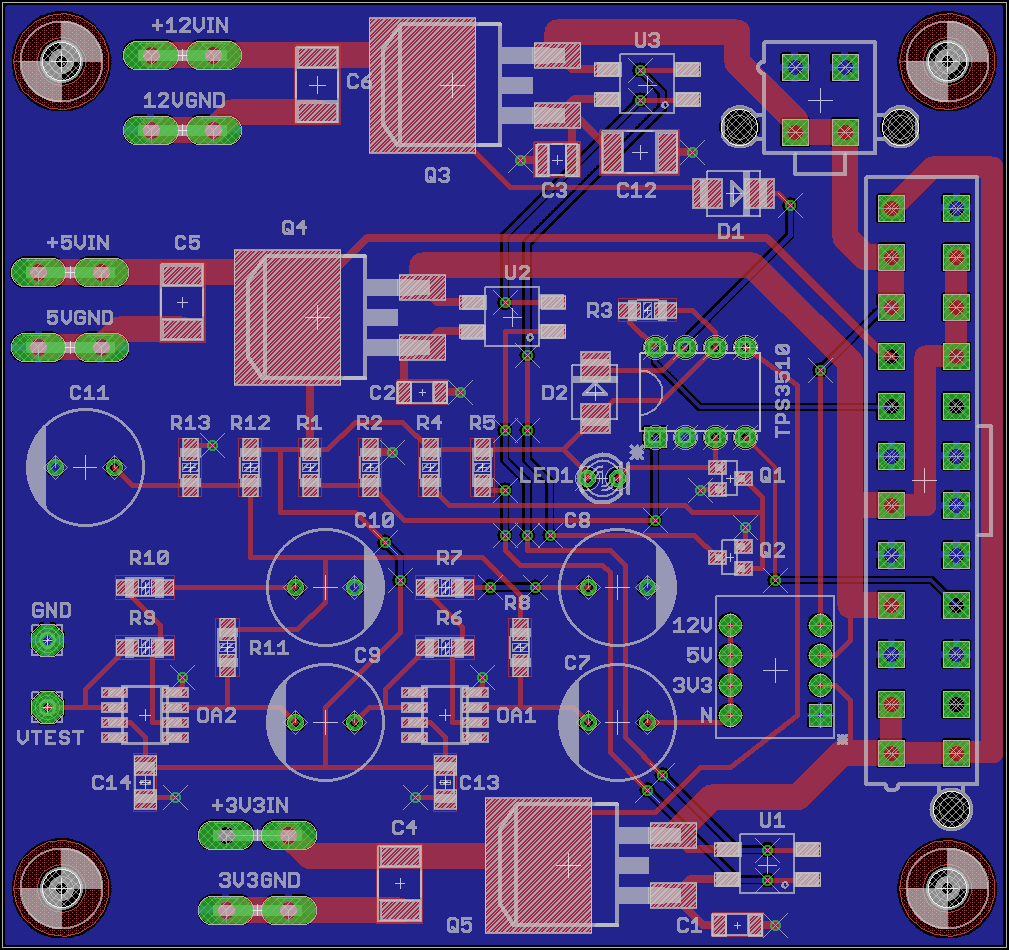

Ground 'planes' and copper pours.
The discussion of this topic in my PSU thread made me revisit this subject in relation to this board. My presumption is that while there aren't rectification pulse currents to deal with, the subject of a good/decent ground scheme remains important.
The attached two images attempt to show the bottom (blue) and top (red) ground 'planes' I have deployed until now. In each case the GND pour is highlighted as are the pads or pins connecting to GND (either blue or red and lime green respectively).
Peufeu would likely suggest the top pour is pointless given how dissected it is. Even the bottom layer is heavily dissected by the bottom layer traces.
I presume the board would benefit from, at a minimum, some vias connecting top and bottom pours near the ground connections of the SMD parts. Perhaps some jumpers would be required to cross the 'railway tracks' on the bottom layer. Other enhancements may well take a decent amount of rework.
Before I embark on this I wanted to check if I am barking up the wrong tree and ask if there were other considerations I should take into account.
Regards
Steve
Regards
Steve

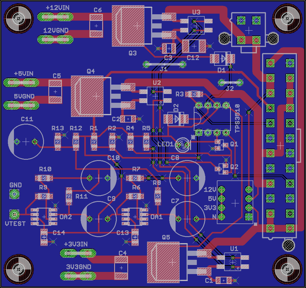

Thanks. I did my best to improve things without jumpers but your top two suggestions are still likely recommended. I removed the top pour, grounded SMD parts directly to the bottom layer with vias or connections to large nearby through-hole components. I also did a bit of rerouting and reduced the width of low-current connections to 16 mil. (Still exccessive but I don't have the confidence to route between the pads of a 1206 resistor and so thinner ones are of little benefit that I can see.)
Any guidance as to wire to use for the jumpers and is there a convention with respect to how to mark the board for such?
Most people just use off-cuts from trimming the leads of diodes, resistors, and capacitors. #22AWG or thereabouts.
A jumper is a two terminal component ("schematic symbol"). Designers happen to use them such that the two terminals often get wired to the same node. Footprint is usually just a straight line on top silkscreen with Jnnn for a part designator. If you've got jumpers of length 0.4", 0.7", and 0.8" you might make three footprints, one for each length.
Sometimes I tell the schematic it's a 1/4 watt thru hole resistor and use that footprint, if the lead spacing is okay and the width doesn't interfere with other topside components. Now I can use automatic board stuffing machines and reels of "Zerohm" resistors.
Ok that was rather obvious in hindsight - standard parts in Eagle. J1 and J2 added. The jumpers have 0.81mm drill holes and 1.6mm wide octagonal pads and I think I have some 0.6mm solid core hook up wire.
Hopefully now I just need to generate and edit the silk screen and then send it off.
