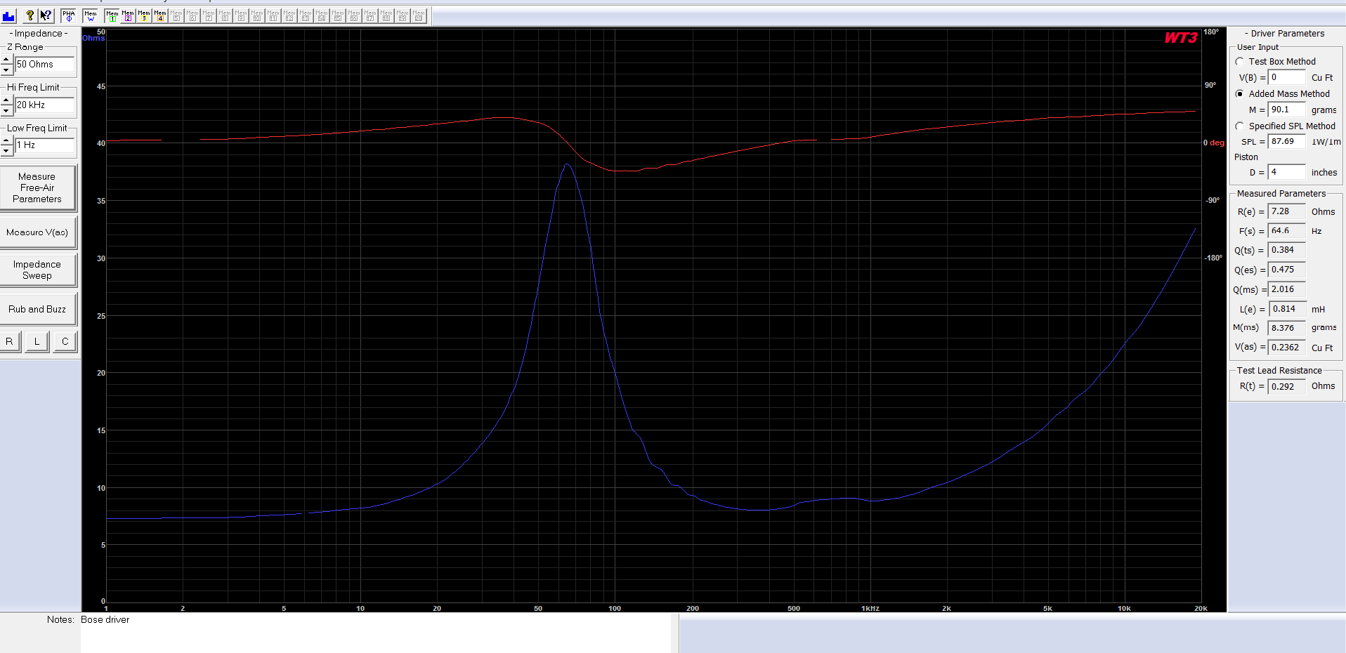

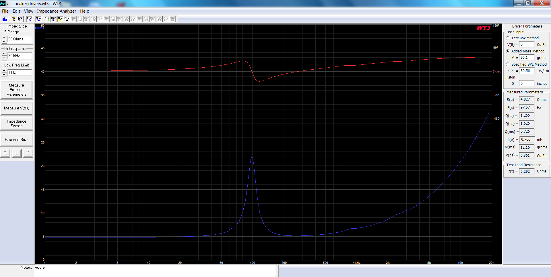

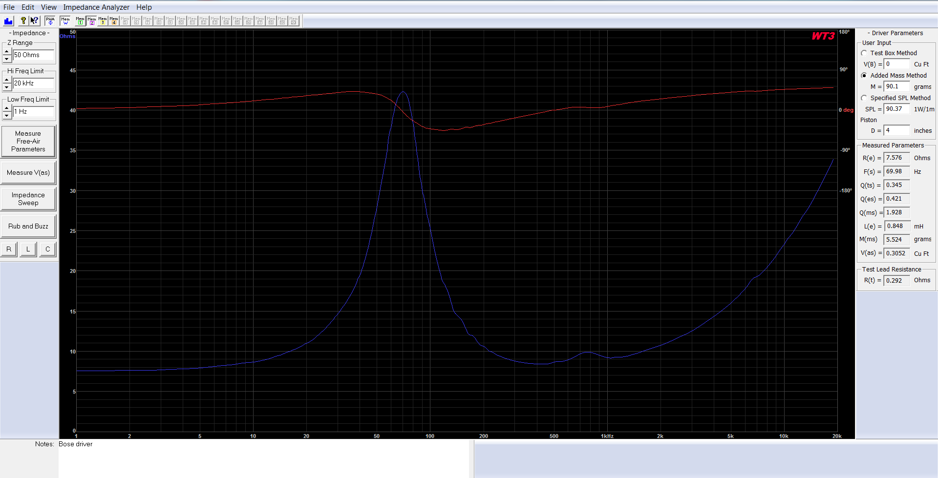

Okay I have decided to go the hard way. I purchased the woofer tester to get the parameters. They are attached, 1&2 are the Bose 4 inch drivers, 3&4 are the 6" woofers.
I will have to purchase a set of tweeters. I would like to do a passive crossover. I have the loudspeaker cookbook, but I am overwhelm with information but I am still working through it. If you have another book you can recommend please point me to it.

Hmm, the 6” has too high an Fs, Qts to do much in the way of bass, only a booming mid-bass if not in a huge, heavily stuffed sealed cab, like ~348 L to get the Qtc down to near 1.0, otherwise about a ~1.2 Qtc in ~16 L heavily stuffed. Just lightly lined will need around 64 L; though someone more experienced with digitally altering [LRT] sealed alignments might can do better in a same size or smaller cab.
The 4” wide BW drivers can be OB, ~aperiodic TL or sealed, whichever you prefer. The TL can be used to damp the driver’s Fs peak, making it easier to design a passive XO for the handoff to the 6”. Not familiar with the LDC’s XO design section, but you may can even get away with a textbook one that on-line calculators and the formulas in most books I’ve seen generate.
I recommend you instead use WinISD Pro, Unibox or similar freeware.
A challenging project for a newbie, especially if the driver’s responses are as non flat as Freddy posted.

the smaller ones are decent and would work great in a rear loaded or even compound loaded horn, or an open baffel, possibly a transmission line. A sealed enclosure is tantimount to throwing away 2/3s of your drivers potential so unless you neeeed a really small speaker don't even consider them. Unless the full rangers were originally augmented with a tweeter they don't need one. If they are weak on the top end cross the tweeter over as high as possible with a high quality poly cap ($3) anyone who tells you differently is trying to impress you with their math skills.
I digress, slightly. The 6"ers are pretty low mass so they could sound good as a midrange driver, if you needed one, but you don't. As a subwoofer, or even a woofer they have far too weak a magnet to produce clean bass in anything short of an enormous horn, and that would be far more cost prohibitive than a better woofer.

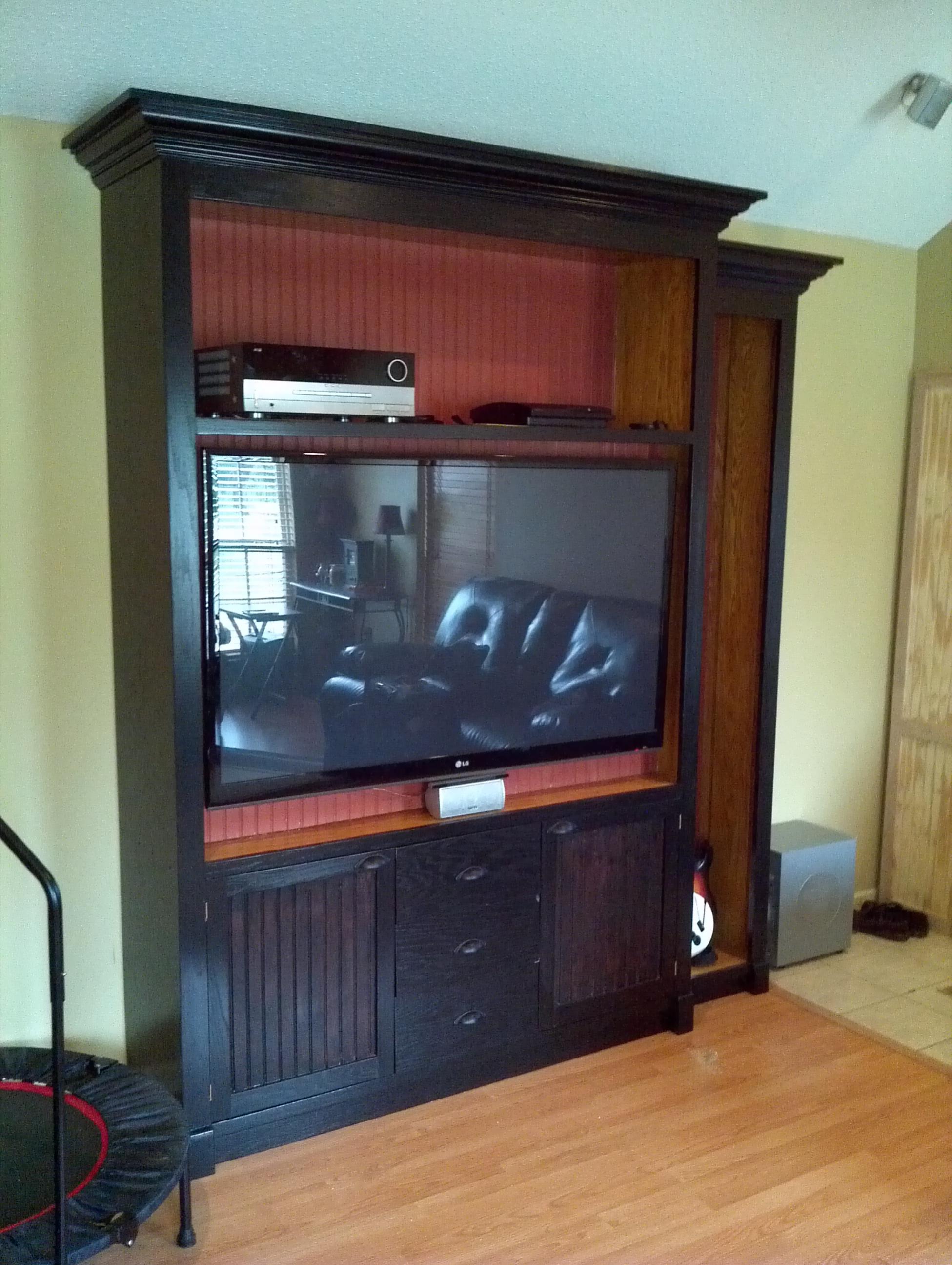

I am okay with woodworking I built this below and still working on the other pieces.
