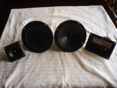

looks like this speaker is going to be a 3 way. I am still wondering what is the deal with these woofers at 5 ohms? if i can get them to work with out a plate amp. thanks alot for the help so far. attached is the pictures of the woofers. this was a DCM center channel speaker with 1 tweeter. let me know your thoughts and once again thank you for the feedback.

Could this be the eq I need to make my drivers full range?

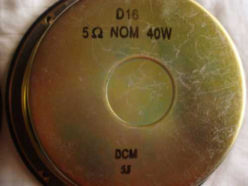

Hmmm... that 5 ohm woofer is odd. I bet it was an OEM unit designed to work with a particular system in mind. No big deal really as you would just adjust the crossover component values accordingly. Using the plate amp will give you a couple of advantages however.
1. It is really easy to adjust crossover frequency and output levels to balance the system just the way you want it.
2. Components for a passive crossover start getting really big when you start getting below 500Hz crossover.

ummm... in practical terms, no the Bose equalizer will not work for you.
Yes, it will make the speaker "full range" but you will have no headroom using only one driver per channel. That means not enough SPL available.
Regardless of what drivers you may already have in hand, and depending on your budget there are likely ways to go that will give you more certain results. I think you may be looking for more certainty?
Otoh, if you want to experiment, there is no harm in going forward - BUT for the cost of the Bose EQ you can likely buy enough of those Aura drivers from Parts Express to make a speaker that does not need that sort of EQ (very little, if any is what I mean).
Or you can buy a kit from Parts Express, or other sources, or just the drivers and make ur own cabinets to save a few $$...
That's how it looks from here...

The last pic he showed was of the 6.5" woofers from a center channel he wants to use for bass. Let's hope he has the 18 Bose drivers so the answer to his question about the EQ is yes.
