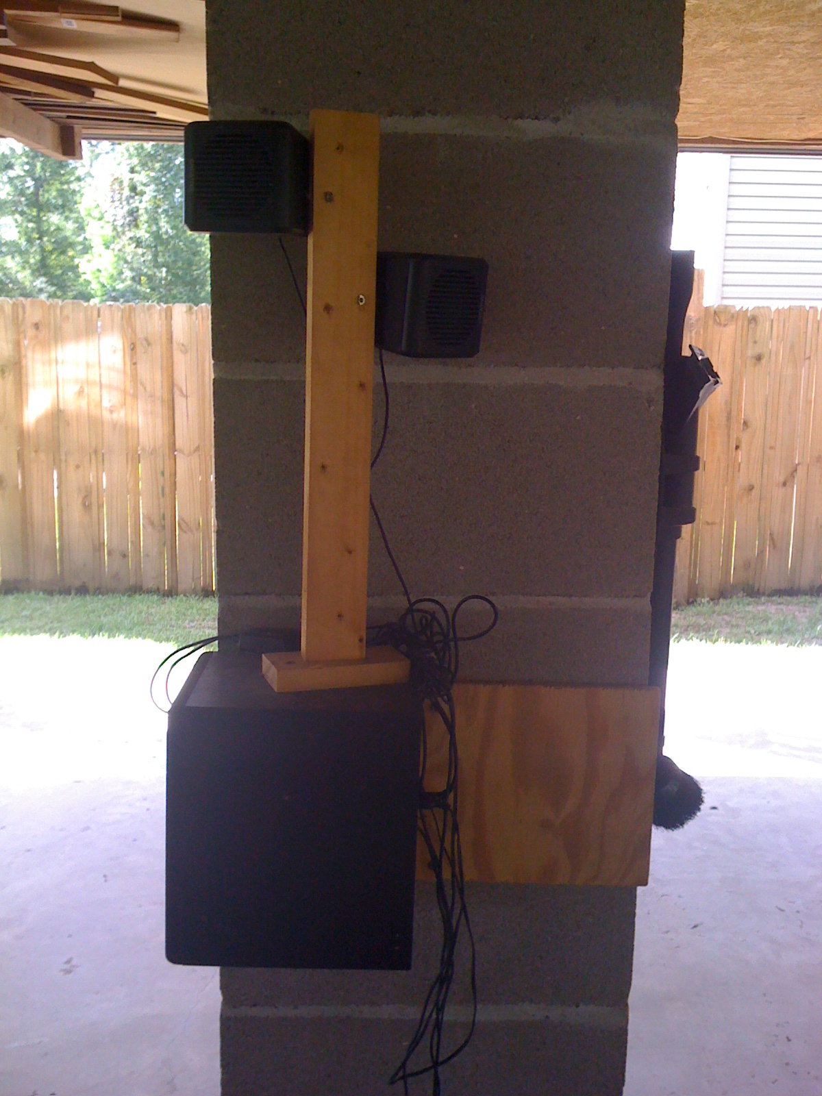

I've been putzing around with my garage speakers all summer--the massive heat wave with 100 to 112F (38 to 45C) is not helping...add a few degrees for being in a garage.
Should everyone build line arrays for their garage? They do have a BIG sound because they are BIG! Not too bad 6 ft. 2 inches tall (188 cm) 13 inches wide (33 cm) and 7 inches (18 cm) deep and weigh 75 pounds (34 KG). Although the twelve 5" woofers mate to forty-eight 10mm dome tweeters which helps the highs tremendously, they do NEED additional EQ though...

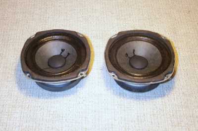

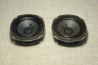

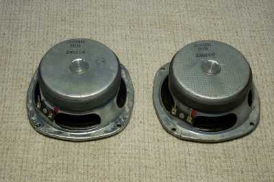

Okay I have decided to go the hard way. I purchased the woofer tester to get the parameters. They are attached, 1&2 are the Bose 4 inch drivers, 3&4 are the 6" woofers.

Hmm, the 6” has too high an Fs, Qts to do much in the way of bass, only a booming mid-bass if not in a huge, heavily stuffed sealed cab, like ~348 L to get the Qtc down to near 1.0, otherwise about a ~1.2 Qtc in ~16 L heavily stuffed. Just lightly lined will need around 64 L; though someone more experienced with digitally altering [LRT] sealed alignments might can do better in a same size or smaller cab.
The 4” wide BW drivers can be OB, ~aperiodic TL or sealed, whichever you prefer. The TL can be used to damp the driver’s Fs peak, making it easier to design a passive XO for the handoff to the 6”. Not familiar with the LDC’s XO design section, but you may can even get away with a textbook one that on-line calculators and the formulas in most books I’ve seen generate.
I recommend you instead use WinISD Pro, Unibox or similar freeware.
A challenging project for a newbie, especially if the driver’s responses are as non flat as Freddy posted.
GM
"Hey I have these drivers what cab I build with them" is almost always the wrong approach for a beginner, unless they are fantastic drivers, and these, I'm sad to say, are not. Bose spends all their money on marketing not quality. Better drivers can be had for as little as $5 and building materials are never that cheap. The right way to do it is to say I'm looking for this kind of improvement in sound and this is my budget what do you recomend. When you do that the first thing you'll get is a bunch of people telling you you need 10X that much, ignore them. Listen to the advice you get and go with the designs you like, not the advice of the guy who seems really nice. Most importantly, have fun.
Sorry to break it to you but those six inchers are crap. Throw them away, the ones you get at Wal-Mart for $10 have a fighting chance of being better.
the smaller ones are decent and would work great in a rear loaded or even compound loaded horn, or an open baffel, possibly a transmission line. A sealed enclosure is tantimount to throwing away 2/3s of your drivers potential so unless you neeeed a really small speaker don't even consider them. Unless the full rangers were originally augmented with a tweeter they don't need one. If they are weak on the top end cross the tweeter over as high as possible with a high quality poly cap ($3) anyone who tells you differently is trying to impress you with their math skills.
I digress, slightly. The 6"ers are pretty low mass so they could sound good as a midrange driver, if you needed one, but you don't. As a subwoofer, or even a woofer they have far too weak a magnet to produce clean bass in anything short of an enormous horn, and that would be far more cost prohibitive than a better woofer.
