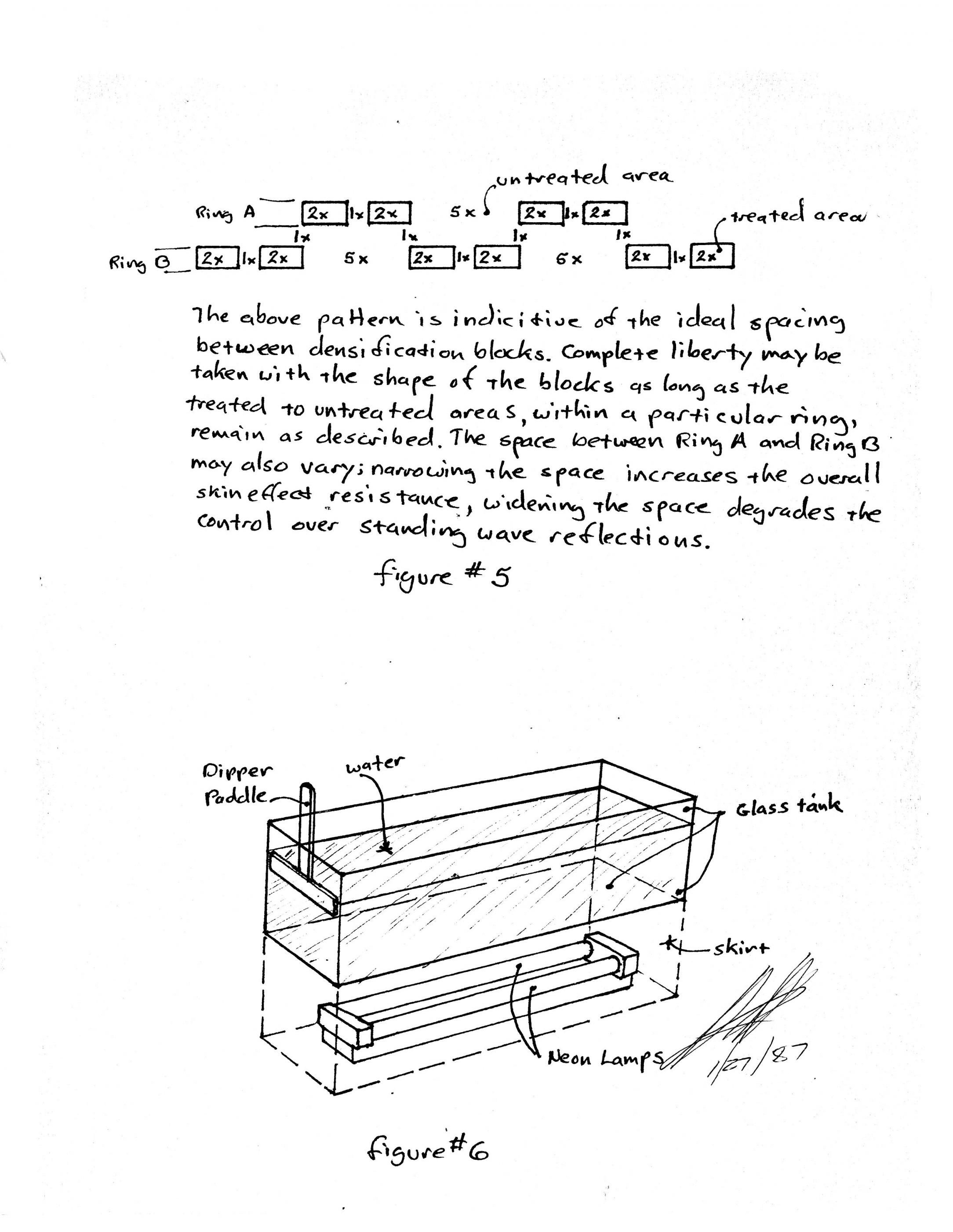

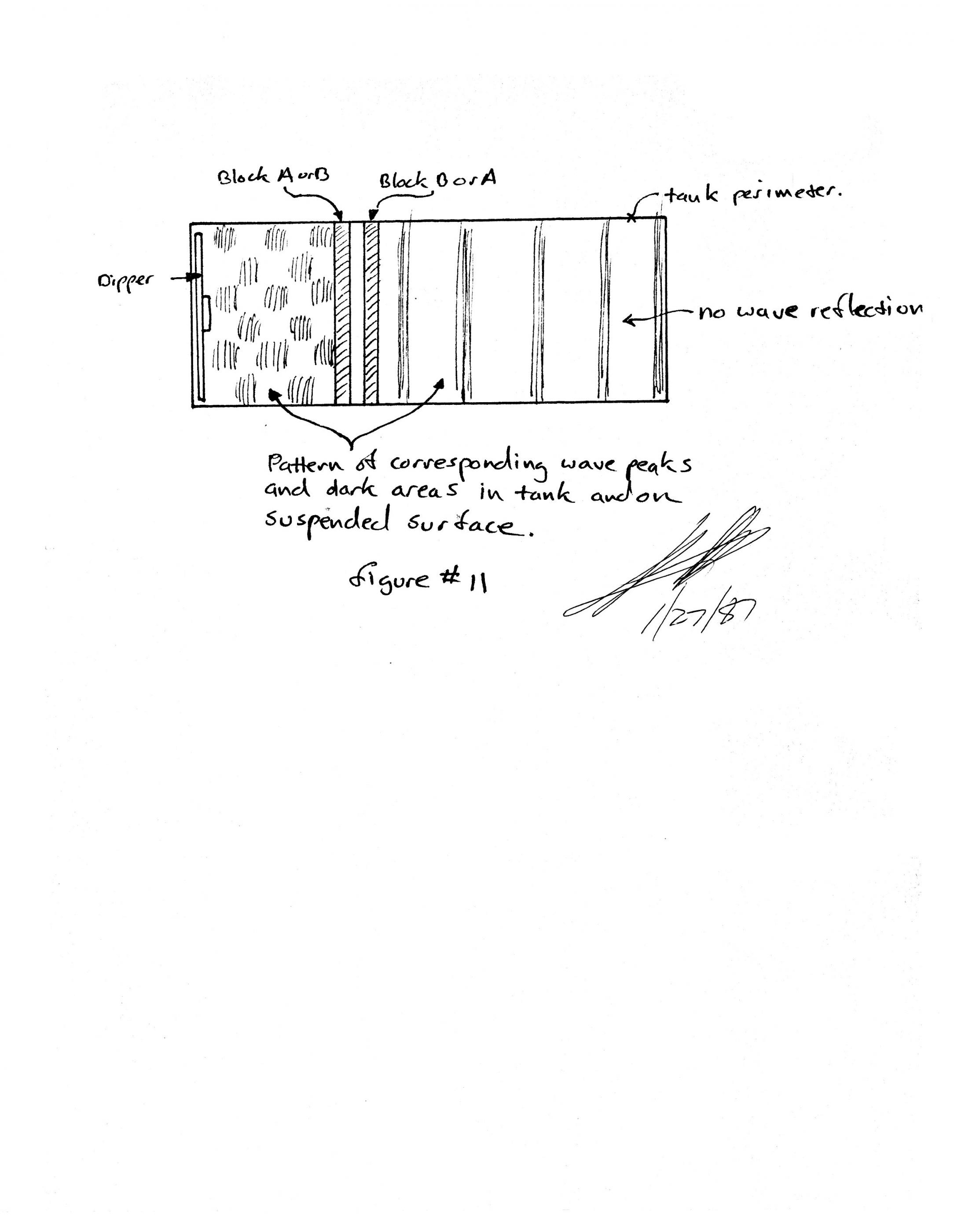

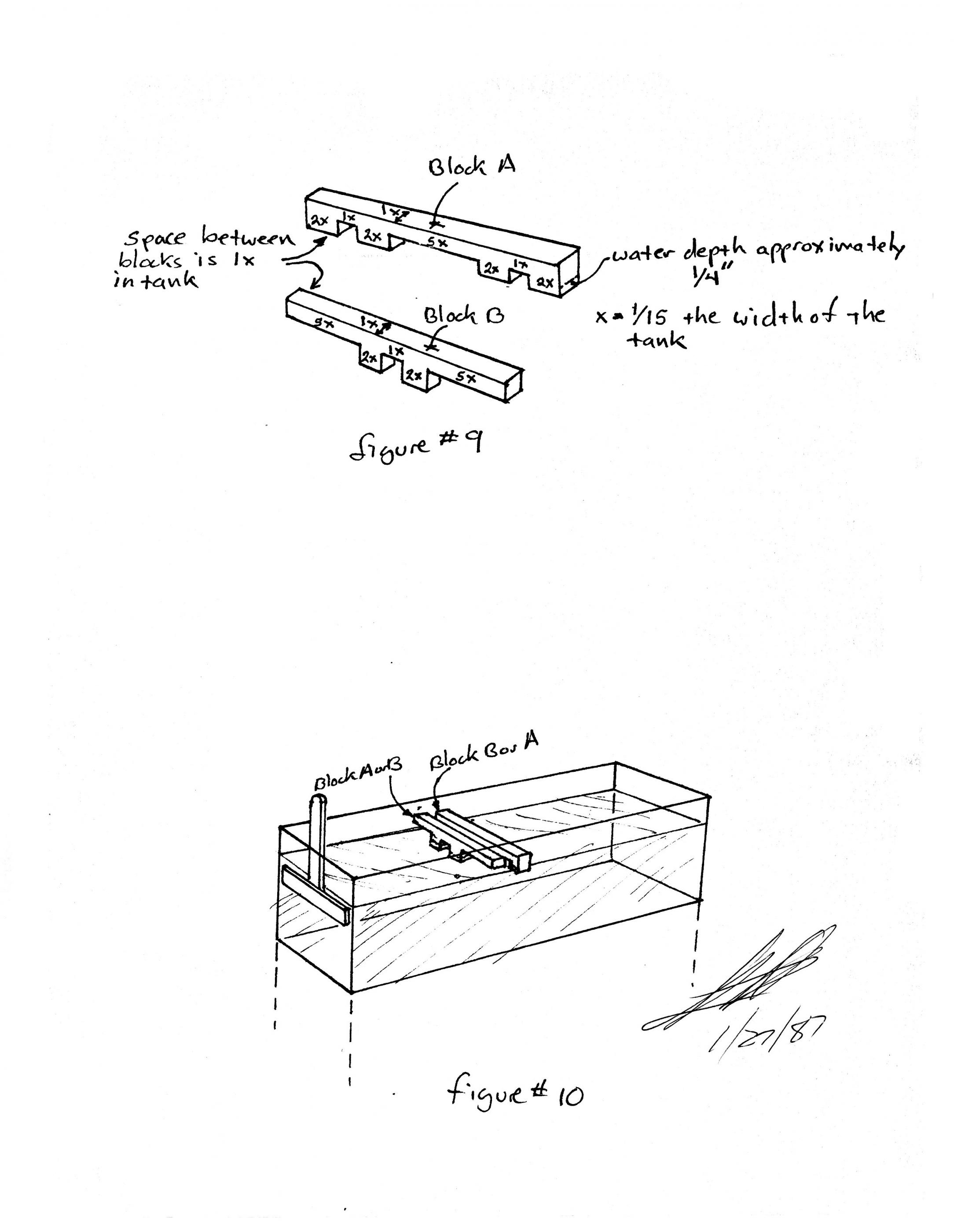

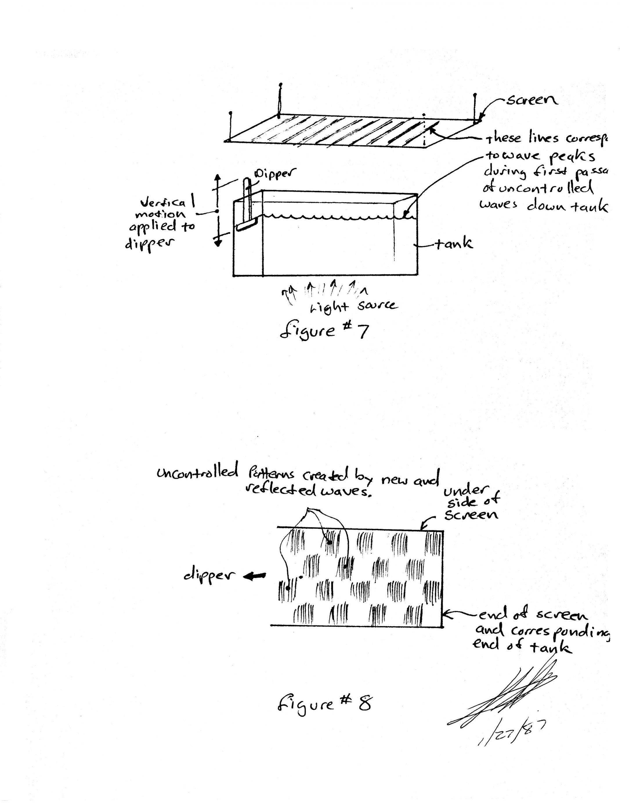

I have attached a water tank test I performed many decades ago, in the presence of a very smart EE who has passed, so we cannot argue with him. He did sign and date the original document as being representative of what he witnessed. The PDF is all of the same pages. The dated signature is from William Gregor, in Elmhurst IL, in my basement.
Bud

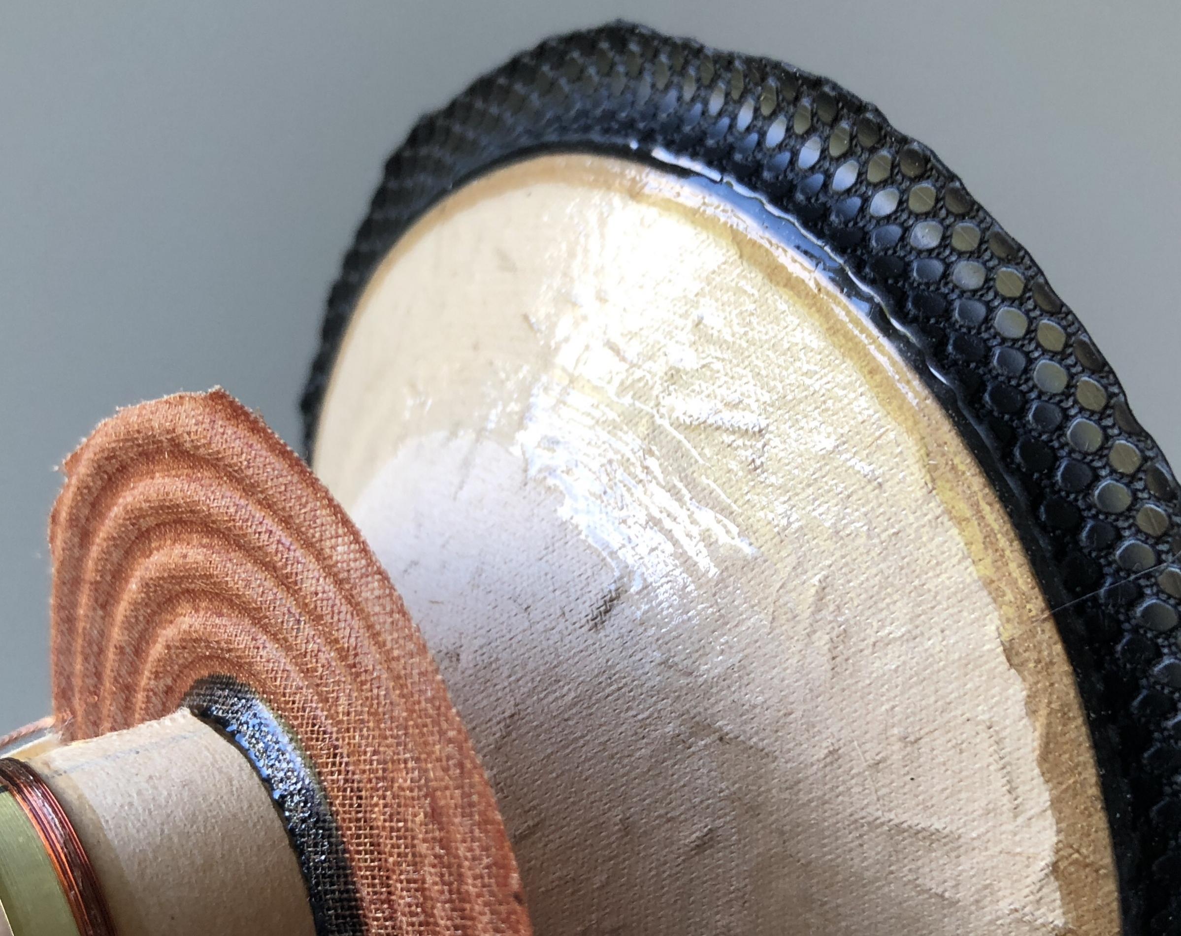

Step 0. When new, I had sent one of these DX4s back on warranty because of a rattle. The factory (supposedly) re-centered the voice coil (& cone) within the air gap - which is possible because the magnet bolts on to the basket assembly. But this particular driver was still more sensitive to being over-driven. With phase plug unscrewed, the voice coil still wasn't perfectly centered so I scrapped any remaining warranty, loosened the 4 bolts and realigned the voice coil by eye. You can flex the entire cone/coil sideways just by pushing gently on single points. The new alignment (by eye) can now produce contact between magnet and coil (due to cone deformation) using equal pressure anywhere around the cone. Before, only one side of the coil could be made to touch the magnet. ...all gentle and careful here, of course...

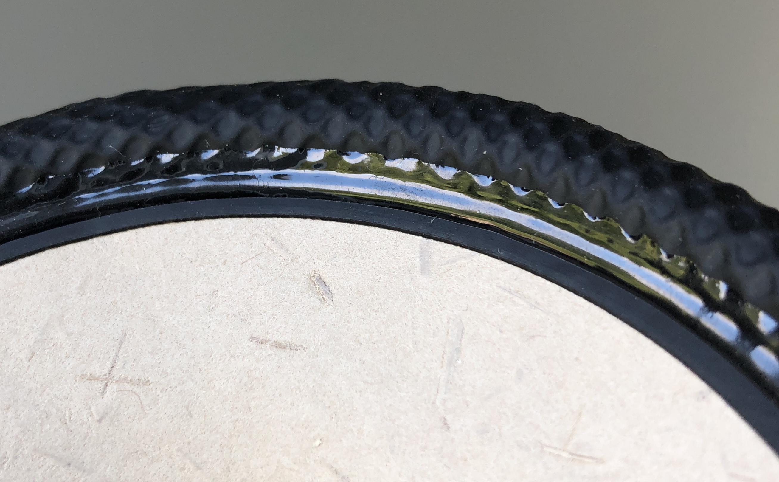

Step 1. More Zig! I added two more coats of Zig to the back of the cones. This time, 3.5 to 4 cm in width from the edge of the surround. I also reached as far towards the voice coil as possible and painted Zig about 1 cm wide on either side of the cone joint. Now there are 5 coats about 1.5 cm from the edge, and two coats on the rest of the accessible cone. Again, it doesn't soak in - it remains on the rear surface.

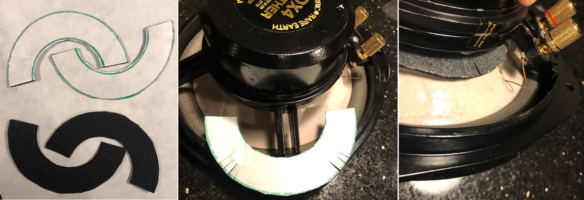

Step 2. This isn't EnABL, but it's a pretty obvious potential source of phase interference. The Lowther basket assembly has an iron mounting plate (to the magnet) between the cone and the spider. It's a big reflective surface right behind the (unusually flexible) cone! Reflections from that plate need to be damped. A new secret weapon for me is adhesive 1/8" felt (from Madisound), so I applied absorptive felt to the basket mounting plate and the basket arms. (photos below) The felt is very sticky and tough to manage so near to the rear side of the cones. IMO, this mod should be ranked "difficult" unless you have good blunt&long surgical forceps and TWO curved periosteal elevators. [I once needed the second elevator to help extract the first from sticky felt!] With these perfect tools the mod isn't too tough.
left - 1/8" felt easily cuts with scissors
center - edge slashes accommodate bolt heads underneath
right - adhesive side visible as the felt is carefully slid into place
note - basket arms also covered on side facing the cone - easy to do

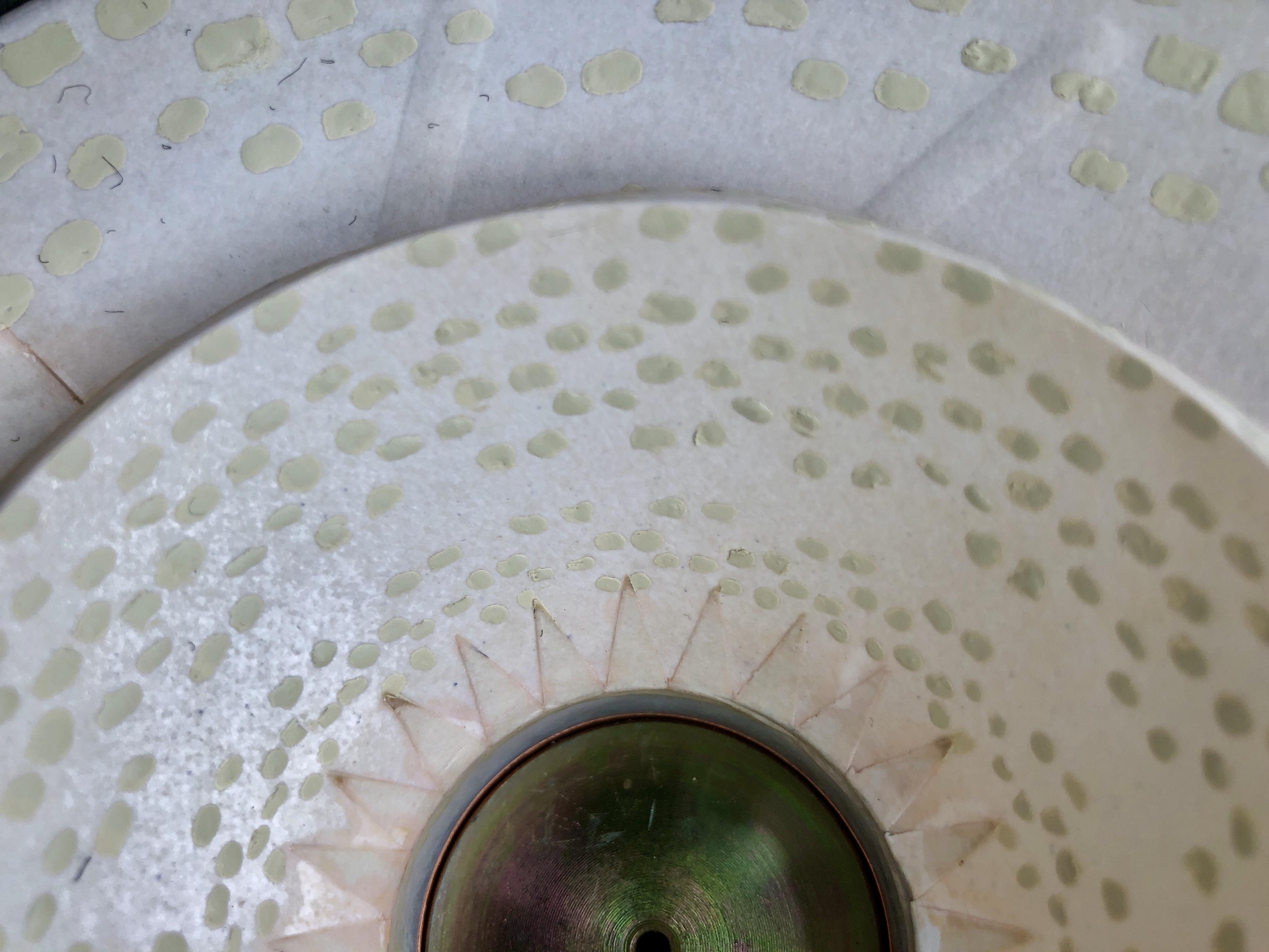

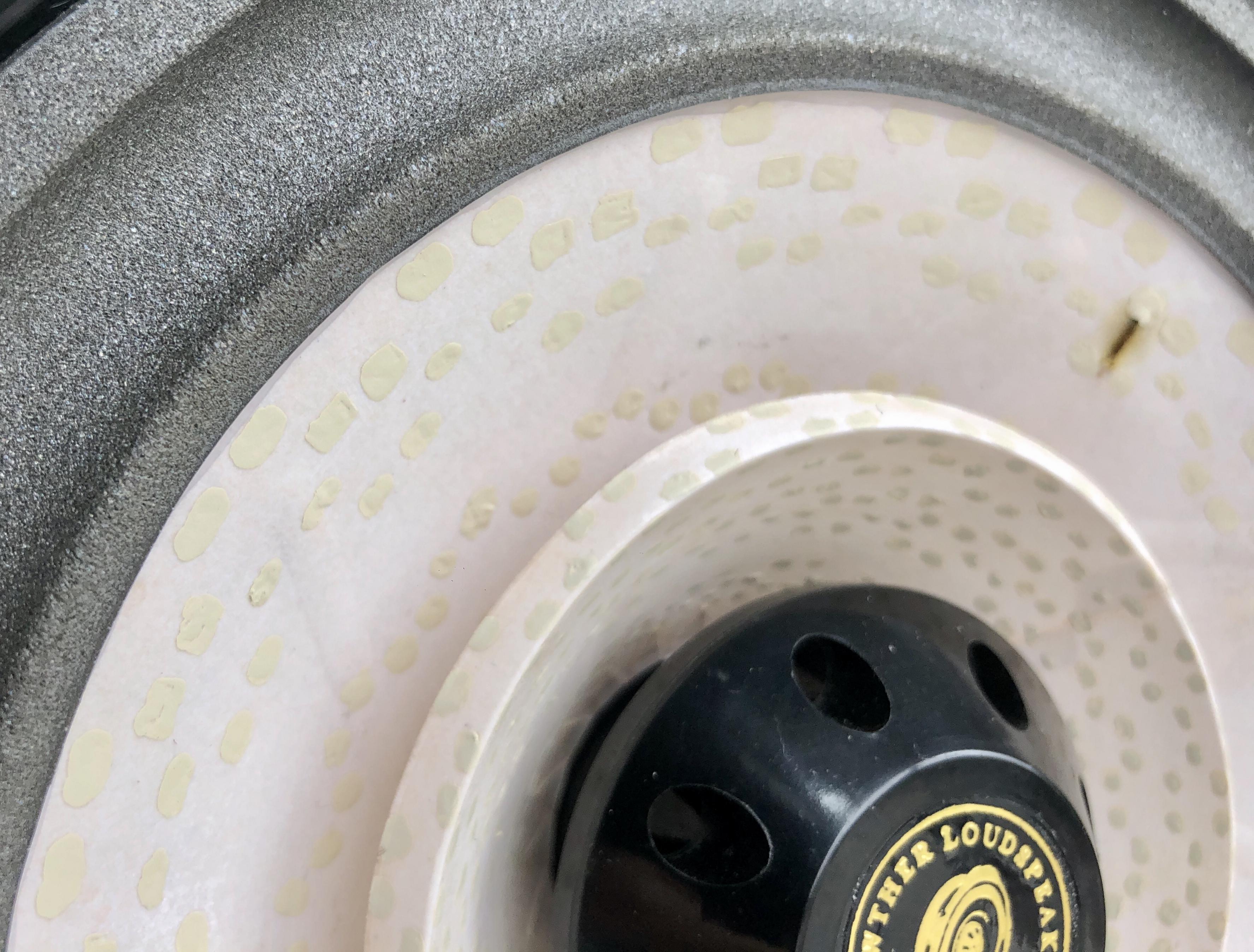

DX4 photos posted by request.
I don't worry so much about the shape of the paint dots any more, as long as the same amount of paint is in each one. With these flexible but sealed paper cones, I used heavy dots that are harder to shape into nice rectangles.
Whizzer: 5.5 circle patterns inside, full double row on the outside edge. Multiple coats of Zig on the back side, especially the back-side groove.
Main cone: 4 patterns, 2 as far under the whizzer as I could reach, 2 near the foam. Multiple coats of Zig on the back side - ~ 6 coats within 1.5cm of the surround, 3 coats over the remainder of the entire cone.
