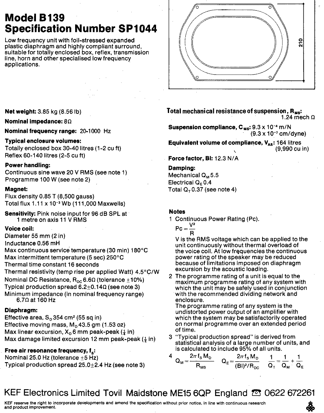

Isn't the B139 bass driver only rated at 30 Watts ??
Remember that these speakers came out in the days when 45 watts per channel from a Quad 303 was considered excessive

The datasheet says 100W program material....
Or 20V RMS / 8ohms = 50Watts.
Which is what I was originally saying about these speakers.
They can handle 100W peaks.
