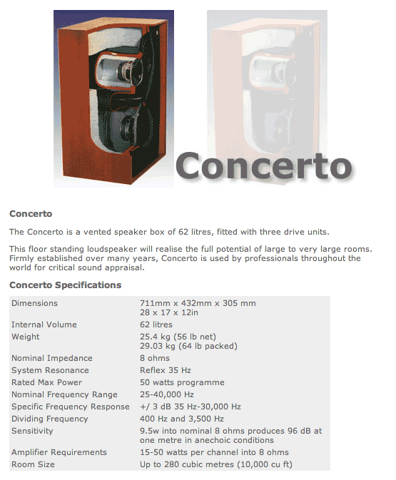

Been reading more on the ASKA amps here:
LIFEFORCE: Listening Impressions II
And thinking that they might be good
Still worried 100W is not enough.
Does anyone think that 100W is enough for Kef concerto?
I like to give them a good flogging.
100 W is twice the rated maximum power.
