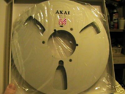

The 3 cuts,like an old reel to reel is a good option,but is not good to be that large.
Lower fs without reducing spl.
Is interesting how the Fertin make the "old school" technique to be so proper implemented.
