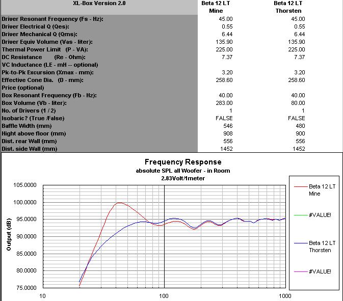

Does MJKs MathCAD sheets take into account room gain or positioning in the room, things like that? The graph you have shown for the response of that 10 ft^3 box, if I put it near the back wall and possibly a corner, I would then get a big hump in frequency response around the 40Hz area, right?
I have been fooling around in Thorsten Loeschs Xlbox work sheet which shows the boxes with their position from the back wall and side wall. With the 10 ft^3 box tuned to 40Hz, it has a big bump in bass compared to the box Thorsten has built for the Afterburner project which is much more flat looking in room. If I lower the tunning frequency to 30Hz, it reduces the peak close to flat, but then that is tuned pretty far below the 12lta's Fs.
What I posted are simple half space plots and MJK's fee WSs only plot up against a wall for now. I'd have to reload LspCad to do more elaborate sims, which I don't plan to do anytime soon.
Anyway, yes, there would be a peak with more peaks/dips higher up, but tuning it lower with a smaller vent normally works well enough at a decent listening distance which TL's SS doesn't appear to account for. For sure the peak wouldn't be that high except up close in a corner, though a ~30 Hz Fb (5" dia. x 0.75" L vent) seems about right to flatten the 10 ft^3 12LTA.

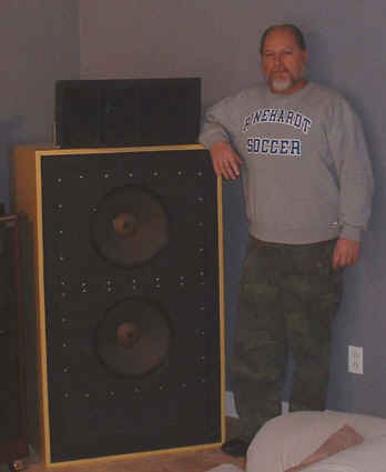

I don't have any 12LTAs, instead dual Altec 515Bs in 50" H x 30" W x 24" D cabs
Very very my kind of speakers.I want to ask if you will have future options ....for future speakers what do you have in mind?

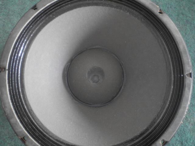

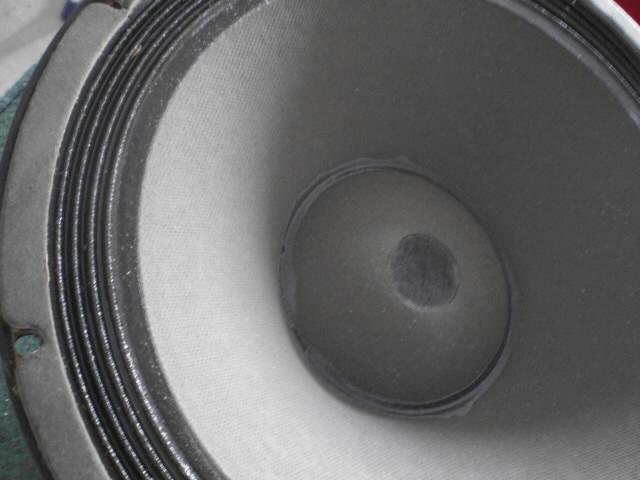

Also considering you have "some big" experience with Altec's maybe you could help me to figure out if that Altec was rewinding or that kind of glue is present on most of the dustcap drivers.
This is Altec 414-16B:

If I understand your question, Altec's quality assurance (QA) slipped quite a bit over time beginning in the '60s due to being bought out/financially gutted, so just because it has a little glue showing on the DC vent screen doesn't mean it's not original or was re-coned with a factory kit.

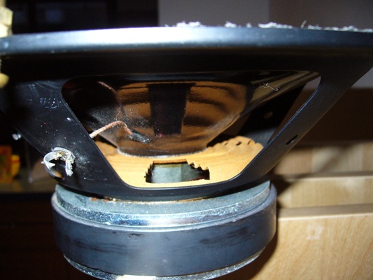

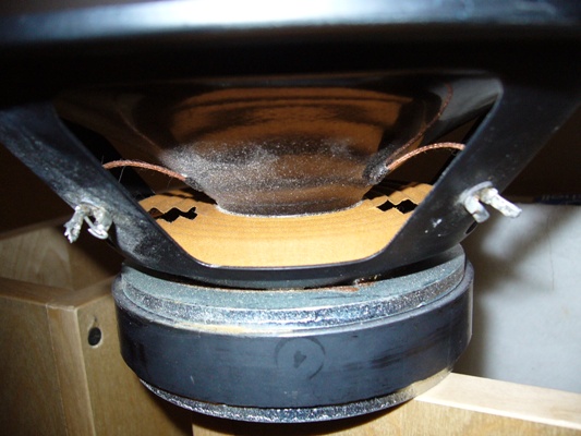

Been there, done that 20 years ago. I usually built closed boxes and in these, there were no problems regarding durability, at least not bass drivers. If my fuzzy memory is right, the bass was louder. But don't hang me for that, young and foolish as I was, it could have been less control of the driver!
The real problem was, that after one year, the gravity took over and rubbing of the coil was a fact. These on the pictures, have a triangular shape of the cut outs, like a nuclear radiation sign. The importance was to have the cut outs at 5 and 7 o'clock + the last at 12 o'clock. That prevented the sagging of the cone.
