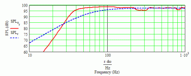

Is there any MLTLs for this thing set up?
I see in Thorstens Afterburner project that he uses a short, squat box tuned to 40Hz. Its 75x48x30 cm which is close to golden ratio. If you wanted to get this up to ear height, would it be best to use a golden ratio box with a false bottom or stand? Or could one use a box with these dimensions: 4.47x18.9x57.9 inches? They have the same volume which is 80 liters or 2.83 cu ft but the later is shaped more like a MLTL. Thorsten said to use the 18.9 inches for proper wave launch and I chose 4.47 inches deep because thats how deep the speaker is, so it should be braced against the back wall.
Any thoughts?
Any thoughts?
I've calculated a number of alignments including MLTLs for various folks based on different factory and measured specs over time.
Since the measured specs calc a larger cab I prefer to use them. Average of (2) units:
Fs 53.38
Re 7.3
Qms 5.17
Qes .66
Qts .59
Vas 92.19l
Sd 530.93
dB 95.33
Bl 11.96 T/M (10.5933/10.5189 calc'd)
Anyway, with these specs and your dims I get a ~37.66" i.d. from bottom driver position and a fairly under-damped, bass-shy alignment that will require quite a bit of stuffing to quell its ragged response, negating much of what little gain it has:
GM
