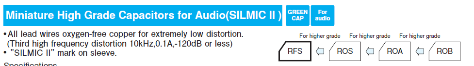

Try a different supplier, the Silmic II does go to 63V in the 330uF according to the datasheet.
Also it was the attached part of the datasheet that made me lean towards the silmics over the cerafines. That and the tan theta being lower. The cerafines are the ROA series...
If you can't get the silmics in the size you want, rather than getting the cerafines you could consider a nichicon KZ. They go up to 100V in 330uF and are probably closer in performance to the silmic II than the cerafines (note I'm going purely off the stated tan theta on the datasheets here, not off any direct experience), apart from also being an "audio" marketed cap.
