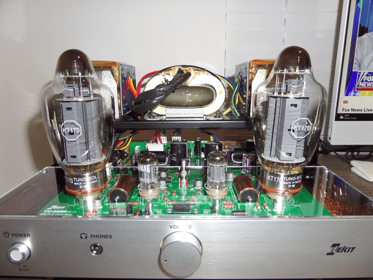

I experienced a bad KT-170 in a pair I bought. I did not buy this pair from Victor but another private seller on the web. These were a backup pair for his amp that had never been used or tested in his system. Unfortunately I discovered one tube was fine, but the other produced a hissing noise that did not increase as the volume knob was turned. I swapped the tube from left to right channel and the hiss followed so I know it was the tube itself and not some function of the amp. The hiss was audible from my listening position when no music was playingI moved the 8550 to another room and the RF interference went away (as I knew it would). Now I've confirmed some instability at higher volumes. It acts like the tubes are microphonic. I swapped some KT-88s and so far the distortion has not reappeared. I'll be testing some more, but for now it seems like the KT-170s are no bueno for this amp. I'm sure Victor has tested these extensively so I'm not sure if it's my setup or the tubes I got. We'll see.
Also as the amp continued to heat up, the questionable tube did something odd that I haven't seen before in my limited tube experience. It seems like it became microphonic after being powered on for several hours. It would start amplifying either hum or vibrations from the transformer. As I would press my hand on the top plate of the chassis the hum would somewhat quiet down but then would reappear a short time later. The hum was not loud per se but extremely audible and could be heard when music was playing at normal volume. The seller offered a refund for this tube which was very kind.

I just tried a set of KT-77s and they sounded real good as well. Next step is swap the KT-170s back in and see if the problem persists. It might be just one tube, I haven't really explored that yet. But it does sound like what you experienced. After about a half hour or maybe more the music starts to distort like the tubes are microphonic. Stay tuned for more.
Okay, I swapped the KT-170s back in and can't seem to duplicate the distortion I first heard. Problem solved? Still have the problem with RFI from my computer. I lined the case with copper foil tape and it had no effect. I put the steel top plate back on (was acrylic) and no effect. I'll try lining the top plate with copper tape. If that doesn't work I'm SOL. If I leave the volume on the amp at about 1/3 it's not audible at listening levels. I can adjust the volume on the preamp and it doesn't affect the volume of the noise. Once I get more than 1/2 on the amp the noise becomes quite obvious. I know it's the computer because as soon as I shut it down the noise goes away.
Located the source of the RFI. I had connected my PC to input 2 on my TU-8550 so I could listen to Youtube videos. It didn't seem to affect my TU-8900 but it was very audible in the TU-8850. Before I abandon that approach I'm going to try some ferrite beads and if that doesn't work I might try a better cable.

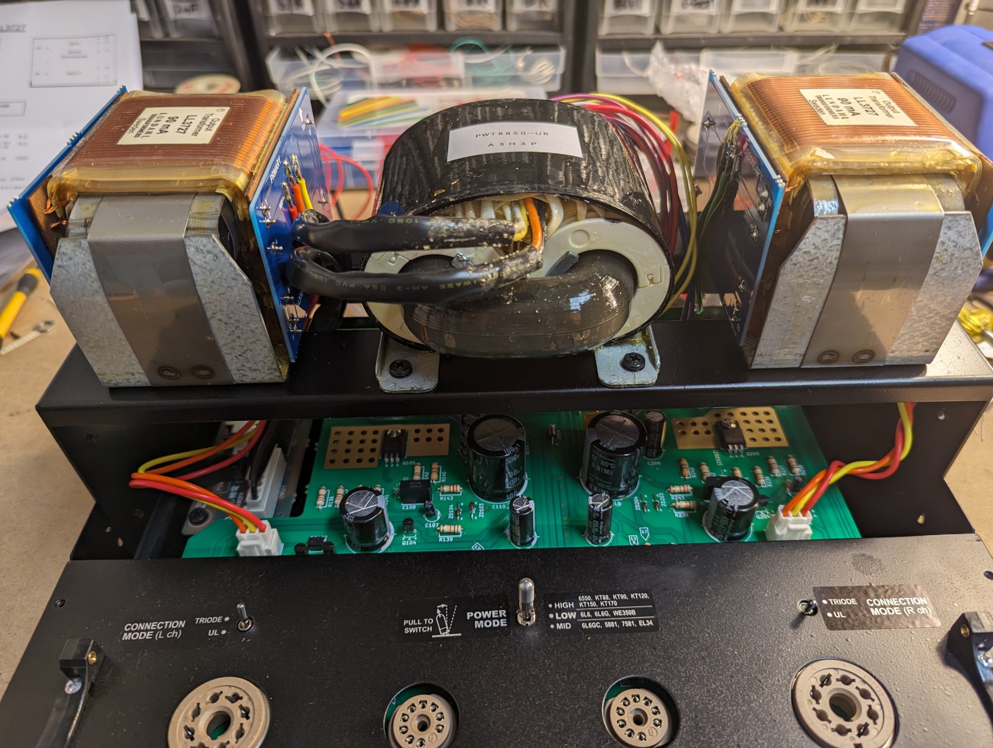

Lundahls sound great as expected. Low end is greatly enhanced, bass is textured, highs are more detailed and the soundstage now feels like it is projected out into the room and beyond the speakers. I now understand what Victor meant about the KT170 having 300B qualities in this amp. Very 3D and nuanced sound.
I have a very faint hum in the left channel but think that might be due to wire routing. Have to put my ear next to the tweeter to hear it. Will work on that today.

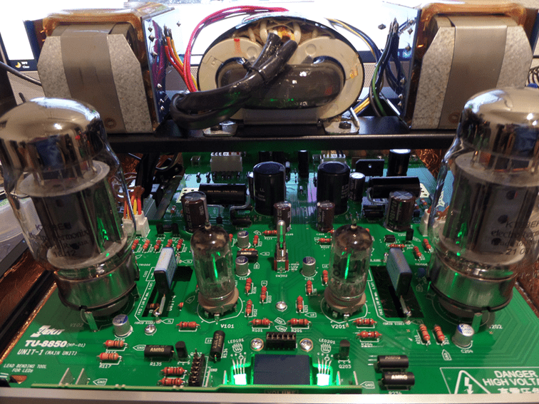

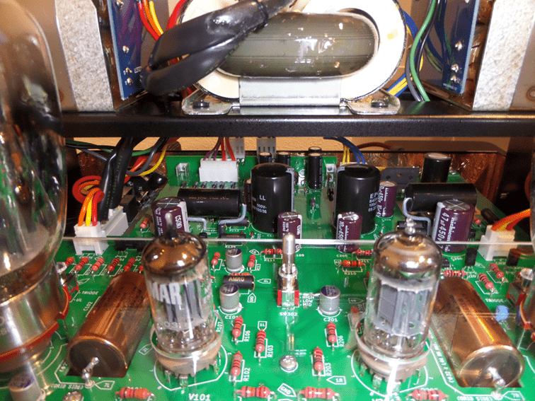

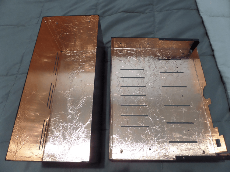

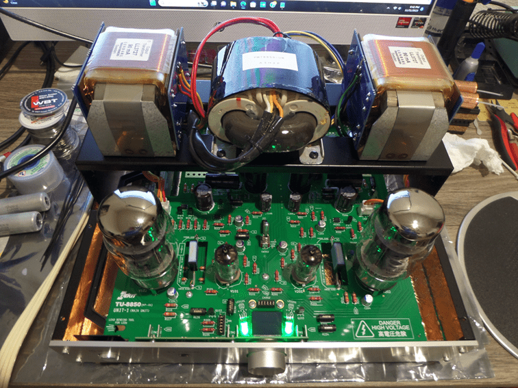

Just completed the build and completely dead silent. I had lined the case with Copper Foil as a RFI precaution. Burning in the Amp(150hrs) and will switch out KT-88's to KT-170's and will install Audio Note Copper Foil. I also upgraded the standard film (C108,C208) with Mundorf MCap Supreme.
Resistors: Audio Note Niobium Non-Magnetic Resistors (audio path), Amtrans AMRG
Looks awesome! You are in for a treat when you swap in the KT170.

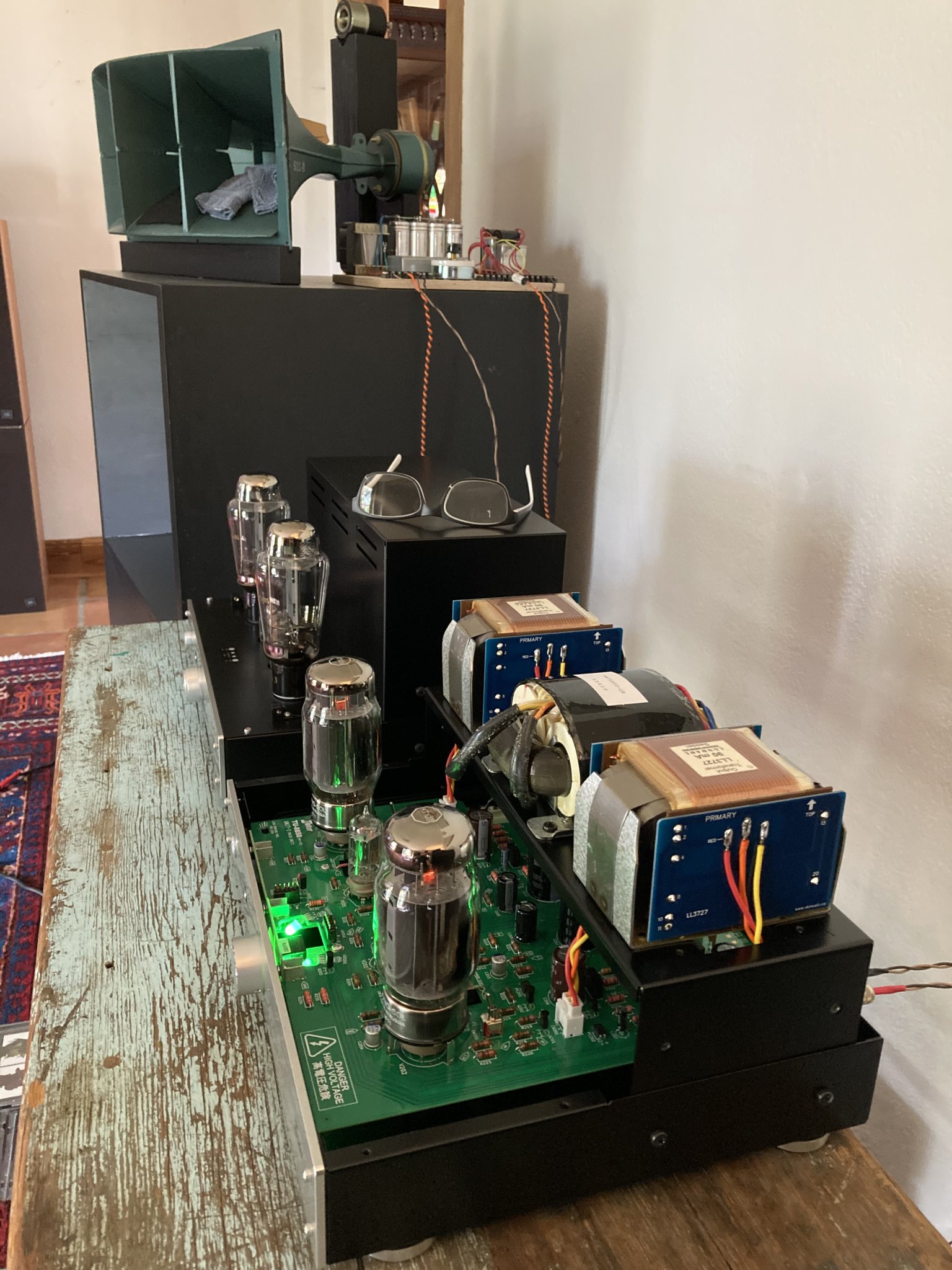

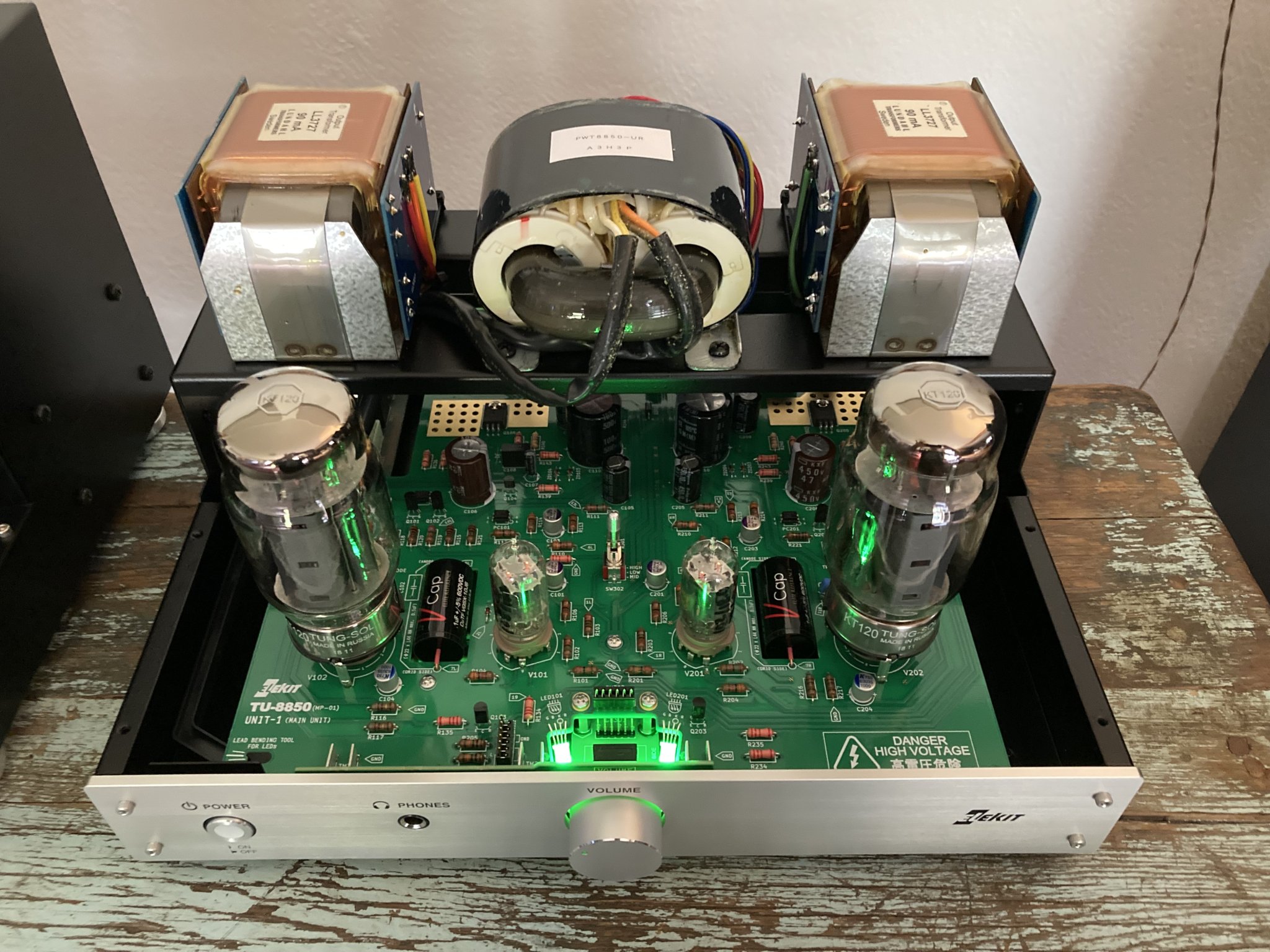

Looks great! Are you using Belden speaker cables? I am considering buying a set to test with these amps!Just finished. All voltages in check. Using some valves that I don’t really care about in case it went boom. Sounds pretty darn good for the first time running. Thank you Victor I am addicted to building these kits.

Looks like from the picture yours has the same problem as mine. The acrylic cover doesn't sit flush in the front middle. There's a small hump in the board for the volume pot that doesn't let the cover sit flush. I thought about sanding it down, but I think I'll just live with it. It's not noticeable with the metal cover because it's thinner than the acrylic.
