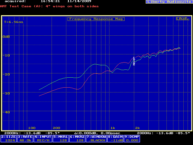

ESL AMT Viability Test (Part 1)
I have been in the midst of an ongoing series of experiments involving the resonant interaction between ESL panels of different sizes, aspect ratios, tensions etc. Also included in this study is the affect of air loading induced on the panels by baffles.
The AMT test is actually kind of a detour for me, but I figured I might learn something useful...and I DID.

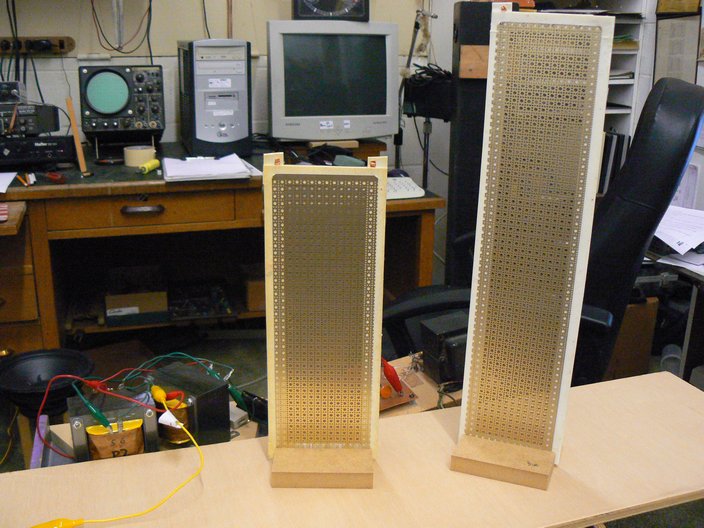

I used one of the panels from my other study and some existing baffle building blocks rather than take the time to build anything specific for the AMT test. The test panels were built using thin uninsulated perforated aluminum, 1/16" 3M foam tape, 6 micron film, and 1E9 ohm/sq Licron coating. The stators are intentionally uninsulated, and the bias voltage run fairly low at 1.8kV to aid in day to day measurement consistency with varying humidity and temperature conditions.
I use LAUD and PRAXIS measuring systems with B&K electrostatic microphone. For near field measurements of ESLs, I usually use a cheaper calibrated condenser mic to avoid the chance of damaging the expensive B&K mic capsules with a HV arc.
Measurements are complete. Test results are quite definitive, I think.
I will post the data later this afternoon along with some additional thoughts on ESL AMTs.

ESL AMT Viability Test (Part 2)
It is kind of funny how seeing a bit of experimental data can vastly improve ones ability to understand what they are reading. The behavior of slot loaded pleats is actually taught in both the Heil and Williamson/Walker patents. (US3636278, US3008013) For transducers whose moving mass is essentially made up of the airload on the diaphragm, the concept is rather simple. The vibration amplitude of the slot loaded diaphragm is reduced by the ratio of the slot width to the slot depth. Hence the name "Air Motion Transformer"? As a result, the acoustic output is reduced by this ratio as well. Assuming minimal viscous losses in pumping the air in and out of the slot, the output for one pleat will be reduced by 20*LOG(width/depth) dB relative to the same panel in free air.

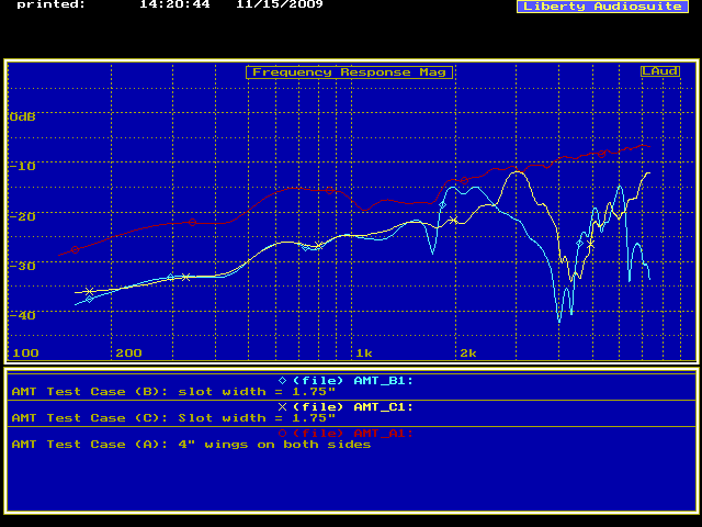

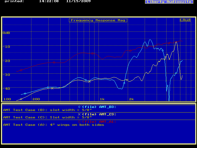

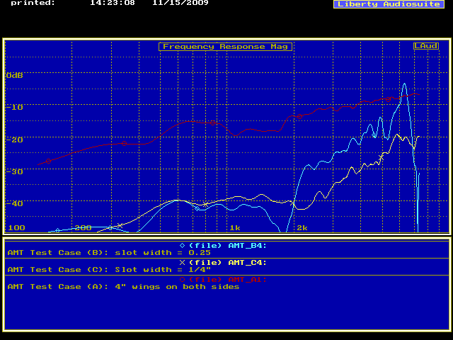

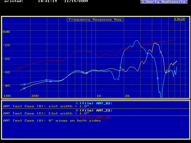

I constructed 4 different slots for both Case (B) & (C).
Slot Depth (in) ... Slot Width (in) ... Ratio ....... SPL for one pleat
4.0 .................. 1.750 ............... 0.438 ..... -7.2 dB
4.0 .................. 1.000 ............... 0.250 ..... -12.0 dB
4.0 .................. 0.625 ............... 0.156 ..... -16.1 dB
4.0 .................. 0.250 ............... 0.063 ..... -24.1 dB
I believe the measured data supports the theory, especially considering the crudeness of the apparatus.
Yes, duct tape might have been involved.
The first plot compares Case (A) with and without baffle extensions. The expected dip and hump are seen along with the LF boost resulting from delaying the onset of dipole front to back cancellation. If we can restrict our SPL comparisons to the 1.0 – 1.5 kHz range we should be able to avoid having to decipher the possible differences from baffle effects, HF beaming for Case (A), and HF cavity resonances from the slot loaded pleats for Case (B) & (C).
The next 4 plots compare Case (A) to (B) & (C) for the 4 slot geometrys summarized above. As Keith’s intuition led him to believe, the diagonal pleats are clearly superior to the parallel pleats in that the onset of cavity resonance is much less abrupt and pushed higher in frequency. Looking at this data, I think that the reduction in SPL follows the theory quite well considering the experimental and construction tolerances. Others may interpret the data differently.

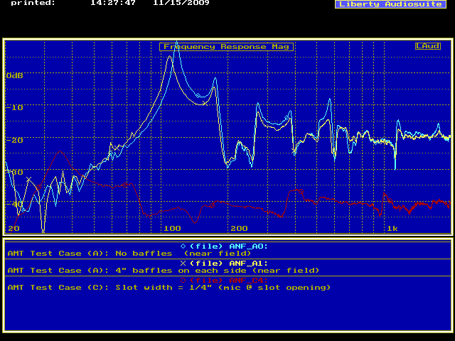

ESL AMT Viability Test (Part 2) continued
The last plot is a comparison of the near field response for Case (A) with and without baffle extensions, and Case (C) with ¼” slot. Note how simply adding 4” baffle wings to an ESL panel adds airload on the diaphragm and reduces the fundamental resonance (Fs) of the panel. Case (C) with ¼” slot increased the airload on the panel by 16 so we would expect the panel Fs to drop by a factor of 4. This is very nearly the case. The slot does damp the many diaphragm resonance modes somewhat, but not nearly as well as simple application of resistive damping with cloth mesh attached to the stators.
