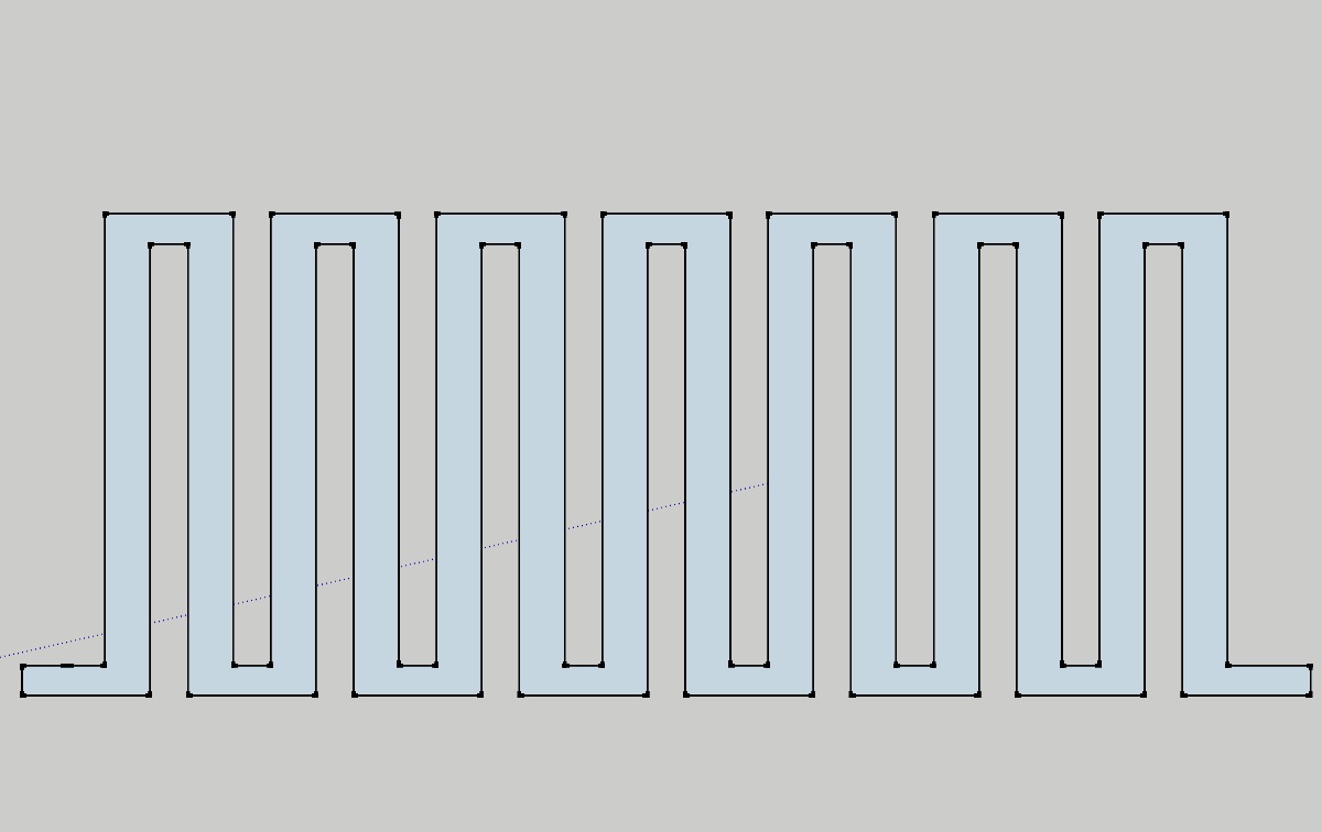

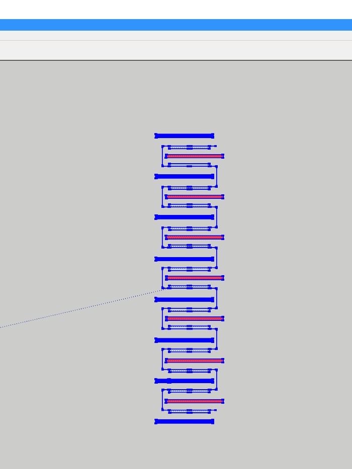

Ohoh gone post on a thread that is years old, i knew i´ve seen it somewhere
so yesterday night my brain rambled about the EAMT once more....
i noticed the first posts plan was using the foils as stator and feed audio onto it as well. really neat idea, not yet clear if it panned out. but i was thinking more around these lines. (see pic1) similar also posted before. i've seen the measurements from Bolserst, what i dont get is , every form of a cavity destroyed output ? in this a ESL version , since my magnetic amts do function better then a foil that has the same size the amt contraption would take up.
Then ofcourse the dips and peaks created by the cavity, or the fact it emits top end over a size bigger then the halve a wavekength are a problem to. but i thought if is use these solid stators. im free segment them depth wise.
Its weird but in this case i could segment the EAMT in 3 directions. vertically like most ESL's , horizontal and depth. depth could be usefull , so having a bigger low pas the deeper you go into the pleat. ?
just a brain fart
since the Bias track is continuous, i wonder if the repelling force is an issue... although they are 6 mm appart in this design.
To make the vertical stators i thought about making it from 0.5mm PCB strips (might need to add an ofsset since it is single sided)(could be any solderable metal thin enough as well) then cut some vertical strips 2mm thick and solder them on to the vertical ones to hold the correct spacings and be ably to hold the whole thing in front of the foil ,
Gone be allot of juggling in all directions to align , main problems i see tolerances! its easy to create a fault somewhere (like PCB not straight enough , or one of the folds)
i would etch a metalized 5 micron foil for the bias track to try.. but this time i wait a little someone might say it does not work !!! because .. and ... so i dont waste any time this time
