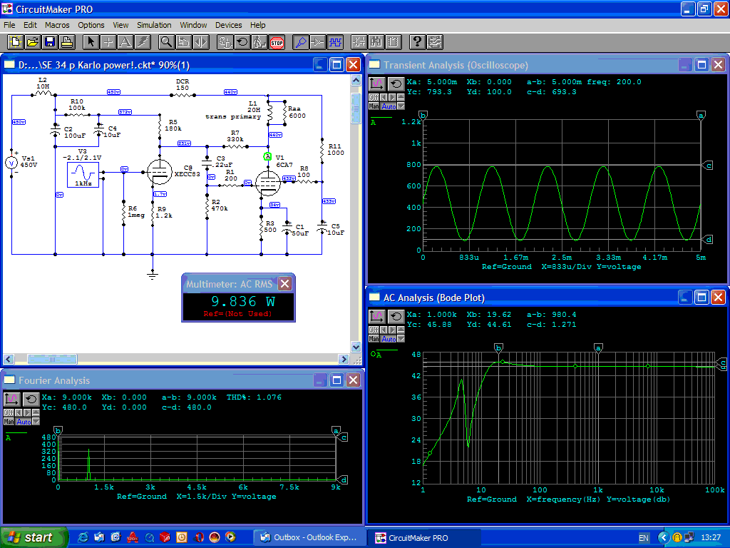

Due to "popular demand" -- Yugo... I am posting a print-screen of the schematic and most important simulation results for the RH34 amp -- the RH amp for EL34/6CA7.
The schamatics posted is for "high power" purposes and to my opinion it represents the "last careful" step i attaining high power with this design. Actually, by lowering the B+ (the only mod. needed) you will loose some power, but gain reliability I suppose some 400V B+ is OK.
The RH34 which is in regular use was built for a B+ of approx. 350V and leaves nothing to regret on 86dB/W/m speakers... I suppose it would do great on higher efficiency speakers!

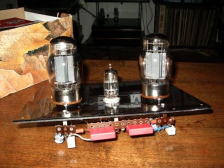

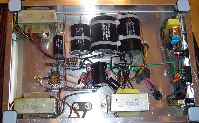

RH84 (well kind of mostly) lives !
Well folks,
both channels now work, I forgot to wire the Left input socket to the 12ax7 grid
which helps when you want to get a signal through the amp
I also added a 330Uf to the final cap since Aleksander felt the ripple would be high as is.
Anyway it is playing and even at this very early stage I think it sounds quite nice.
I have a low voltage SE EL34 UL amp that I built many months ago that I was underwhelmed with and am now going to change it over to RH mode but am waiting to see the second generation version with the 6550 as I have KT88's to put in and a few extra watts may help with these Swans, otherwise it will be the RH807 but with higher power and using 6l6GC's or KT66's,
In the mean time I think I will connect my Jeriko horns up with this amp and listen, I just need to get them out of storage (they are buried in my "office" at home as I was planning to keep the Swans in position for a while).
I was trying to get some 6094's about two months ago to do a SE amp but it did not work out so maybe I will try some 6AQ5's and also the 5V6 with this one, very punchy amp ! This may end up in my office at work.

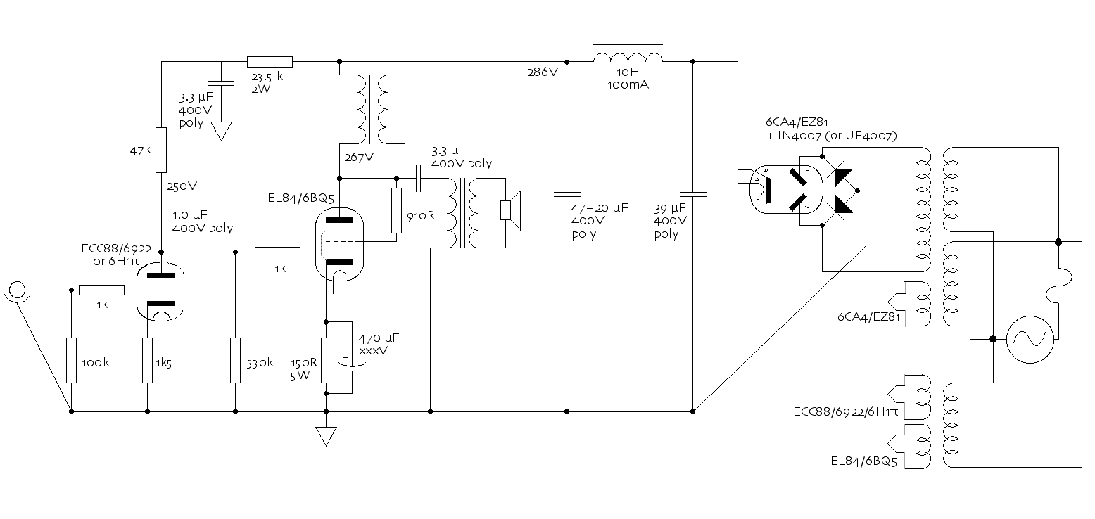

Alex, I hope my last post didn't sound petulant - that was not my intention.
I missed your post number 87 - by now I gather you've seen Planet 10's post of the current schematic. I'd have 2 concerns over trying your circuit configuration;
1) due to the restrictions of the power transformer, I've got only 286V B+ after the filter chokes and caps in the power supply - would that be close enough for your design?
2) I've implemented a parallel feed configuration on the output tube, would that be a problem?
While I'm at it, I should mention that the next scheduled revision is to change the input tube to an EF86 (once again courtesy of my "mystery" benefactor) Since I've got another 3 day weekend, I'll probably implement that before your reply.

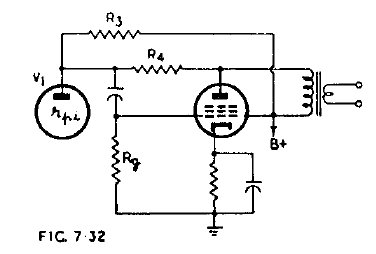

Page 332 of RDH4 (Radiotron Designer's Handbook 4th Edition, Fritz Langford-Smith) has a bit on this type of topology as well. As an aside, copyright has passed on RDH4 and it is now available online!
I've attached one of the diagrams from that chapter. A few minor differences and we'll end up with the RH series of amps.
