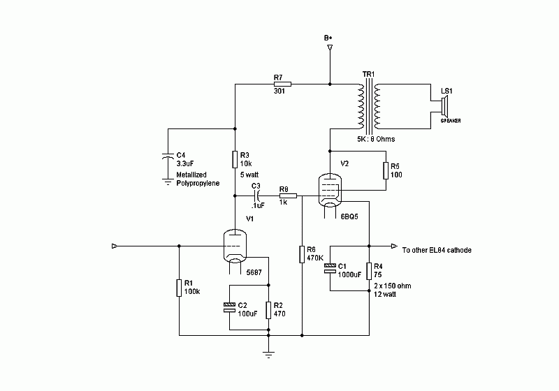

Aleksandre,
during the development of your RH84 did your try to combine the output pentode in UL mode and to compare the results!?
You will also get a little NFB through UL tap! I am asking you this because I sometimes prefer to listen the UL tap than the triode or pentode mode on my PP 6CA7 amp(output T/X is purchased from Maplin),depending of what kind of music I am listening to! There are SE output T/X at the market with UL tap at 43% windings,IIRC. They are little more expensive than the ordinary SE but I think they are worth to try.

Let me comment the other, more important issues here. The
last, but very crucial question, came from Yugo. No, I did
not try it in UL mode, and aside the fact that I have no UL
tapped transformers at hand, it would not serve any
particular purpose. Because, as I see it, we are not
talking here about pentodes/tetrodes and the way to use
them, but about a quite different circuit topology which
actually exploits what a pentode can give us, where the
pentode itself is not to be viewed as a pentode, but as a
tube of "such and such charactheristics".

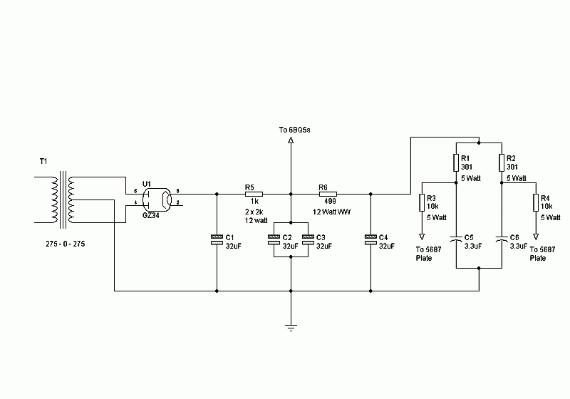

1.Choke-filtered power supply in RH84
This is a huge difference, you know?! Not that it is or
should be original, but it is "the most sound way" to deal
with an SE amp power supply. The fact that chokes cost more
than sand resistors is not to be condoned here, since
no-one said it had to be a 100H/100mA choke wound with
silver and gold threads, costing xy thousand US$! A quite
simple and cheap choke would do a great deal of good to the
design, yet it was ommitted for more than obvious
cost/profit reasons.
2.Pentode mode operation in RH84
As I already said, pentode mode operation is not the true
definition here. And, if said with that formulation, it
immediately implies a lesser design. On the other hand, we
are talking about the same tube used in the Zen amp...
using it in triode mode still leaves us with a pentode,
since aside the fact that between the grid and anode you
still get two grids, you cannot alleviate the fact that the
electrons do not get to g2, g3 and a in a different
fraction of time -- since g3 remains at the potential of
the cathode (it does not have a separate pin -- and
furthermore, the opion of using the pin which as I recall
exists on the SV83 is not used in the Zen!).
On the other hand, pentode mode means more power, where the
PMPO chepo rating of the Zen becomes a more realistic
figure, making it quite useful for ordinary people with
ordinary 86dB/W/m speakers.

3.different input/driver valve
Actually, although I stressed the difference between
valves, the issue here is more like "incorrect operating
point vs. correct operating point". If we just correct the
operating point in the Zen amp, it WILL sound much better.
The reason why an incorrect operating point is employed,
and why a second even worse is offered to the user, remains
unclear. The current to be consumed is most certainly not
an issue here, since the power transformer and the
rectifier are more than capable of supplying it... and the
filtering caps are not that small not to be able to give an
adequate ripple characterstic to the B+ supply with
increased current. I will not fall in the trap of making
conclusions by myself, although, like with the PMPO rating,
I would expect the author to write an essay on "how
specially selected tubes by especially knowledgeable people
can give discerning sound qualities to the illuminati"
(oops, I did it too: that was sarcasm, but at least it does
not give anyone a liable case).
4.individual bypassed cathode resistors
Well, since we are talking about stereo, not dual-mono... I
consider that a "sine qua non" condition. Darling or no
darling, it is both logical and straight-forward. And, it
is usually done with sand resistors, so it costs so little
one must not mind. The fact that in the Zen a special
resistor with cooler is used does not do the trick of
making me believe that it is about the price of components.
When it comes to the point of mimicking AC ground, I would
at least bypass. If you have a cathode biased SE amp at
hand, try removing the bypass caps from the output tube's
cathode resistors, and then see for yourself whether the
amp still has the same gain: if it has, then I am wrong...
if it has not, then you are wrong in assuming that the case
of mimicking AC ground can be applied to this instance. On
the other hand, bypassing the "common cathode resistor"
might prove useful.

I built a revised version of the little Zen amp using a 5687 as the input tube. It was a very nice sounding and involving amp. I feel the EL84 is the best Pentode or tetrode to use in triode mode soundwise but you are limited in the voltage swing you can apply to the grid ( unless you exceed its maximum rated plate voltage) and it will clip during a powerful passage because of the limited grid bias voltage headroom available without frying the tube. They sound wonderful for light Jazz and female vocalist. There are a couple of Diana Krall songs with such over emphasized mids and mid highs that they will cause the little guys (the EL84s) to clip unless you are listening at a lower than desirable level. Of course there's no pint in listening at that point. While it's sound is more articulate and airy it's bias voltage and power limitations make the EL34 a far better tube for a good solid all around tube amp. Anyway, the schematic for the sweet little EL84 SE amp (my first and arguably most enjoyable amp with the right music) is posted below. If you build it, enjoy.
G
G
Gavin's Amp
Hi, Gavin...
Nice little elaboration of the Zen-amp. Nice little power supply. I do not have the time at the moment to review the operating point of your driver, although it does seem to me that it is drawing very little current.
Did you actually take a peak at the site previously mentioned and read the last few pages of the thread? Nice as your amp is, the whole post looks to me like an anti-climax. After some discussion on design principles, you just cool us off with nice-little-Zen-revisited and a story about EL84 vs. EL34.
Did you consider that the EL84 can overcome those subtle deficiencies you mention just by being operated differently than in triode mode (1.8W max) -- for instance, in RH mode ?

Re: STOLEN THREAD AND VARIOUS TUBES
There is no need to defend your design. No one is attacking it, just looking at it and asking questions. There is a difference.
You said yourself somewhere that the output stage in "RH" mode is run as an I/V convertor. As such, a pentode input stage (and its inherently high Zout) may improve performance. At the very least, it will give a different sound. Of course, pentodes are less linear and all of that.... The high Zout shouldn't mess up the HF performance too much anyway since Rfb shunts the milleramplified Cgp of the output valve, which creates a HF pole, hence limiting response. (I admit this is arguable, the grid of a pentode presents an inherently low capacitance - in comparison with triodes.)
To those wanting Alex to use "Less pedestrian tubes" The EL84 and ECC81 are boring, I admit. That doesn't mean that they are poor performers, though. (Said by someone who rarely uses "pedestrian tubes" himself)
Alex, to get more people interested, why not try something like "RH mode" 813? That'll get people interested with its glowing filament! Or if you're not going to build a 1kV+ power supply, try something with KTxx valves. They tend to get people excited (look at all the new types given a KT designation, KT90, KT100 etc). If you're not looking to spend too much money, the KT33/KT33C is cheap. No one seems to want them.
Alex Kitic said:The thread is about EL84SE design recommendations -- and I think since I was mentioned in the first place, and secondly offered my design to whoever wants it, it is quite natural that I should now stick to it, both defending my design and trying to prove that it is the best available There is nothing bad about it, I think.
Alex Kitic said:If the story is about pedestrian tubes... well, why the thread then? I am working (actually waiting for inspiration and time) to do some work on a less pedestrian RH amp, with 307A/VT225 tubes. Directly Heated Pentode in RH mode... less pedestrian, ha? Eventually, some exotic driver? But that would be abusing the thread, wouldn't it?
answers...
A relatively short answer, for starters...
1) Defending my design
This is an obviously bad choice of words (command of the english language or not, I still speak some other language at home ). I should have said ADVOCATING -- does that sound better?
2) Pedestrian tubes
I agree that people should not regard ANY tube as plain pedestrian (OK, xCL86 xCL82 and similia might truly be pedestrian tubes... but that does not make tham uninteresting, since people have differing needs, possibilities and get satisfaction from building i.e. small amplifiers in the physical sense of the word).
On the other hand, those not interested in pedestrian tubes should immediately skip a forum on EL84 design... and go for some 300B alternatives, as I belive there are some. But, what is worth and feasible for an EL84, can be applied generally to any tetrode/pentode tube of higher interest, like KT90 or 6550... whatever.
3) RH mode 813 and similia
Well, when it comes to 813, we get to another set of cards. This tube can deliver very very much on its own, "without help of any RH concoction" -- just wire it in triode mode, and you will immediately get the goods, like high power output etc. But this is what I like to call "an EHV tube" -- extremely high voltage tube, where by extremely high voltage I assume everything a garden variety instrument cannot measure directly (like 700V DC). Most sites tend to stress the issue of danger, and I regard it as a necessity -- but at EHV levels (EHV in terms of audio applications, of course), I think that i.e. 1000V DC is dangerous to most.
4) What tubes need it?
I did some RH circuitry simulations for KT90 -- a long time ago, and I will try to find the files since I've recently been given some 6550's (the good variety, ST shaped, without holes in the anodes) and would like to try it, especially since at the time I called it "second generation RH". The same is true of i.e. 300B -- application of the same "second generation RH" circuitry did give some extremely interesting results when simulating. But the results I am talking about are numbers, like 9W with 1% distortion, as compared to the usual 9W 5% distortion advertised for 300B SE circuitry. How would it sound with triodes? Is it truly needed? You can easily get 6W of power from a KT90/6550/KT88 in triode mode, thus surpassing the 5W limit I believe to be
"the real world goal" for volksamplifiers in the sense that most people will find the power level to their listening satisfaction with ordinary "mid efficiency speakers" found in most homes.
What I want to say is that generally, I was never interested in simulating circuits (and designing them -- as some people here find to be un ugly and offensive term) if I did not have the tube at hand. Cost was never an issue for that, since I rarely paid "internet prices" for any tube I've stashed in my "collection").
Application of "RH circuitry" (if I am allowed to call it that) to whatever tube might be possible -- but just like the previously in this thread mentioned "promise of solid state", sometimes it might not make sense. The sound of a tetrode/pentode is more than obviously inferior to the sound of a triode -- if used conventionally.
During time, several application strategies were developped for tetrode/pentode tubes to bridge the gap between higher efficiency and inferior sound, like ultra-linear taps. Consider my "circuitry" as one such approach -- and it does deliver the goods, in the sense that the sound is much improved, as I previously said "almost identical to the triode connected tube in the same circuit". And almost identical can also mean "better". But it does need to have a reason for applying. A 300B with same power and less distortion (I did not try that one as for sound) does not necessarily mean "better than the usual" (just like the promise of solid state) -- on the other hand, 4-5W with less distortion and better sound compared with 1.5W with more distortion and lesser sound (from an EL84) seems to me a legitimate goal.
5) Pentode drivers
Yes, in theory a pentode driver might "do the trick" even better, since it has higher output impedance than triodes. With current sources, a high output impedance is very welcome (unless I got that wrong, and I sincerely believe I did not). The only reason why I did not try that one is given by the fact that a) the triodes mentioned above, which are mostly "garden variety" pedestrian types (easy for everyone to get hold) do the job quite well;
b) my "collection of suitable pentode drivers" is very low; c) exchanging the driver ECC81 i.e. garden variety type with some "better sounding NOS tube of the same or similar type" does give rewards in terms of better sound (i.e. Ei ECC81 vs. Telefunken ECC81, or Philips 6201, or "you-name-it-highly-regarded-NOS") -- that might implicate that "sonically inferior pentode tubes" might actually give lesser results in the particular application -- and their contribution in efficiency terms is not necessary for the task.
Finally, one issue should be considered, which most of those who tend to dismiss others with punctuation marks obviously overlook in their might -- whatever you want to do, takes time and effort. In order to design a circuit (i.e. 307A RH mode) I need to have spice models at hand. If I do not (and in 90% of the cases such models are not readily available) I have to "write" the model on my own, which is not that difficult as it looks, but takes some time and effort. Once the model is ready and inserted in the circuit, there is more work, thinking, and knowledge to be applied, in order to get some result. Therefore, the "collection" of RH circuits is relatively limited -- I did only what was interesting to me, or requested by friends -- and of course, when I had the time to do it.
Regards to all,
Aleksandar

Re: SE pseudo triode vs. RH pentode
That would depend on your definition of very little. The current through the driver is around 10-12 mA.
After having read the rest of the thread, as you suggested, I can see you are coming from.
I would indeed wouldn't it? How about a older yet still available tube like the 807. I was going to build a SE 807 amp but did not when I realized how little rms power I was going to get out of the circuit. Perhaps you can explain how the feedback resistor is calculated for a given input/output tube combination? Also I suspect that using a UL connection to the output tube in a "RH mode" amp would make the sound of the circuit differ from that of a pentode connection as was previously suggested in this thread.
Alex Kitic said:Hi, Gavin...
Additional
Gavin:
To start with the current drawn thru 5687, as I said, I was not going to do any calculus on that -- if not directly understood, I was actually sorry for being too dismissive. If it is 10-12mA, which seems quite a good operating point for the 5687, than there is no question whether it does sound a lot better than the original Zen.
807 -- although not quite the same topic (the thread is about EL84) -- you must have seen the RH807 amp on my site. This one was indeed built in a variety of versions, including an "integrated" one. And, as on the published schematics, it has quite "enough" power -- if some 5W as compared to the meagre amount in triode mode would be enough for you.
Furthermore, the 807 topic can be extended by either increasing the B+ (no changes in the circuit needed) just taking care about the Rk of the output tube, and the R before g2, in order not to surpass anode dissipation and g2 voltage ratings -- and it will give even more power. Alternatively, exchanging the 807 for a little more powerful members of the same family, like 6L6 specials, or 7027A, you can get up to almost 10W.
The calculation of the resistor seems to be 1:5 approximately, meaning that the Rfb is actually up to 5x larger than the Ra of the driver tube... it's a mix of current from the B+ rail, and current from above the anode of the output tube (and indeed some feedback) that does the trick. Actually, once that basics are established, there is a lot of trials by simulation and some thinking to be done. Not being a scientist, I have never given it a serious tought to make some exact rules on calculus.
UL taps would obviously do something with the sound -- as I said, I did not try that one, among other reasons because I did not and do not have at hand transformers with UL taps. It might improve the sound -- and it might decrease the power, as well? In order to give a serious answer that would not cause eventual ridicule, I must think a little more about it. It did not matter to me, in principle -- so I never dismissed that idea completely, nor gave it any particular consideration.
Andrewbee:
Great! Finally someone is going to give it a try (I mean, counting the people who were reading about it lately in the forum)! Just go ahead, and if you have any questions or problems, just send me an e-mail.
About fixed bias -- well, I think that would not work, you know... it is important for the circuit to have a Rk below the output tube -- just as it is important for the Rk of the driver tube not to be bypassed by a cap. Both cases invalidate the previous results in simulation tests. Theoretical reasons -- well, I would have to take another look in various texts (and try to recollect the toughts I had while working on the RH circuit).
6V6 (5V6 is a 6V6 with different filament requirements, or am I wrong?) -- the results would be similar. I think the same schematics for the RH84 can be applied to 6V6, since those tubes are quite similar (anode dissipation, etc.). If the drive requirements are different (relative -Ug) than maybe it would not work that well without "revisiting" the values. But, since noone has tried 6V6 in the circuit so far, I am very interested to know whether it satisfies.
Aleksandar
Gavin:
Andrewbee:
Aleksandar
