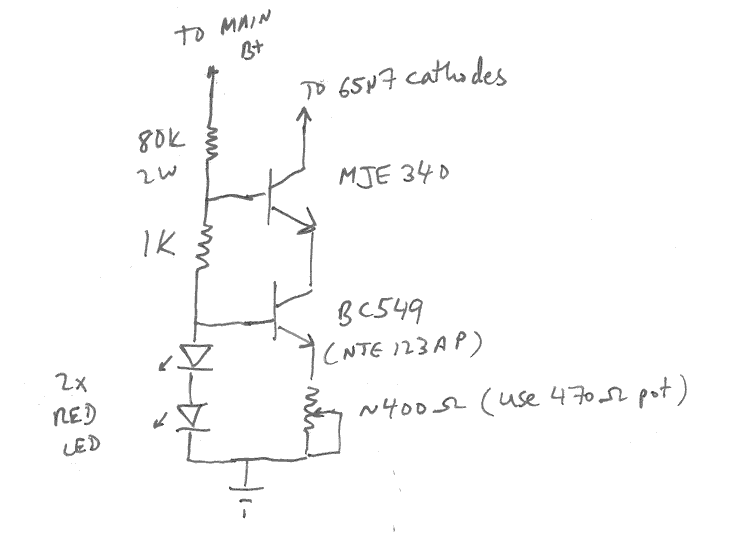

The schematic has uneven plate resistors for the 6SN7s, one is 33K the other 28,750 ohms. Is that a means of balance? I suppose it's like that to compensate for the 1M on the grids of the phase inverters.
I also couldn't explain the use of a 470mmf cap across the opt center tap and the plate of the top EL34?
I'm also experimenting with MJE340 as a ss regulator for my amp's front-ends.
JojoD
The uneven plate resistors are indeed done that way for balance- the gain of the grounded grid side is slightly lower than the driven grid side if the resistors are equal. Going to a CCS corrects that imbalance.
The 470pF cap is an interesting tweak. The output transformer is apparently not wound in sections but as one long winding. This is evident since the outer layer has a slightly higher resistance than the inner. In any case, the capacitances also vary, so the transformer is slightly imbalanced between primary halves at very high frequencies. The 470pF cap equalizes that.
Aha, so I was right regarding the plate resistors. An imbalance in the plate resistors will then give balance to the phase inverters. Learning CCS applications would have to wait for now though I'm sure I'll get there soon. :D
Thanks for the explanation on the cap, I was thinking of putting another one on the bottom side but that would have nulled the cap's purpose bigtime! :whazzat:
It is stunningly easy to implement a cathode CCS for the 6SN7. I've attached my circuit. Basically, the two LEDs are used as voltage references; the resistor string runs 5mA through them, which is a good minimum current. Clearly, the exact value of the 80K resistor is not critical- it can be 75K or 82K just as arbitrarily.
The trimmer resistor sets the tail current so that I can tune the 6SN7 plate voltage finely. A 500 ohm device is perfect. Start with it adjusted to 400 ohms. The upper transistor is an MJE340 or similar moderately high voltage NPN capable of dissipating a couple of watts. A small heatsink is sufficient. The lower transistor can be any NPN, but preferably, it will be one with a healthy beta and ft. The BC549 is a classic choice- I used an NTE device because I have a bag of them.
The entire CCS can be built on a small perfboard for about $5, less than the cost of a high quality power resistor.
