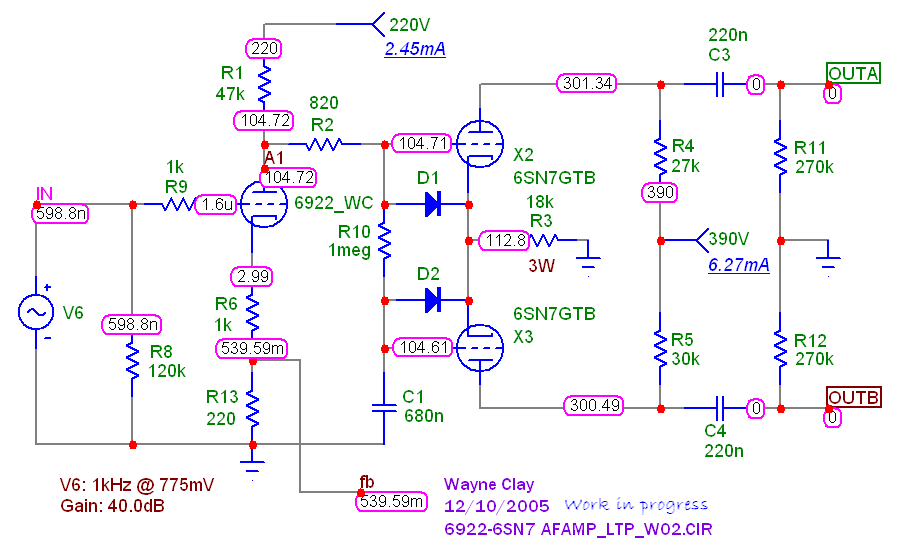

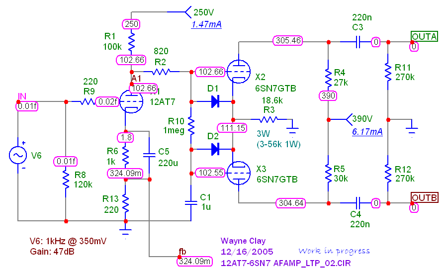

Anyway I'm posting an updated schematic using an ECC88 (my modified Koren's 6DJ8 model to better fit the Sylvania plate curves) which shows the NFB connection. Have you thought of using an ECC99 as the long tailed pair? Let me know your thoughts on this.
Cheers
Wayne :)
Edit: Of course in the updated schematic R6 (1k) would be bypassed and the gain would go up about 4dB. My goof up!

For each stereo amp you will need (1) 6DJ8/ECC88/6922 as they are twin triodes. For two stereo units you will need only two, one in each stereo amp.
Now the crossover. You will need two 6922's, one for the left channel, one for the right. That's 2X 6922 for the crossover, 2X 6922, one for each stereo power amp, for a total of 4.
As in the schematic, that's one amp/driver stage that drives each channel, a total of 4. OUTA and OUTB as labeled on the schematic; OUTA goes to the top EL34, OUTB goes to the bottom EL34. Follow? If you'd like I can 'draw' out a complete schematic of each channel with the EL34's included. Maybe that may clarify things a bit. This is where you divide the HIF87 circuit.
As for gain, there is plenty; 43 to 44db should more than adequate. If you would like more gain (I don't think you will NEED it) you could use a 12AT7/ECC81 instead of the 6922's in the AF amp stage in each power amp. If you really need more gain, impliment it the "seperate" crossover unit, maybe another 6922 or even better a 5687 IMHO. Placing it in the power amps will just make for more noise and may complicate HF stability compensation. Plus using a higher mu tube such as a 12AX7/ECC83 will make for more "miller effect".
And by the way if you have or can obtain 6922's I would use those. Other tubes useful in that position would be 6N1P, 5965A, 12AV7, 6AQ8/ECC85, and many others but you may wish to stay with current production tubes.
