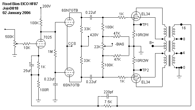

Here's the revised schematic for the bias section....
http://img.photobucket.com/albums/v70/jojod818/Dump/EICOHF87FixedBias2.gif
Will this be ok now?
BTW, my brother asked me for the 7027 so I may use 6L6 if not EL34.
Thanks!
I'd swap the 47K and 100K resistors. The way you have it drawn, the effective grid resistance is under 60K. Swapped, you get about 110K as the resistance, a little gentler on the drive stage, and this will also extend the low frequency f3 from 12Hz to 6Hz. The latter will help stability, important given the relatively high feedback.

so have I forgotten anything in my schematic? I will swap the resistors in the schematic. a 12au7 can also be used in place of the 6sn7 in the phase inverter?
