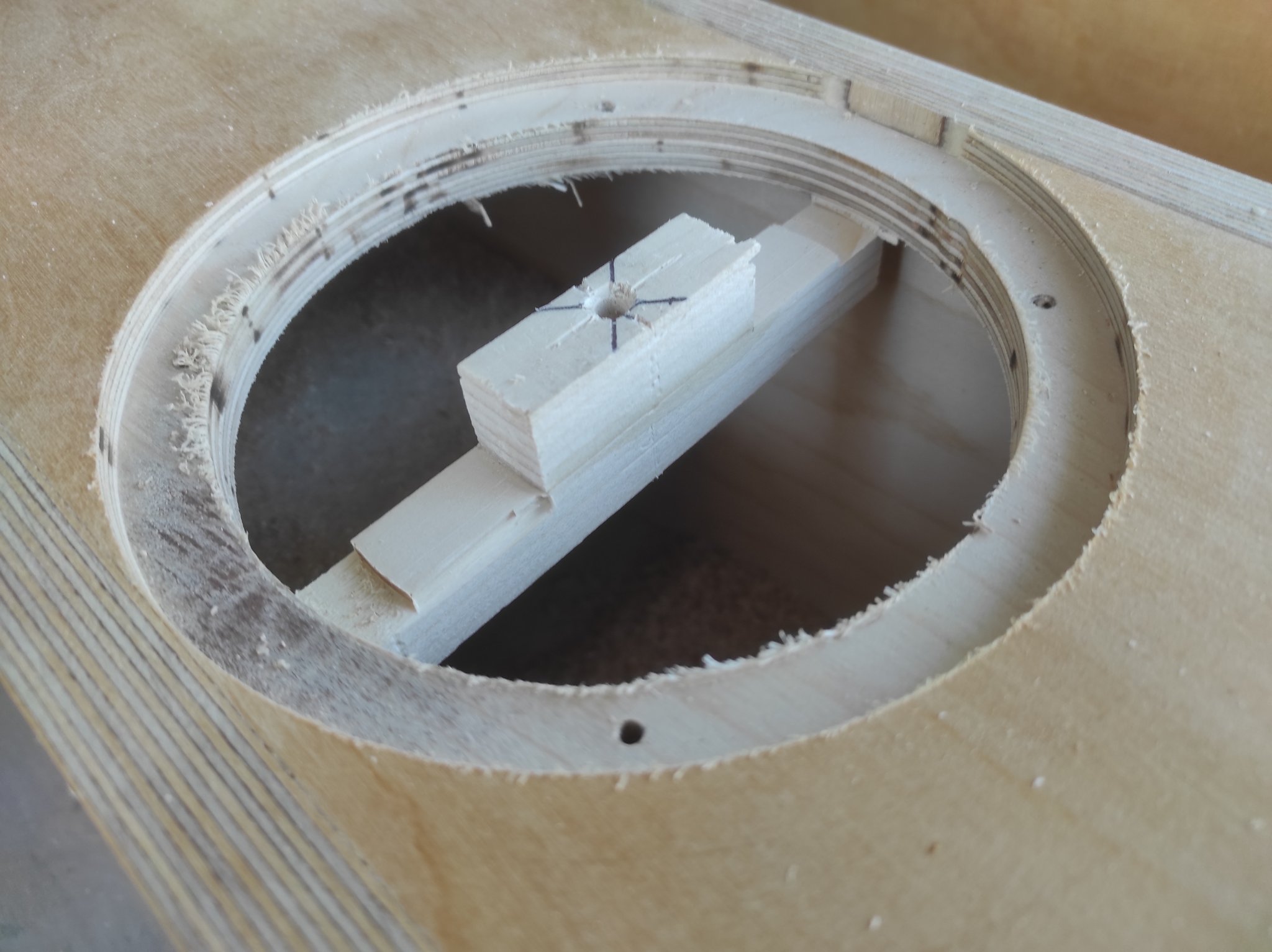

I just came across your design today. Extremely well executed! Can you tell me what you used for the ring around the tweeter? Thanks
That's an insert of birch plywood. There was another Tweeter used with 110mm OD, so i decided to rebuild this with router + circle. It also looks nice to me, but I had not spent that efford just for optics.

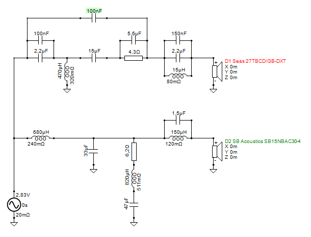

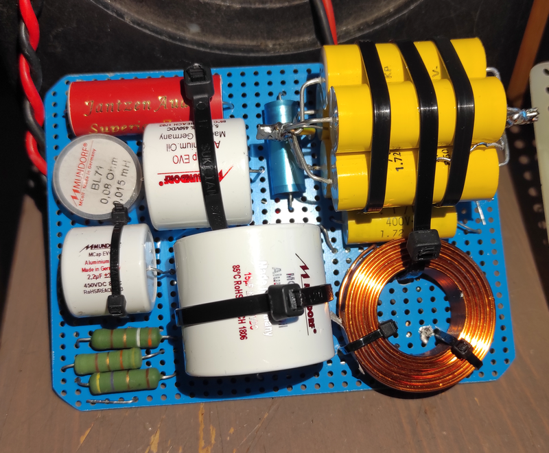

The Tweeter crossover is now rebuilt:

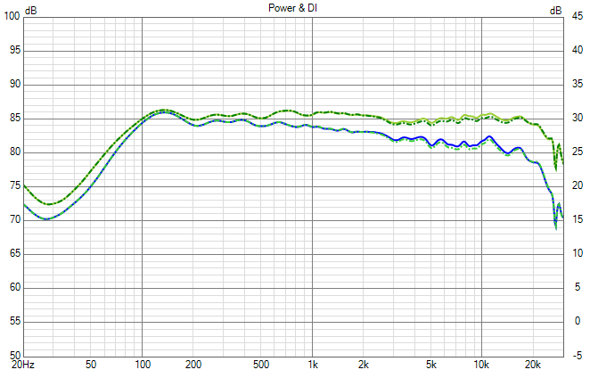

1) Tweeter's level has been decreased a bit around 3-4kHz intentionally, there was slightly noticeable overemphasis in the power response before.
2) The phase response of the drivers around the crossover frequency has been significantly improved and is now nearly flawless, for the architecture costs of an additional 15uF Capacitor.
3) Around ~1kHz there is minimally more level by the mirdrange notch. 5.6 ohms is too "fat" for me, 6.8 ohms is too "lean", 6.2 ohms fits well.

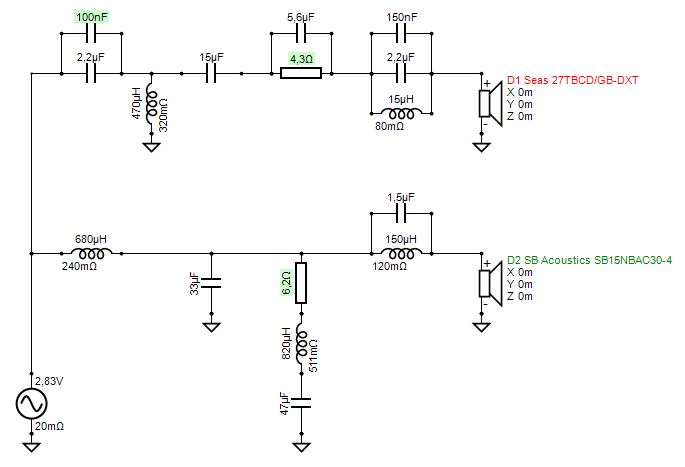

Crossover:
attachment.php
6.2 and 4.3 ohms are somewhat unusal values, but can be found in the E24 series, for example, as Jantzen Superes without issues.

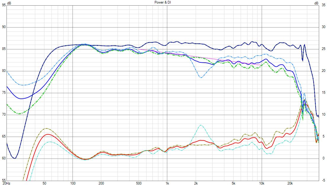

Power Response and DI only hor +/-60°, only ver +/-40° (both dashed) and hor+ver together:
attachment.php
Power Response and Predicted In Room Response based on hor +/-60° only:
attachment.php

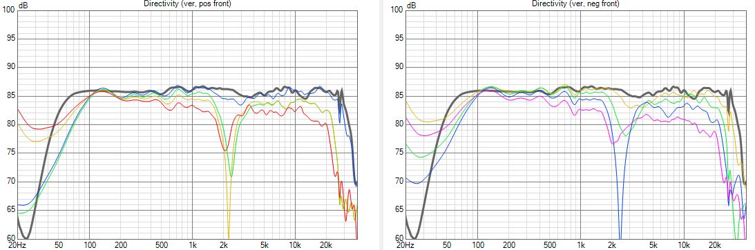

Directivity response based on hor +/-60° and ver +/-40°:
attachment.php
Vertical response +/-40°:
attachment.php

Just a very minor update: By the time I pushed the tweeter upper range ~ +half a dB by adding a 0,1uF capacitor in parallel to most of the filter network. I think it sounds a bit more balanced now, but maybe it is a matter of taste...
You can use both depicted 100nF = 0,1uF capacitors to adjust the tweeter level in a limited range, as there is no voltage divider in the tweeter network for tuning. Increasing the 0,1uF || 2,2 uF pushes the lower treble, increasing the 0,1uF || "everything" pushes the upper treble. Leaving both 0,1uF out gives the lowest level ~ -1dB to my actual voicing, which may sound a bit too dark:

You're right, definitely not the easiest load to drive!
DC resistance of the woofer + coils is already < 3,5 Ohm, but the large parallel cap + the parallel notch are dropping the impedance < 3 Ohms. Had tried other possibilites in simulation, but I haven't found any other sensible solution without using a lot more components, or changing the SB woofer to 8-Ohm type.

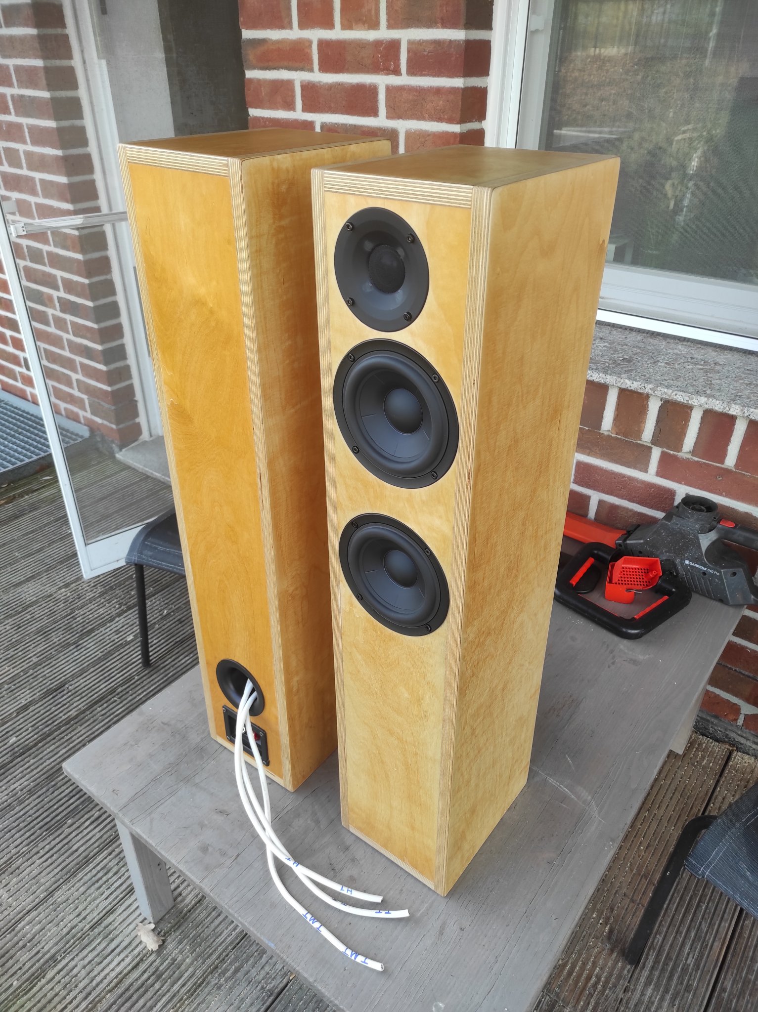

I just wonder if an MTM version might be worth doing too. There is always a Mk.2 version... :)
I'm not a fan of MTM / D´Appolito arrangement, but a little 2-1/2 Way TWW-Floorstander is a nice idea...

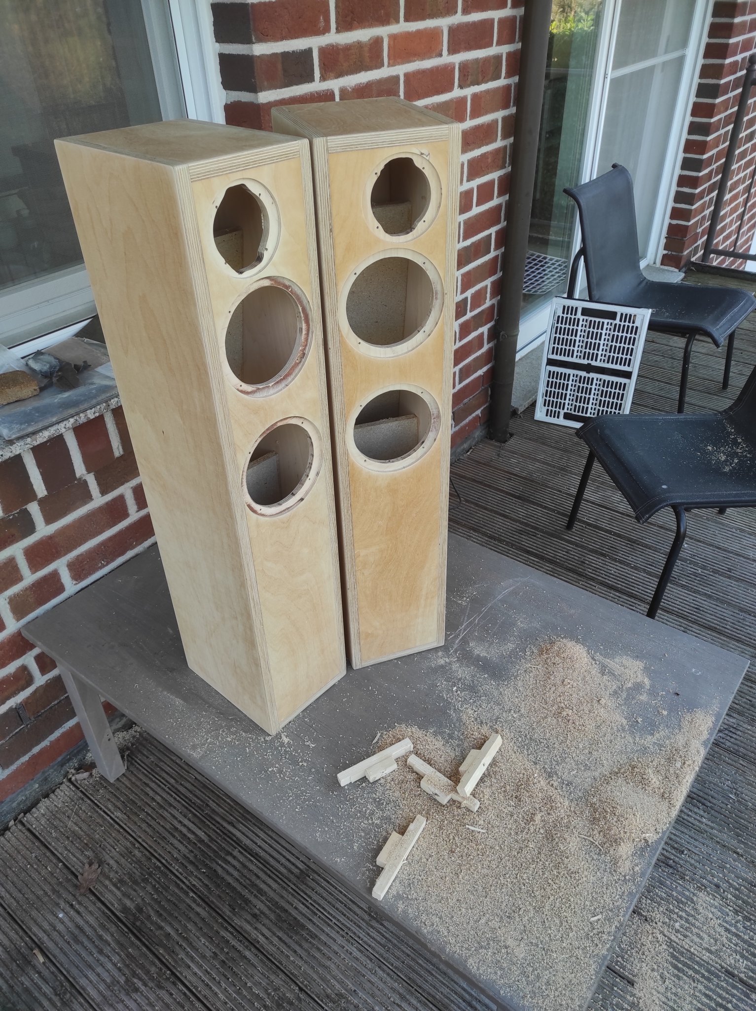

So, here we go :cool::

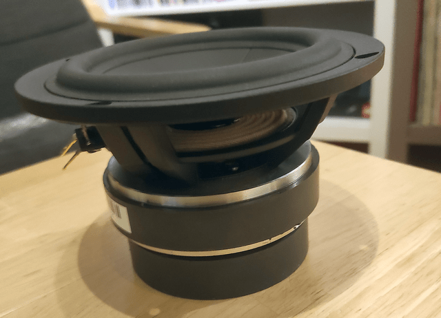

Bucking magnets ready:

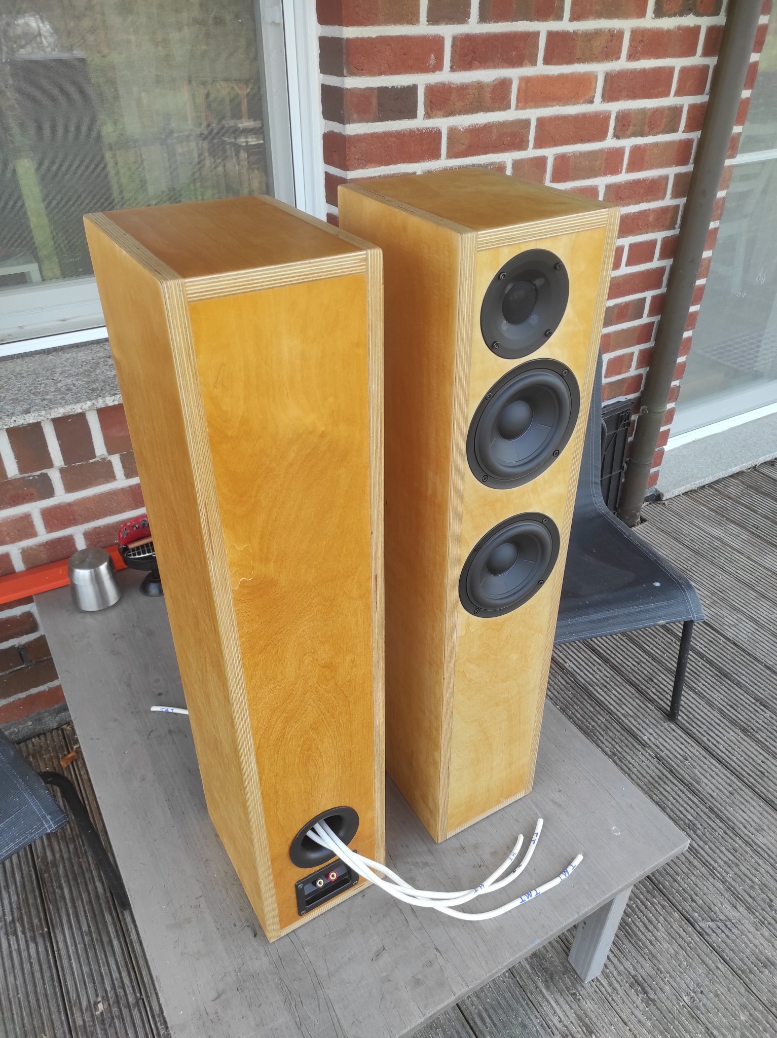

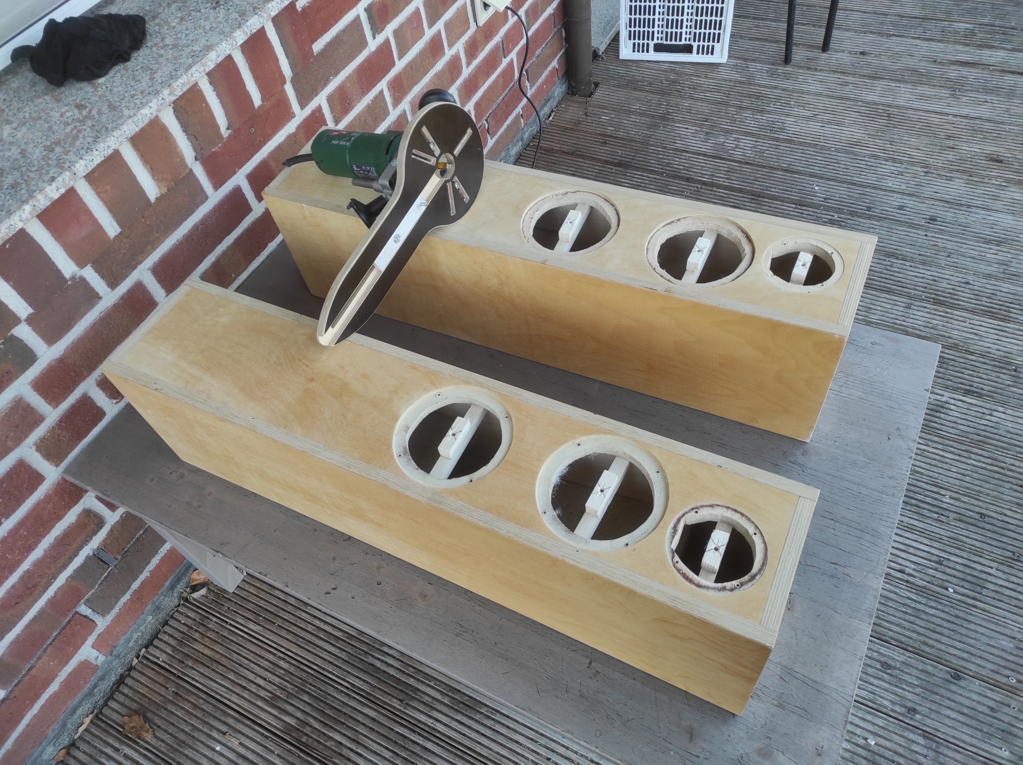

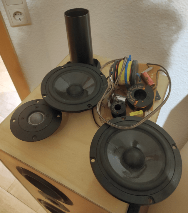

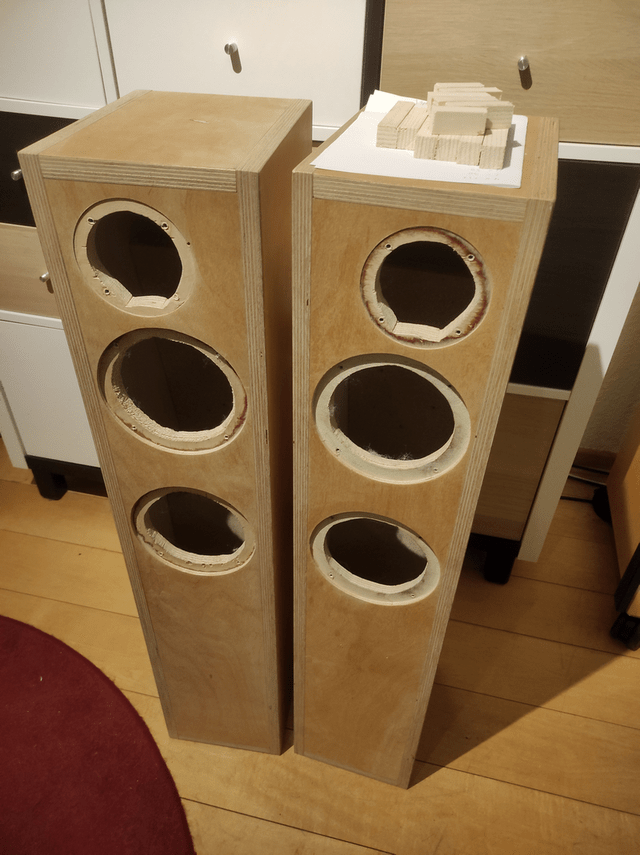

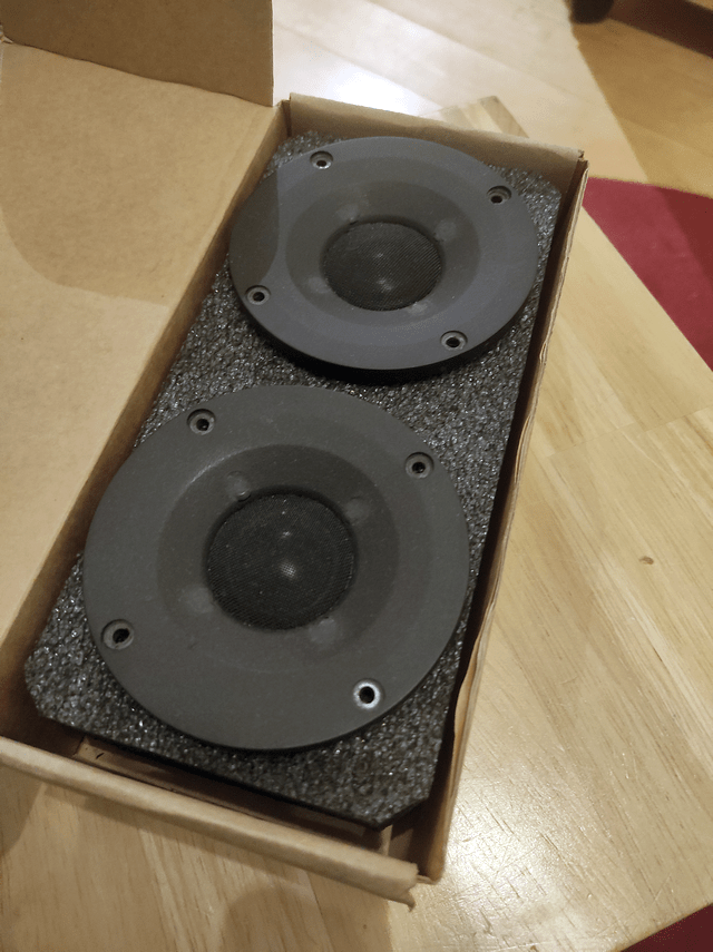

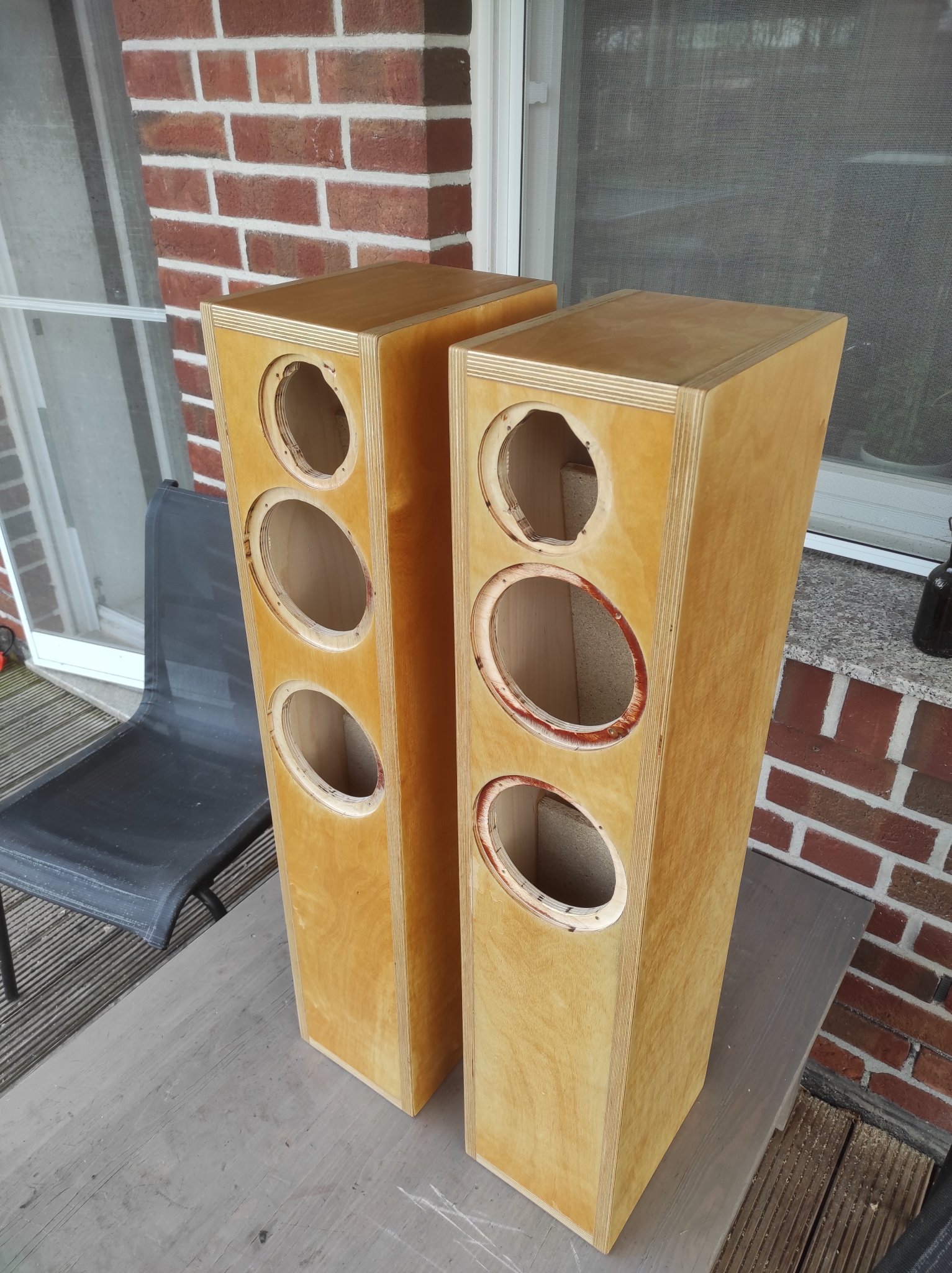

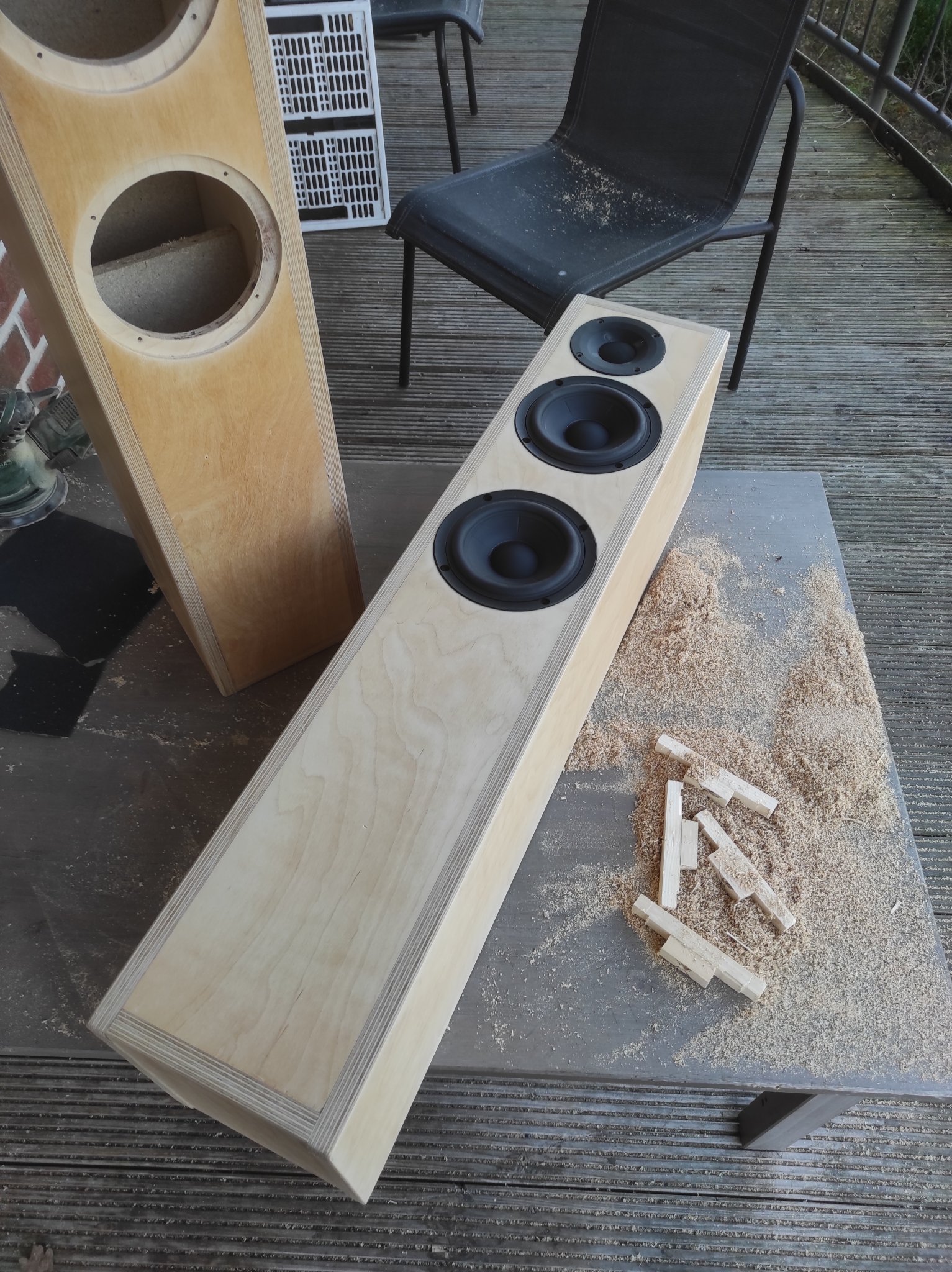

I build the shown enclosures above around ~14 years ago for the mother of my girlfriend (now my wife), drivers were from an Audax remaining stock sold by the german distributor for ~20-25 € per piece:

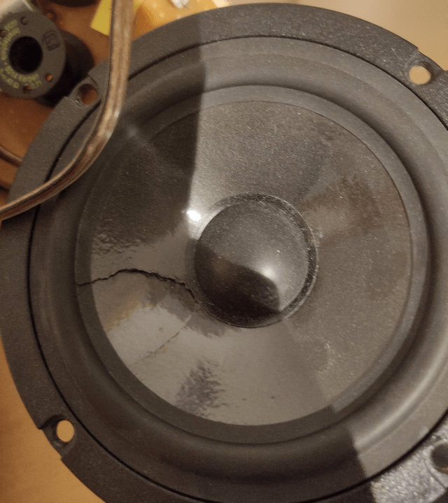

Somehow the speakers have then found their way to my wife's younger cousin (he's a really nice and handy guy) who is a live sound engineer and musician by profession. He contacted me some month ago, because one driver was broken:
He told me he really likes the speakers, as they sound good and have accompanied him through some shared communities and a lot of parties, and he wants to keep them alive. A few weeks ago he visited me and brought the speakers, we had some discussions about the options, he had a listen to the Edelstoffs and some budget to spend and we decided to rework and upgrade the speakers then.
Tomorrow sunny weather is announced, so I plan to go out and grip my router and rework the enclosure to match the new drivers (fortunately the new drivers all are few millimeters larger in all dimensions), and refinish them.

Kwesi, did the magnet help significantly to improve the sound of sb15? I am thinking of giving sb17 another chance as it could benefir from additional magnet as well.
Well, I would not say "significantly", but I percieved some improved defintion and precision of the sound subjectively.
The enclosure is small and according to TSP simulations FR and GD might improve with the magnet:
https://www.diyaudio.com/community/attachments/bastamagnet-png.1100709/
SB15/SB17 have exceptional clean midrange, especially CAC and NBAC, but for woofer duty with high excursion requirements there are out better ones.

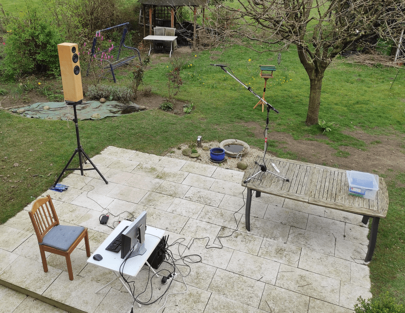

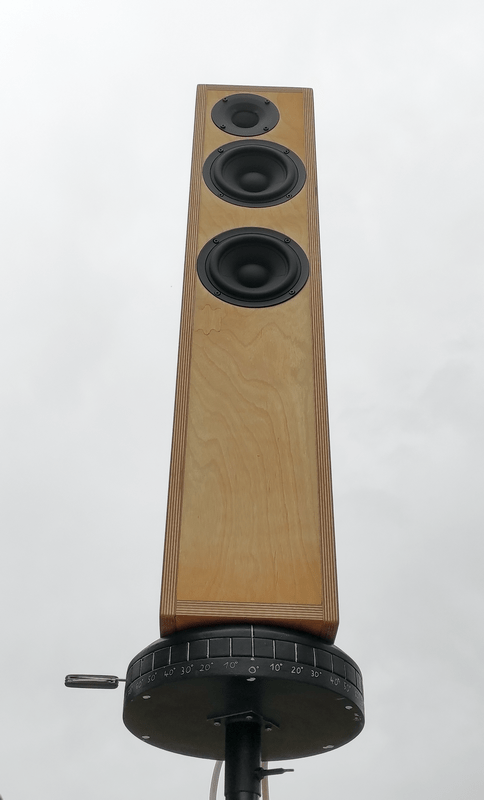

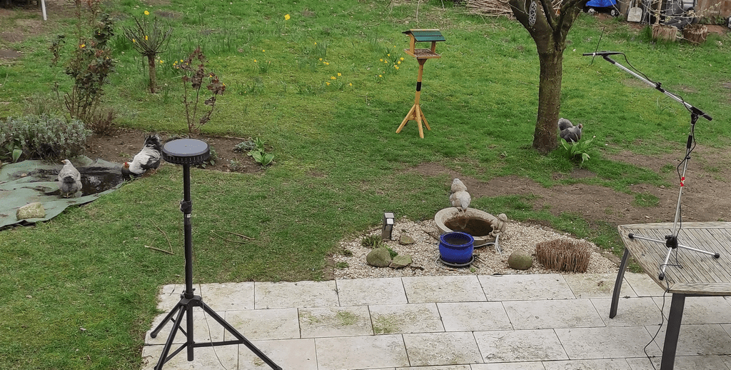

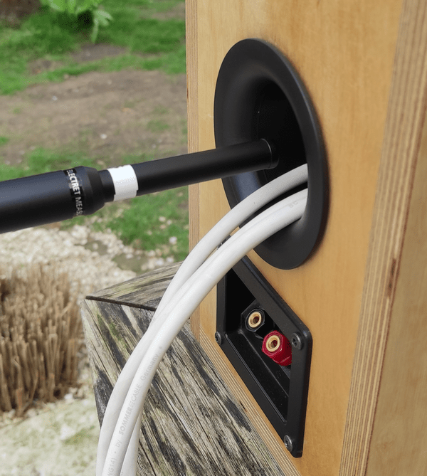

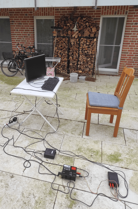

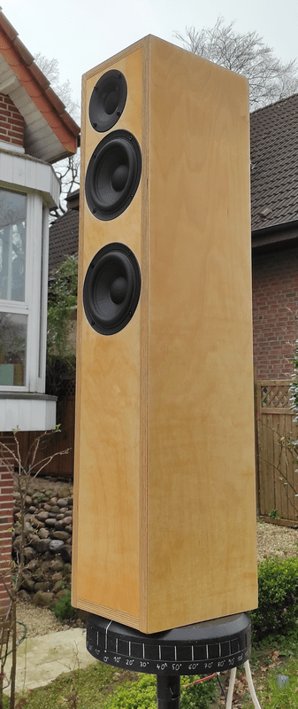

Measurement morning...
DUT: Edelstoff XT
Some temporary guests from the neighbour farm:

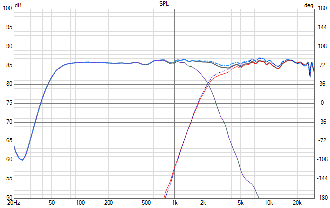

Got pretty happy results:

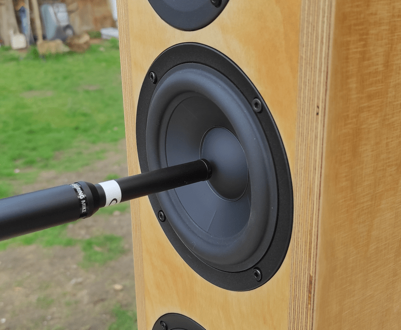

Measurement setup:
  • Monacor ECM-40 mic, Monacor MPA-102 preamp, FR calibrated
  • T.amp PM40C measurement amplifier, ARTA measurement switchbox.
  • Computer with ASUS Xonar DX soundcard for I/O, ASIO drivers, ARTA/LIMP V1.9.4.1
  • Mic height ~2,2m, mic distance ~2m

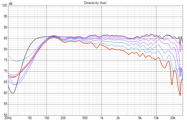

Measurement data:
  • drivers individually measured +90° ... -90° horizontal, gated with ~140Hz resolution. Both woofers directivity data was measured for each driver, with the other then short-circuited.
  • On-axis response is merged with nearfield responses. Both woofers nearfield data was measured individually, with the other driver then short-circuited. Vent response with both woofers conected in parallel, reduced by -6dB for merging with each woofer response (measured/merged other electrical combinations and compared results in simulation also - many look similar in the result).
  • Impedance response for each woofer is the measured impedance of both in parallel, then doubled for simulation. (measured other electrical combinations, e.g. one woofer connected, the other one short-circuited and compared results in simulation also - most looks similar in the result).

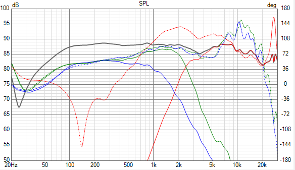

Observations:

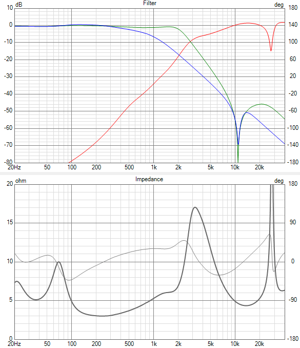

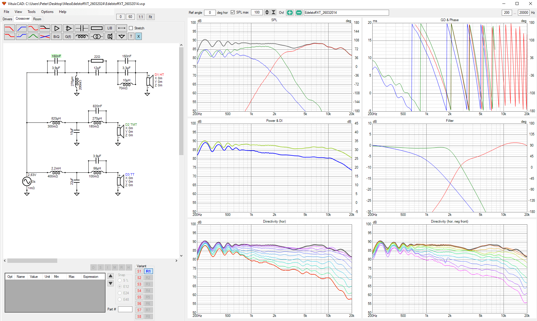

Lower woofer is integrated textbook baffle-step-filler concept style; you can see that also on the electrical slopes, midwoofer stays flat generally, lower woofer fills up then +6dB below baffle step.

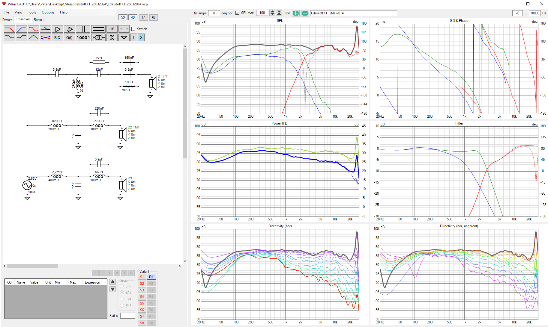

Xover is modified 3rd order electrically, aiming quasi LR4 acoustical slopes. Phase matching and tracking is slightly worse than with the original Edelstoff, but nice for the minimum efford tweeter filter, the additional 22 Ohm modification gives a degree of freedom helping to shape the response a bit. See inverse null response as dotted line in SPL window.

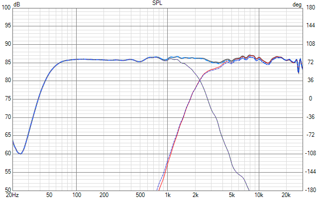

The baffle edges without rounding or chafering result in an on-axis FR drop around 3,5kHz due to edge diffraction. Never fill that up, it will sound sharp!
Optimized the system for linear power response of +90° ... -90° hor data, and linearity of listening window based on +30° ... -30° hor data.
Above 10kHz, the DXT tweeter unfortunately has low sensitivity, so the response drops a few dB till 20kHz. This is typically for the DXT. The applied overshoot of the tweeter filtern nework >10kHz helps to gain 1-2dB back.
In dotted lines you see the effect of an additional parallel notch filter in series of the tweeter to surpress the 27kHz dome breakup resonance.
Both 3rd order electric filters of the woofers have each a small capacitor in parallel to the 2nd coil as modification; 2nd coil sized to serve the filter slopes, the capacitors tuned then so that the >10kHz cone breakup resonances are surpressed. The lower woofer network has small 2nd coil as not needed to contribute to the filter slope slope, so the notch is for fighting the cone ringing only:
Resulting system impedance, minimum is 3 Ohm @ 250Hz.
Still have to optimize the internal damping - losses of the vent in the usable range are a bit high, therefore it shows unwanted lenght resonance...

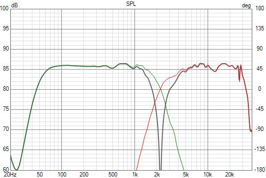

On-axis responses vs. unfiltered driver responses:
These are responses with very long gate containing the 1st floot bounce, 1/6 octave smoothing:
Should work, or? Any ideas before I will order missing xover components?
