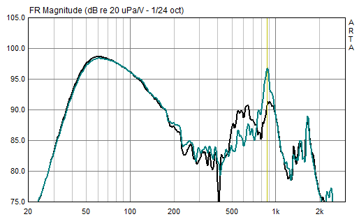

Single drivers in enclosure on slim stand:

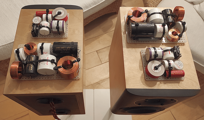

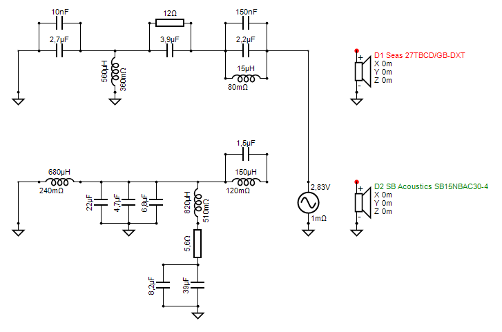

Crossover Network:

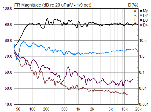

My mic distorts with a lot of k2, but here is a Farina sweep of the woofer in the box in 0,5m distance with the added magnet:

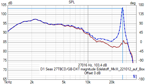

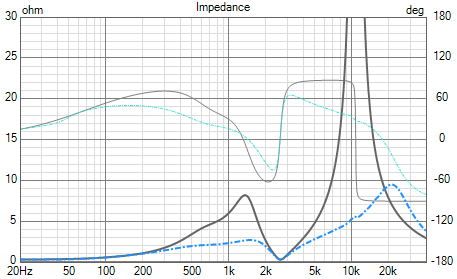

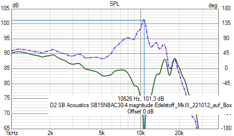

Both breakup resonances of the woofer and tweeter were treated with series notches according to https://purifi-audio.com/wp-content/uploads/2022/03/220211_R05-Notchfilter.pdf to decrease pre-echoes of the resonances in the distortion profile.
Tweeter notch frequency response:

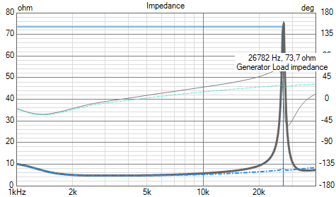

Tweeter notch impedance:

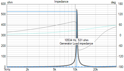

Tweeter backwards source impedance (solid line, with additionally connected driver = dashed):

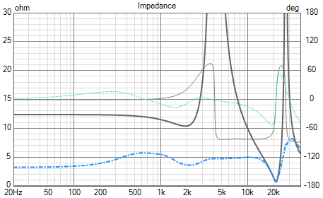

Woofer notch frequency response:
Woofer notch impedance:
Woofer backwards source impedance (solid line, with additionally connected driver = dashed):
Circuitry for backwards source impedance analysis:

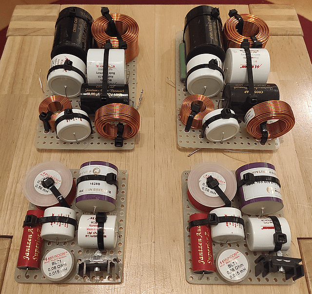

I'm waiting for the last missing parts of the crossover to get everything running, until then I'll be fighting with the standing wave in the vent tube.
Actual state:
A bit better with the additional resonator (anyhow, 6dB is half power), will decide if further measures are needed after final integration and listening...

A couple clarifications, parallel notches placed in series are called "parallel notches", and -3dB is half power, not -6dB. The program is VituixCad, seems a lot of people want to put an R in there....

Xovers:

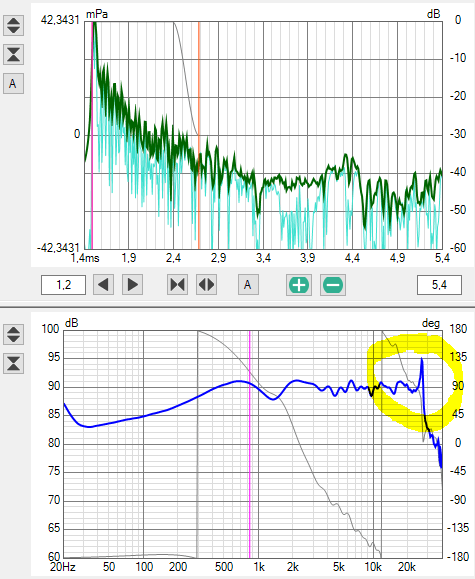

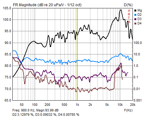

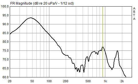

Rough Measurement in 0,5 mm distance, no gate:
A bit of the Tweeter resonance still remains; here in Vituixcad with better application of the mic calibration curve:
But pre-echoes in the distortion response are completely surpressed:
(The 90dB is correct, measuring distance approx. 30cm. The k2 comes from the mic...)

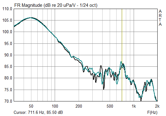

Here the modded woofer alone, without xover:
(The SPL is correct, measuring distance approx. 30cm. The k2 comes from the mic...)
Woofer nearfiled resonse & distortion (uncalibrated, but much less than 90dB):
I drilled out the 6 holes in the reflex tube to 4mm and optimized the damping minimally.
(a little thinner plucked where the gap is narrower, before that it was somewhat stuffed):
That's sufficient for me for now.

Furthermore, I have drilled out the 6 holes in the vent tube each to ~8mm. Have measured and calculated everything that the total area of the holes approximately corresponds to the cross-sectional area at the inlet position of the little resonator. Here is the actual near field measurement on the vent tube of both speakers:
All disturbances are now <=20dB below normal level, so I'm very happy for the minimal effort and don't plan any more optimizations at this point!

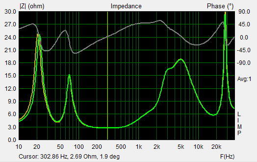

Measured impedance curve of both speakers:
The minimum impedance is at quite low 2.7 ohms at 300Hz as simulated, but with hardly any phase shift (~pure resistive load). Nevertheless, this is a speaker for modern Class A / B or digital amps that prefer to deliver current than voltage - less for tube amps....

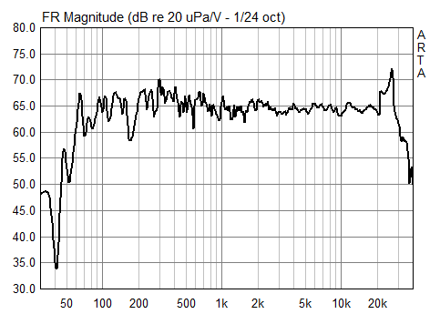

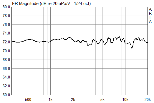

Here is another FR measurement (gated, without room influence) at a distance of about 80cm, mic just below tweeter axis:
Note the scaling....
In addition, I had noticed by "hand" that the plastic front panel of the DTX resonates at certain frequencies and higher volume. To counteract this, I applied aluminum butyl sheet to the back of the rear chamber and in the cavities at the mounting flange (see e.g. here https://www.speakerdesign.net/seas/tweeters/dxt/images/dxt_motor_coil.jpg); now nothing vibrates anymore, which has audibly calmed the reproduction somewhat and made it a bit more transparent.
The bass reproduction still slightly soft / spongy, which I put down to the very wobbly speaker stand. I have now ordered material cutting for new stands from mechanical engineering aluminum profile as well as spikes - goal is: as stiff as possible and thereby as little sound radiating outer surface...

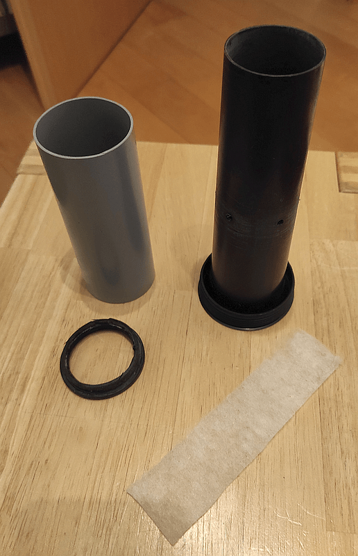

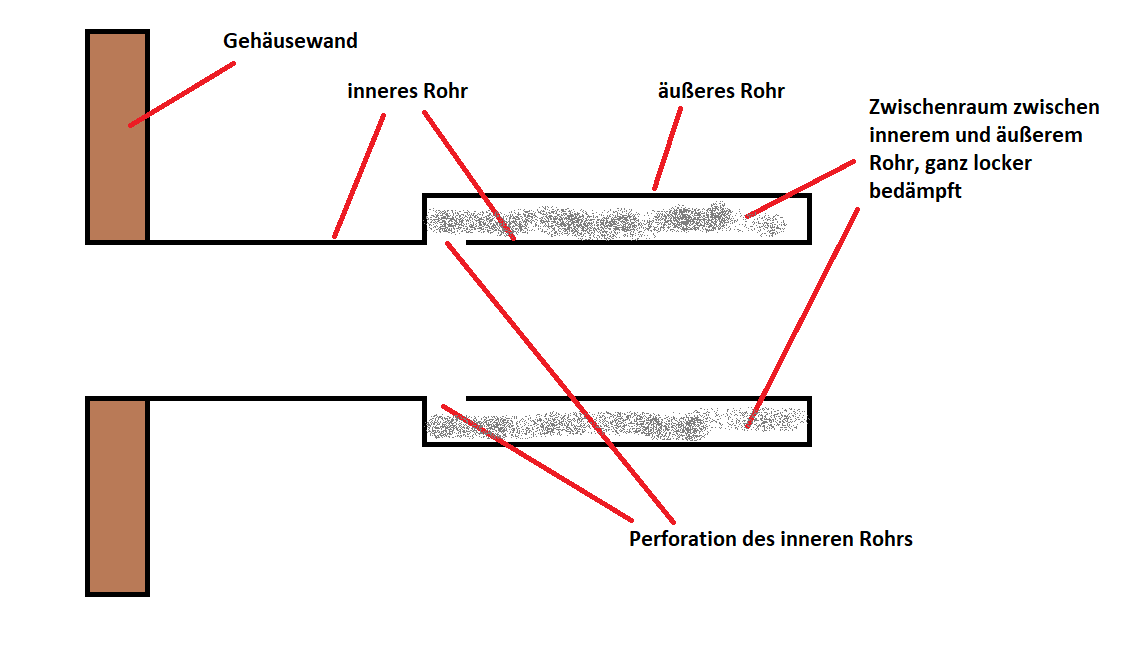

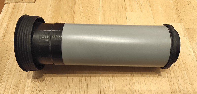

Tell me more about the port. Is there just a small gap between the port and the grey sleeve, and in the gap is that damping material? And the sleeve is sealed at both ends? It would be interesting if you could do harmonic distortion and chuffing testing of the this port vs a standard port. My experience is that HD and chuffing get worse and I haven't found a way around it. Sort of makes sense that these would get worse when there are discontinuities in the port wall, and a small air mass vibrating back and forth in the holes. I think this must create some eddy currents on the surface, and these eddy currents have been shown in other research to be the source of chuffing.
If I may, I can say something about it: yes, the description fits roughly. I had once made a sketch with MS Paint:
It's basically a kind of tube resonator, tuned to the frequency of the first longitudinal resonance of the bass reflex port.
First question: what does the term "chuffing" mean? My translation program doesn't seem to know it either.
Apart from that: I imagine that effect takes place on the resonant frequency of the tube resonator, but that the openings towards it behave relatively inconspicuously away from this frequency.
The alternative would be to make the BR port so small that the longitudinal resonance is outside the intended frequency range of the bass-midrange driver. But then you would possibly have severe problems with flow noise.
Or you could use a passive radiator instead of a port. But then the group delay in the bass is higher, because the high-pass filter formed by this would be of a higher order. In addition, this solution is also more expensive.
It would certainly be a good idea to make comparative measurements. In the end, however, loudspeaker construction is always a collection of compromises. :smash:

Thanks, Michael, for the drawing!
(Michael poited me to this idea in german diy-hifi-forum, so - thanks again, Michael!)
The idea is to couple a resonator to the pressure maximum of the half-wave-resonace of the tube to suck it's energy out. This is done by a quarter-wave-resonator which then has half the length of the tube. Alternatively a Helmholz-Resonator may also be used - or even a design which combines and adds both effects.
My solution is a quaterwave-resonator with some compromises due to the simple, pragmatic construction:
1. It's tapered from zero to ~2,7 mm annular gap
2. The inlet/boreholes are not at the beginning, but at ~30% of the length (length is approximatly equal to the vent tube's half length)
Of course the boreholes in the tube are a source of turbulence, but i assume the effect of chuffing is much higher at the tube inlets where is much more discontinuity?
I did no 1by1 comparison or distortion Measurements at the port. But after modding the vent I percieved no differences in Low frequency reproduction, but clearer mids.
Of couse the port is chuffing at very high excursion and frequencies below the tuning frequency, but you have to force it to make that audible (e.g. with "Amplifer - the Octopus" Track 5 - theres only infrasonic rumbling in the intro - and level then set near to woofers xlim). This was the case before and after applying the boreholes, could not notice that chuffing sets in significantly earlyer after the mod.
I also thought of a passive radiator, an 5″ x 8″ SB15SFCR-00 will fit very well in my simulations. But beside the increased group delay the much higher mechanical losses (Qm=2,7 vs. 10-15 of a port) will cost me some Hz and/or dBs at the lower cutoff frequency. As this is not a speaker to sound a party or home cinema, but relaxed "living room level" I decided to keep the port...
Best regards

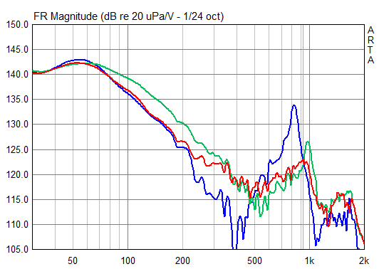

Basically one can use either a Helmholtz Resonator (notch) or a acoustic lowpass;
See; https://en.wikibooks.org/wiki/Acoustics/Filter_Design_and_Implementation
(there are better sources, but this is enough to show the idea and physics behind it)
Just some holes would suggest an acoustic highpass, although maybe some coupling with the actual cabinet might be happening.
"Just some holes" has the disadvantage that the boreholes couple directly to the cabinet. Tired this before the approch with the closed concentric resonator tube:
Blue: Without holes
Green: With holes open to the inner cabinet; The tuning frequency increases (virtual tube length decreases), and a lot of midrange dirt goes through them.
Red: With holes, but tube is wrapped with isobond acoustic felt + Gaffa Tape; a lot better, but the mechanical losses of the port are increased and so the output level decreased by ~ -1dB.
