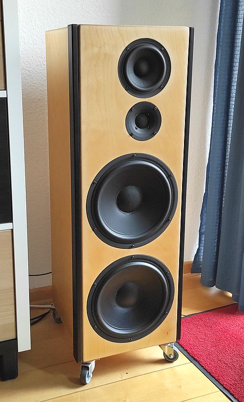

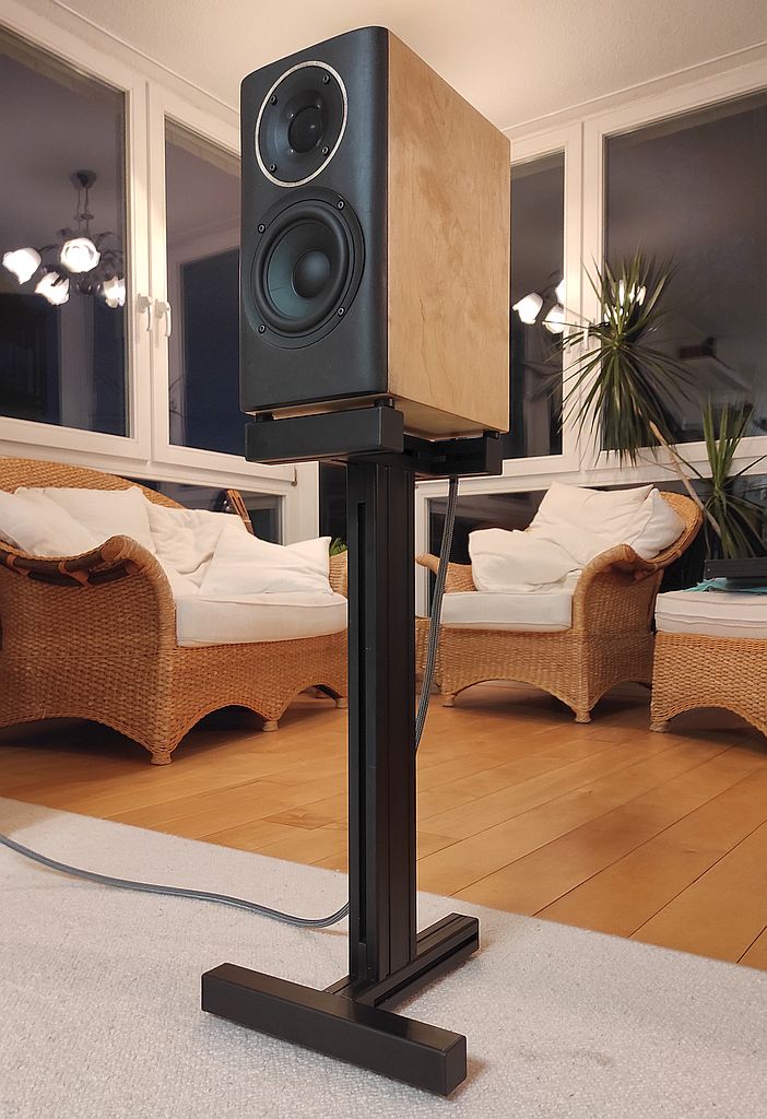

Edelstoff | SEAS 27TBCD/GB-DXT | SB Acoustics SB15NBAC30-4
Well this is actually MkIII, so we're talking about MkIV.... ;):LOL:

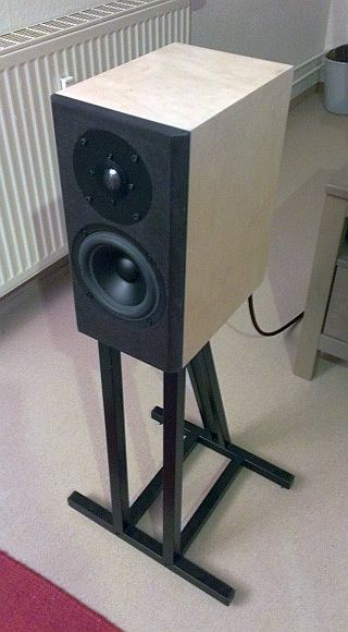

This was MkI about 8 Years ago:
attachment.php
I'm not a fan of MTM / D´Appolito arrangement, but a little 2-1/2 Way TWW-Floorstander is a nice idea...
If you allow it to be a bit larger there are other options:
attachment.php
Best regards
Peter

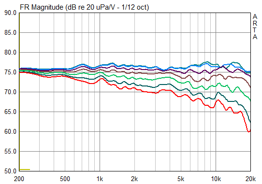

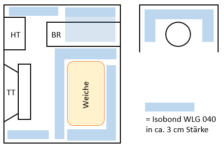

Here are some final measurements (Speakers on Stand + Chair underneath = @half height of my living room, gated, ~1,2m measurement distance, measurement axis ~2cm below tweeter axis, without turntable/different angles adjusted "free hand"):

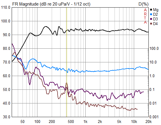

Distortion @ ~94dB (Measurement distance 33-34cm, Mic Preamp Gain -10dB so the displayed SPL is roughly correct):
(The high k2 comes from my measurement chain, probably the mic)
The little resonance @400Hz matches no geometric dimension (much too low frequency), I assume it comes from the woofer's spider or memrane tumbling.
The speaker is sensitive to stuffing of damping (too much = thin sounding fundamentals, too less = boomy), this is how it works well now:
(German "Weiche" = Xover)
Best regards
Peter

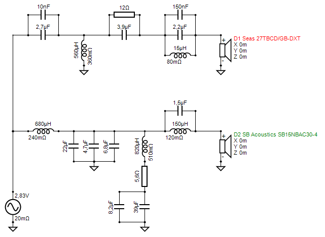

The 150nF is shown separately because it is intended to be a separate component... if it were there for the adjustment of value it would not be shown separately on the schematic, but instead left up to the builder to measure and adjust as necessary.
Bypassing capacitors with smaller ones is a technique used at radio frequencies where a larger capacitor package has sufficient inductance that it self-resonates at a lower frequency than is wanted... and bypass capacitors are chosen to reduce the reactance at higher frequencies.
Reactions: 1 user
As far as I know, Peter mainly used crossover components from his own stock and often combined the necessary values from two components.
The 150 nF capacitor belongs to a series notch filter, which is tuned to the breakup frequency of the tweeter. You have to aim pretty precisely, I imagine. So the small capacitor is probably there for some fine tuning.
Kind regards
Michael
diyAudio Moderator
Joined 2008
That is a fair comment about narrow band filters being sensitive to tuning. The circuit was drawn with the help of vituixcad so without input from Kwesi, I'm having second thoughts about my comment on what is standard, applies in this case.
Thanks Michael, that's totally correct, the tuning is very sensitive due to the high Q of the tweeter breakup resonance and so the filter!
Also that I've taken components from my stock, and the xover drawing was initially "for me" also for planning.
The 10nF in parallel to the 2,7uF of the tweeter path has no function but is some "snake oil", wanted to try a little silver mica laying around here....

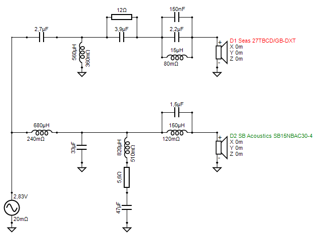

Here is the simplified schematic with the same functionality:
Best regards
Peter
