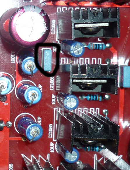

In the first version of the this board near the regulators analog power DACs has the capacitor 0.1uf. Very strange, but this capacitor has only one regulator? I can remove the capacitor, or need to add two capacitors to other regulators?
I learned how to make the ground trace a part of the board where the op-amps. There are two ground trace, one ground trace ends on the regulators LM317/337, other ground trace is only for op-amps. This is the proper organization of the ground trace?

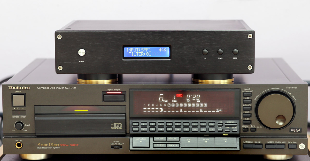

Dual AK4399/ AK4118 finished
I have finished with this DAC kit, the new device earning his place into my main audio system.
I manage to implement it like follows:
- two separate mains PCB capsulated EI transformers /digital and analog were separate
- mains filter inside IEC chassis mother plug
- soft recovery rectifiers diodes on analog section PSU (BYW27/200)
- ELNA Silmic II caps for the analog PSU
- Panasonic FC for decoupling the +/_ rails of the OPAMP
- small caps around the OPAMP (part of the output filter build around OPAMP) - Siver Mica
- all decoupling caps in digital section replaced with os-con type, Panasonic SEPF series
- RCA coaxial PCB plug replaced with isolated panel BNC
- original opamps changed to LT1360 with incredible results. Results are stellar !
I have write a small post on my webpage, and few pictures regarding this project, here:
attitube: Dual AK4399 / AK4118 DAC
(I am not selling something on my website)
I am really happy with this kit the way I have finished, and I want to thank to all, but especially to nino-simona, terranigma, valeri100, kukynas, sunsun22, pinnocchio and those I don't remember for their kindness to share all their experiments in tuning/modding this little double head beast !
One should spend many more money to obtain similar results. I have tested/listened dacs with PCM1704k dual, AD1955a dual, PCM1794a and dual WM8741, and none convinced me like this AKM based kit. For a proper implemented ESS9018 (Twisted Pear, for example), one should spend at least double to get the juice out of that chip.
This kit sounds Natural and Relaxed, like Bob Marley after a recording session for the Exodus disc :)

el156se: Thanks for sharing your findings with us, I enjoyed reading your blog post, congratulations with a successful project! That cd-player is nice, must be a great transport too.
magicwolf: The 100n capacitor isn't needed, it's bypassing the output cap of one of the analog +5V regulators. I think the designer forgot to draw another one for the second regulator, but they aren't needed anyway.
Your second question isn't understandable to me. In general grounding must be star type, to avoid ground loops. The opamp grounds must connect to that point, but also the grounds of the RCA sockets must connect to it with a dedicated track. Maybe you can clarify your question with a picture.
