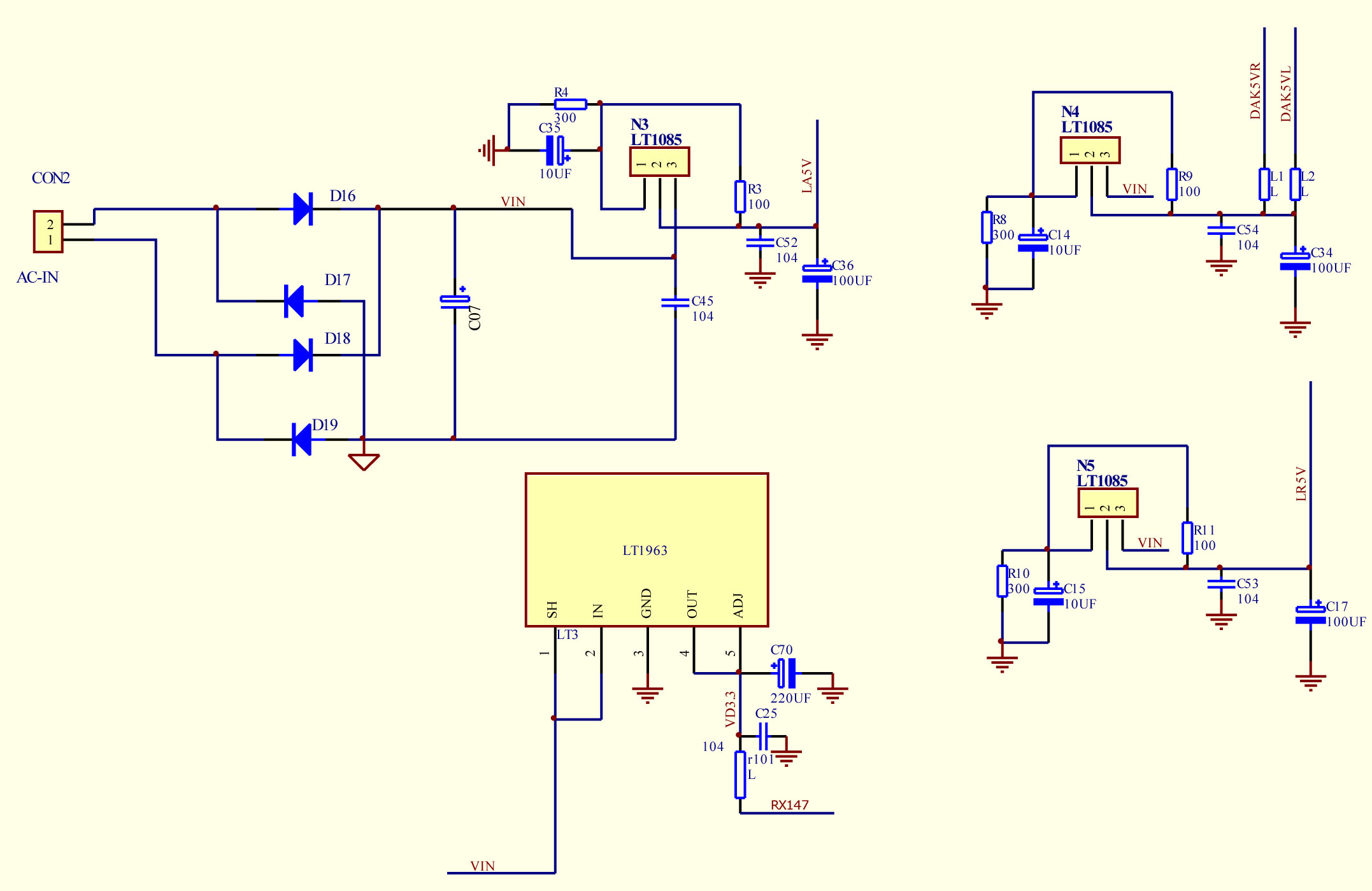

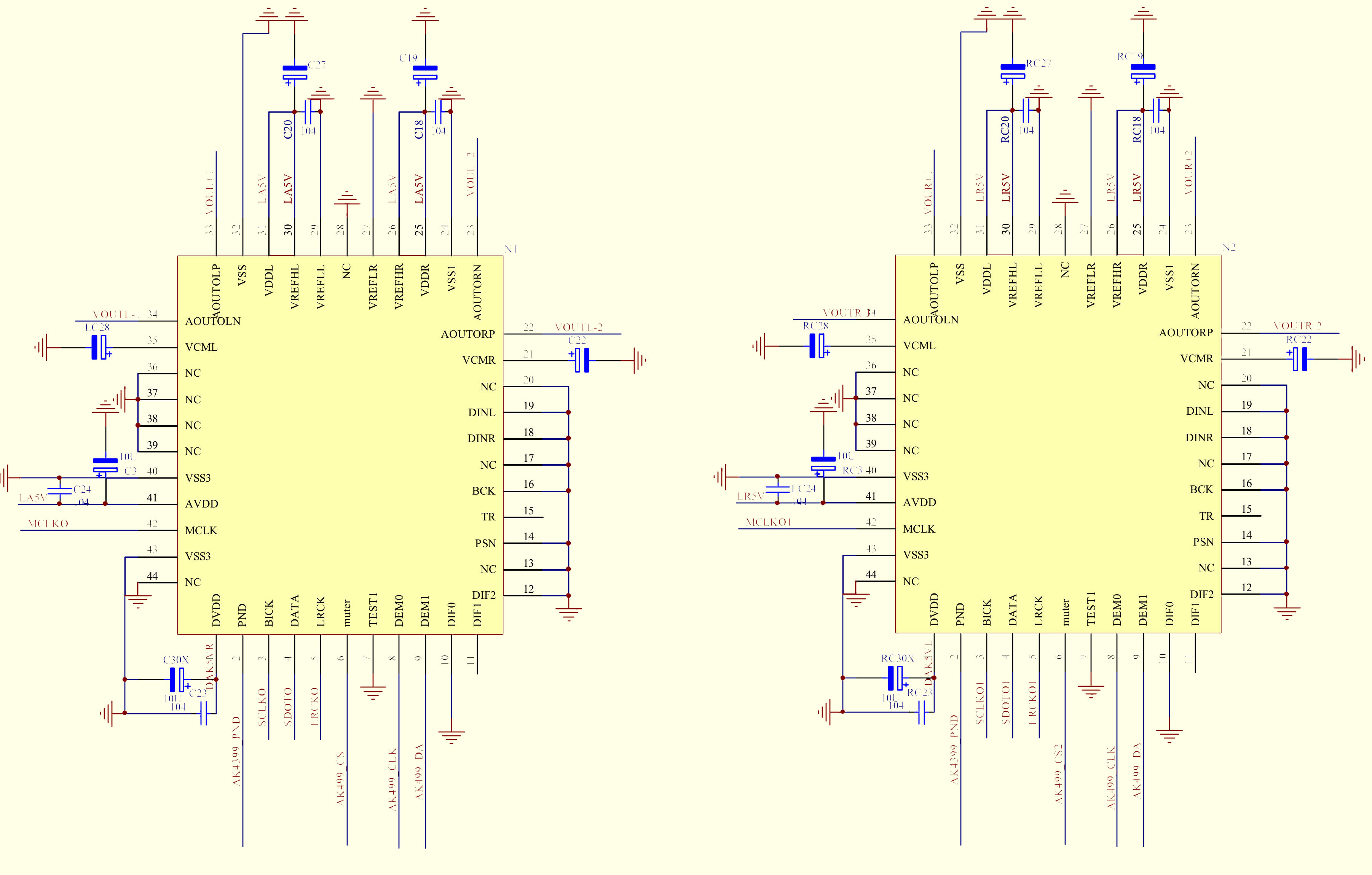

magicwolf: The 100n capacitor isn't needed, it's bypassing the output cap of one of the analog +5V regulators. I think the designer forgot to draw another one for the second regulator, but they aren't needed anyway.
Thank you very much! I understand you. But in the second version pcb (ak4399&ak4118, see "4399V2-lt1085.jpg") use all three of the capacitor. As I understand you removed the capacitor, but I can add the missing two capacitors 100nf in parallel capacitors 100uf. As I understand it, they do not really need. But the worst of them will not. Important that they were all or not. Thank you!

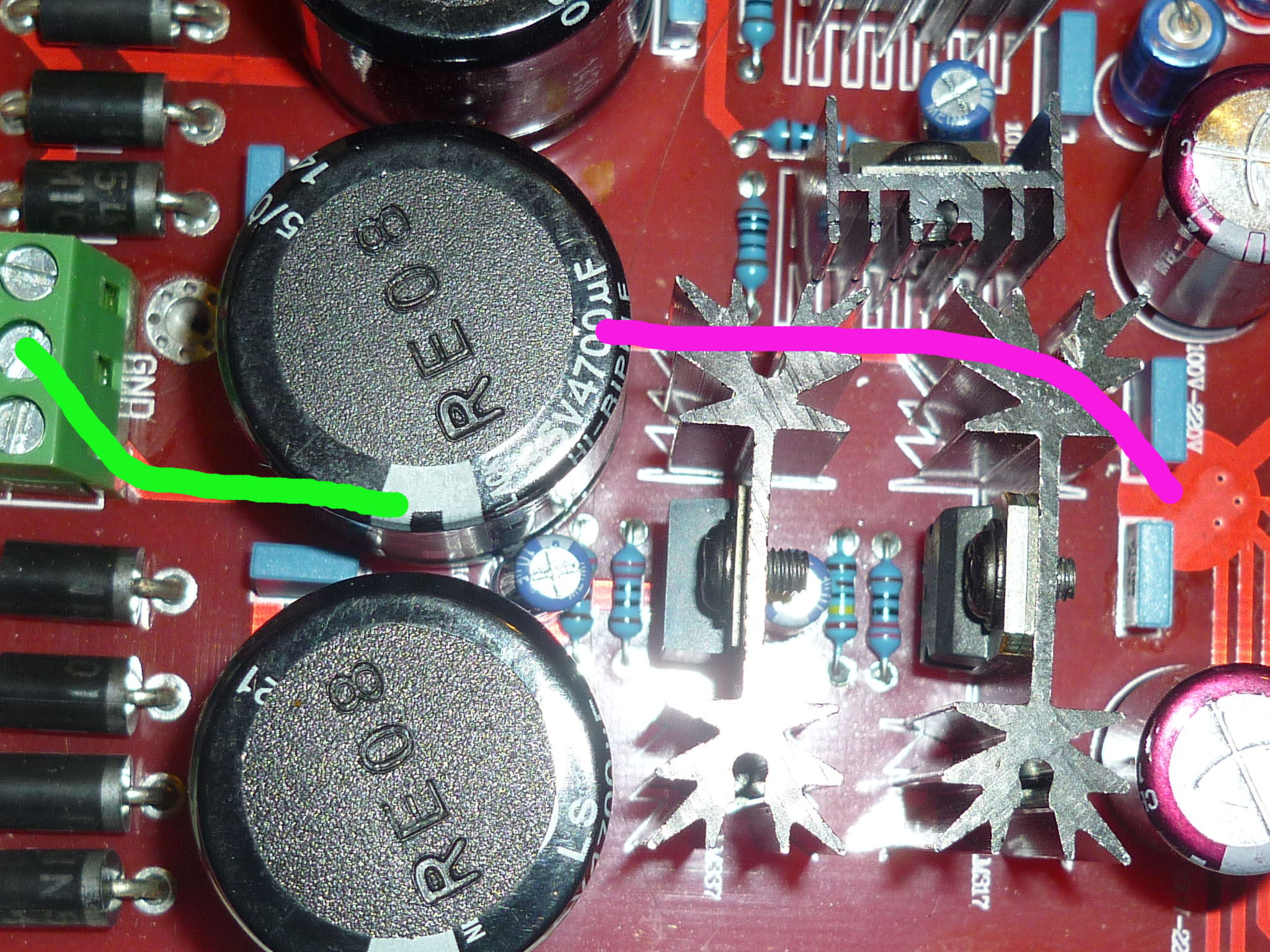

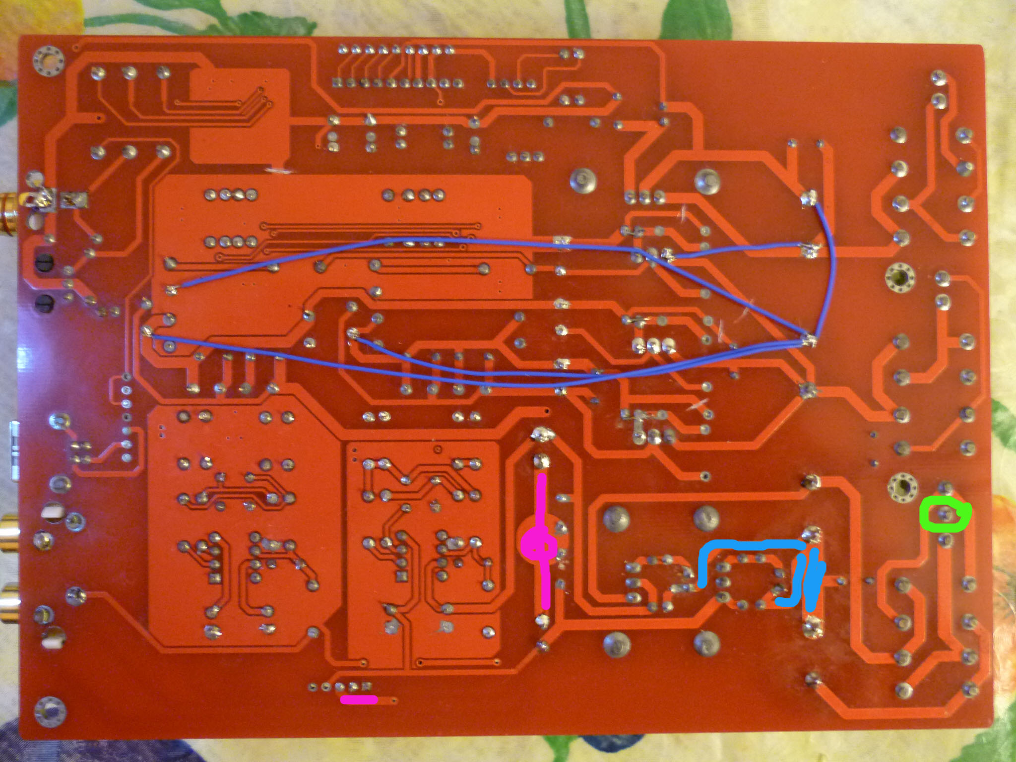

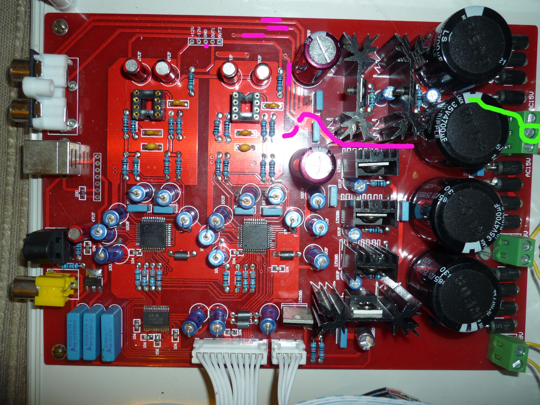

The pic ground1.jpg green line marked by grounding trace that starts from the transformer and ends at the two capacitors after the diodes. Purple line marks the grounding trace that starts from the two capacitors are used for op-amps. In pic ground2.jpg blue line indicates the grounding trace that used to lm317 / lm337. Grounding trace indicated by the green line is connected to the grounding trace indicated by the purple line after about two capacitors diodes. Pic ground3.jpg shows the grounding trace for the op-amp.
You can see clearly on the pictures that star-ground is used. Two RCA return tracks to star ground and each channel's opamp have their own traces the same star point.
Given the current design, I don't think ground tracks of analog stage psu can be improved. The blue tracks, from regulator adjustment circuits to ground, are going straight to the smoothing caps. Ideally they would connect to the star point , but indirectly they do because of the relatively short purple track on topside of the board.

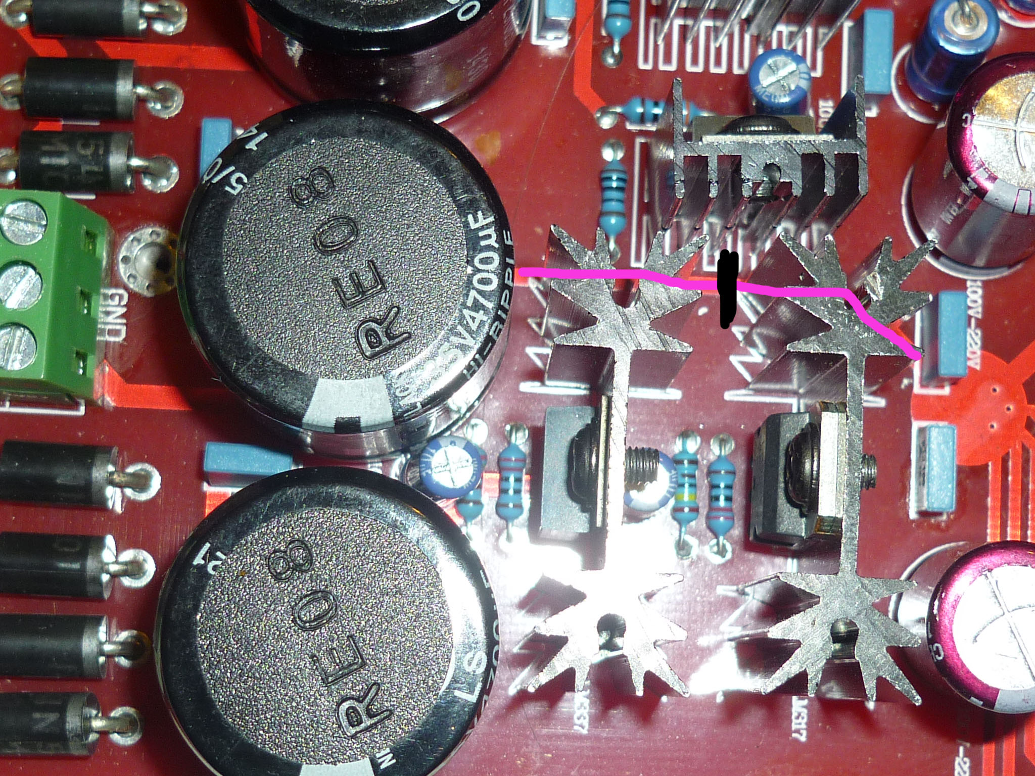

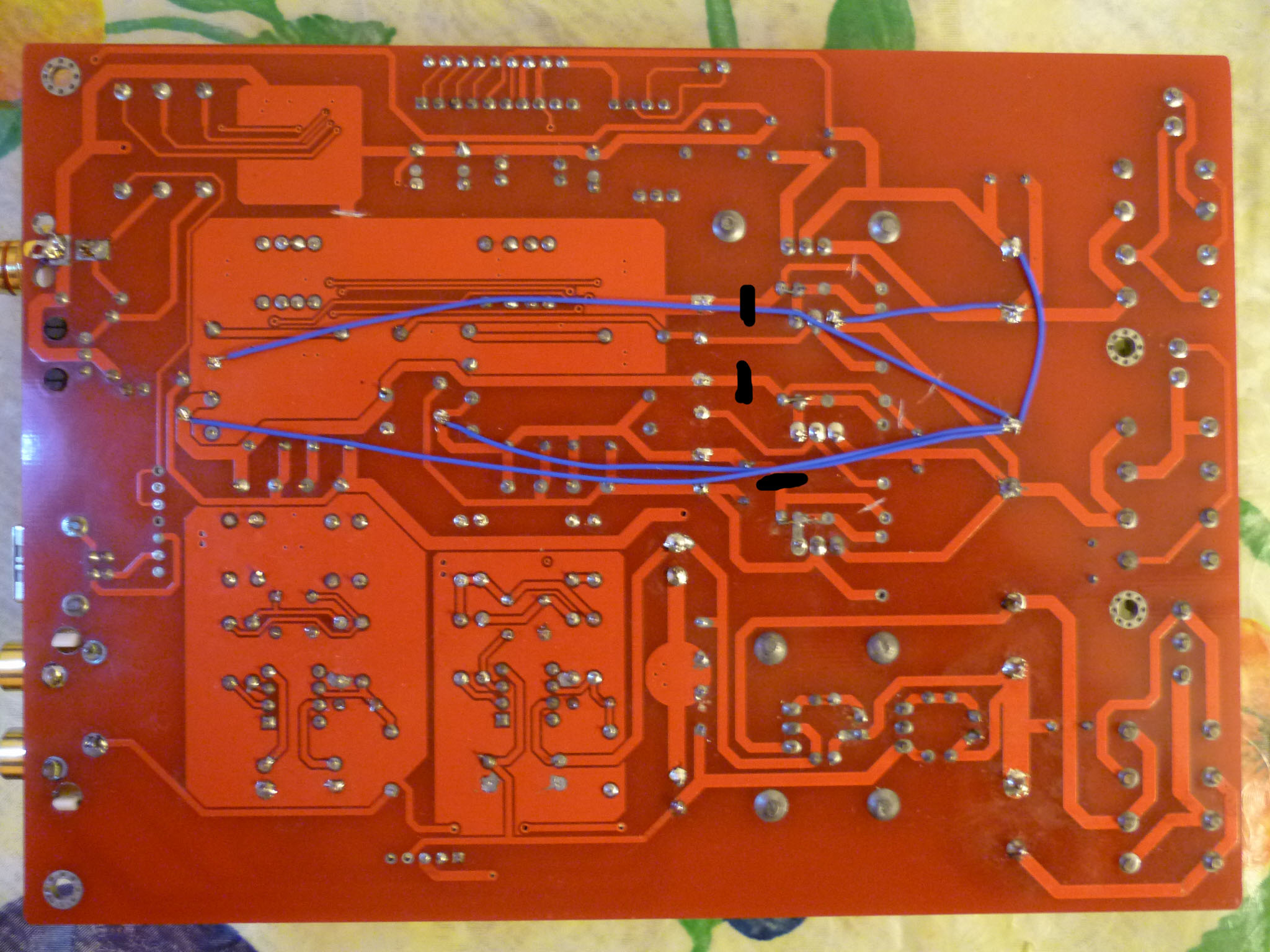

Thank you very much! May also make the grounding trace a power DAC? Cut off the ground after regulators (marked in black, see cut-groud-dac.jpg).
IMHO, possible in the analog stage psu cut off pink grounding trace and ground RCA socket connected to the ground after two large capacitors diodes (see cut-groud-psu.jpg). It will be right? Or pointless?
You're welcome .No, this first option won't work. If you do those black cuts, the regulators won't have their ground pins connected. The whole point is to make this pin sense the ground potential at the load side, for better regulation.
As I said, I see no point in changes of the ground tracks in the analog stage.

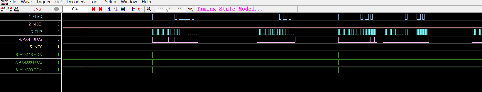

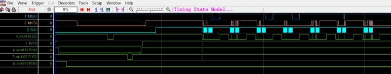

my logic analyser is here, I have tested it with the original and the Arduino controller.
The start-up sequence of the Aurduino controller looks like this (sample rate is 250 MHz)
http://www.diyaudio.com/forums/[url...ata/500/thumbs/Start_Sequence.png[/IMG][/url]
The first 3 SPI commands of the AK4118 look like this
I do not see any problems. These commands are specified in datasheet, but the receiver has no lock.
I think that the very short changes of the low/high state (for example of the AK4118 CS channel) are the ADC Errors. The original controller has this "switches" too.

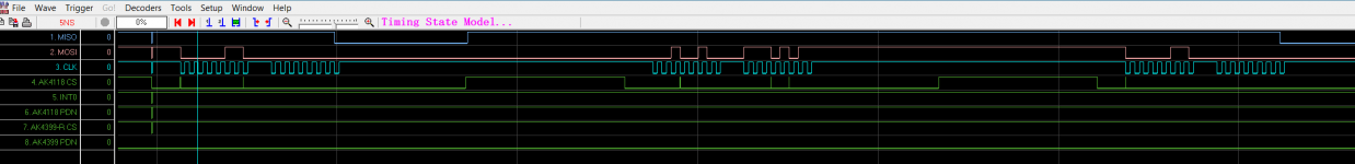

Hi pca01,I think that the very short changes of the low/high state (for example of the AK4118 CS channel) are the ADC Errors.
Thanks a lot for testing the start-up sequence. On the second picture, the magnified one, the spikes are only on the CS line, not on CLK or MOSI lines. So I don't think it's ADC errors of your analyzer, the spikes on the CS line are likely to be the cause of your DAC controller not working. When state of CS line changes during transmission, the sent/received byte isn't valid. The CS line only suffers from the spikes. What pull-up resistor value does it have? My DAC has 4k7 resistors on each line.
You could also try to add a small cap across ground and CS line, to filter the spikes.

I think it is not a problem of the DAC controller, but it's a problem of this analyser.
The original controller has the same spikes, but it works.
I have found in the internet the same descriptions and screenshots from other peoples. I have already buy an another analyser (from Zeroplus) and would like to return this analyser to seller.

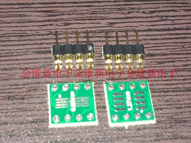

One idea is to put the MС7806, and then they can lt1763 5v & 3.3v . In place of the ferrite and near the chip. On this adapter.
730user, For what?
Improve the power supply circuit. As here.

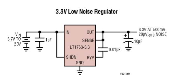

"5. The use of Class A discrete analog portion of supply Toshiba sound supervisor C2240 / A1930 composition.
6. Low voltage, digital, analog circuit using LT317 and LT1763 regulator ultra low noise, and each functional component has independent regulator supply."
I will be compiled lt1763 apply to both digital and analog power DAC. I will Lt1963 + lt1763. Separate stabilizers digital and analog portion of each chip ak4399.
