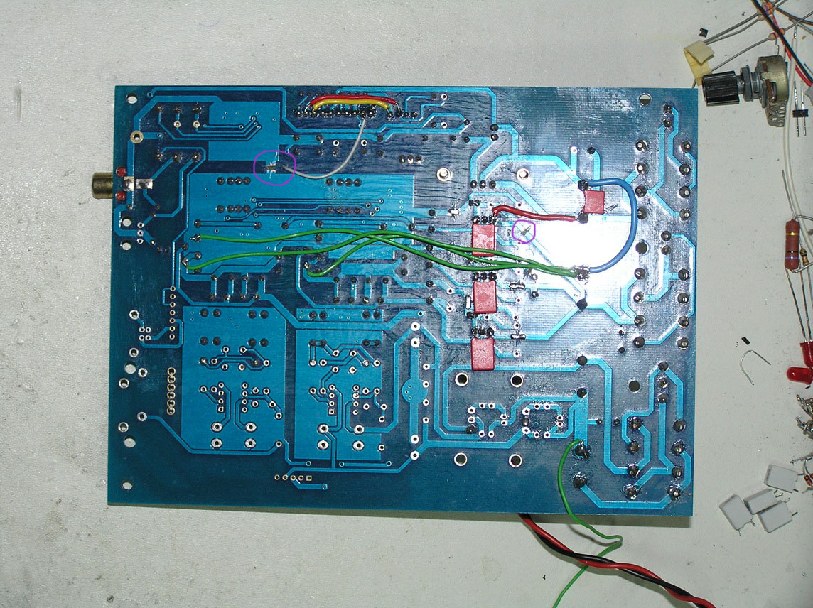

The analog and digital +5V of both dacs is supplied by the 3 regulators and share one smoothing capacitor and rectifier group. There's quite some current needed, max 90+ 90+140 = 420 mA. I decided to try and relocate the 140mA digital +5V supply and connect it to the other group, supplying the AK4113 and MCU, to decrease the loading of the group and have better performance on the important analog +5V of both dacs.
Because of an earlier experiment, I already changed the smoothing cap of the digital group to a 10.000u/25V Elna LAH capacitor. I don't think it's necessary to change if you are using 8200u Elna for audio. But I did anyway.
I had to cut the track to the input leg of the digital +5V regulator, originally connected to the same capacitor as the analog +5V regs, and attached a wire from the regulator input to the other group's capacitor (the 10.000u, red wire in the picture).
Next the bad grounding needs to be solved. This dac version 1 has the (analog) ground plane of the dacs connected directly to the (digital) ground of the AK4113 and MCU, which isn't according to datasheet recommendations. When the digital +5V of the dac has been transferred to the other group, this bad grounding will lead to distortion in left channel of the dac. To avoid this, I separated AK4113/MCU ground with dac ground plane, and connected both grounds at the supply side by connecting the - of the capacitors of both groups with each other (blue wire). You can see the rectangular ground plane of the AK4113 at the top of the picture, being cut from the bigger ground plane of the dacs.
The green (ground) wires are the main ground/return connections of the regulators, as a result of the regulator grounding mod I described earlier.

In figure 17 on page 35, you can see that also DVDD (digital +5V) is decoupled to analog ground plane of the AK4399. So for the AK4399 analog and digital supply are separated, but their currents return to the same analog ground (VSS1-VSS4).
The design problem is just the location where the (digital) ground of the MCU / AK4113 and the AK4399 ground plane are connected. By cutting the connection as I indicated, return currents are forced to flow back the correct way, without disturbing the dacs.

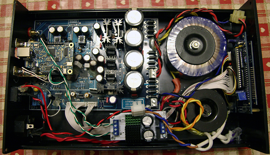

Hello to everybody,
i managed to replace Weiliang poor XMOS using a Jlsounds I2SoverUSB board, connecting it via SPDIF instead of I2S. I used a small 2x6V transformer and a dual TPS power supply as support.
Here you can see a picture:
At first i tried to connect USB input of Jlsounds board to USB input of the DAC (using Weiliang XMOS connector), but the board is not correctly detected by my PC that way - so i had to make an hole in the rear of the DAC to allow direct USB connection to Jlsounds board. Output from Jlsounds board is via SPDIF, directly connected to Weiliang XMOS connector, so this remains an USB input that AK4113 can manage.
The resulting sound was really rich and a bit middle-bass oriented if compared to coaxial input, but that's normal as coaxial input trace has an high-pass CR filter, USB input trace doesn't (it seems to have a very small RC filter, that i bypassed).
So i implemented a small and simple CR filter (0,1 uF MKP + R 75, same as coaxial input) for the SPDIF connection from Jlsounds board to Weiliang XMOS connector, and sound opened up as coaxial sound does.
SQ this way is a bit better than coaxial input, but a bit worse than I2S connected XMOS i tested some posts ago. But it's high enough for my needs and much less complicated to manage, so i'll stay this way. .. :p
Just remember: straight SPDIF connection to Weiliang XMOS connector: richer and warmer sound, less controlled bass; connection via CR filter to Weiliang XMOS connector: more open sound, more "live" effect, less powerful; connection via RC filter: BLEAH!

It's true, we're talking about digital signal. But that's the real effect: i had another person (not into audiophility) to listen, just to be sure, and he confirmed this sound difference. In facts, that's really easy to listen: it's a neat difference.
More, if you have a look at DAC schematics, you'll clearly see what i say is true: coaxial input has a small CR circuit, and so does optical input (with different values). USB input doesn't (to be honest, it looks to me it has a small RC circuit instead, that's not depicted in the schematics).
I'm not able to explain how this works, but it does...
