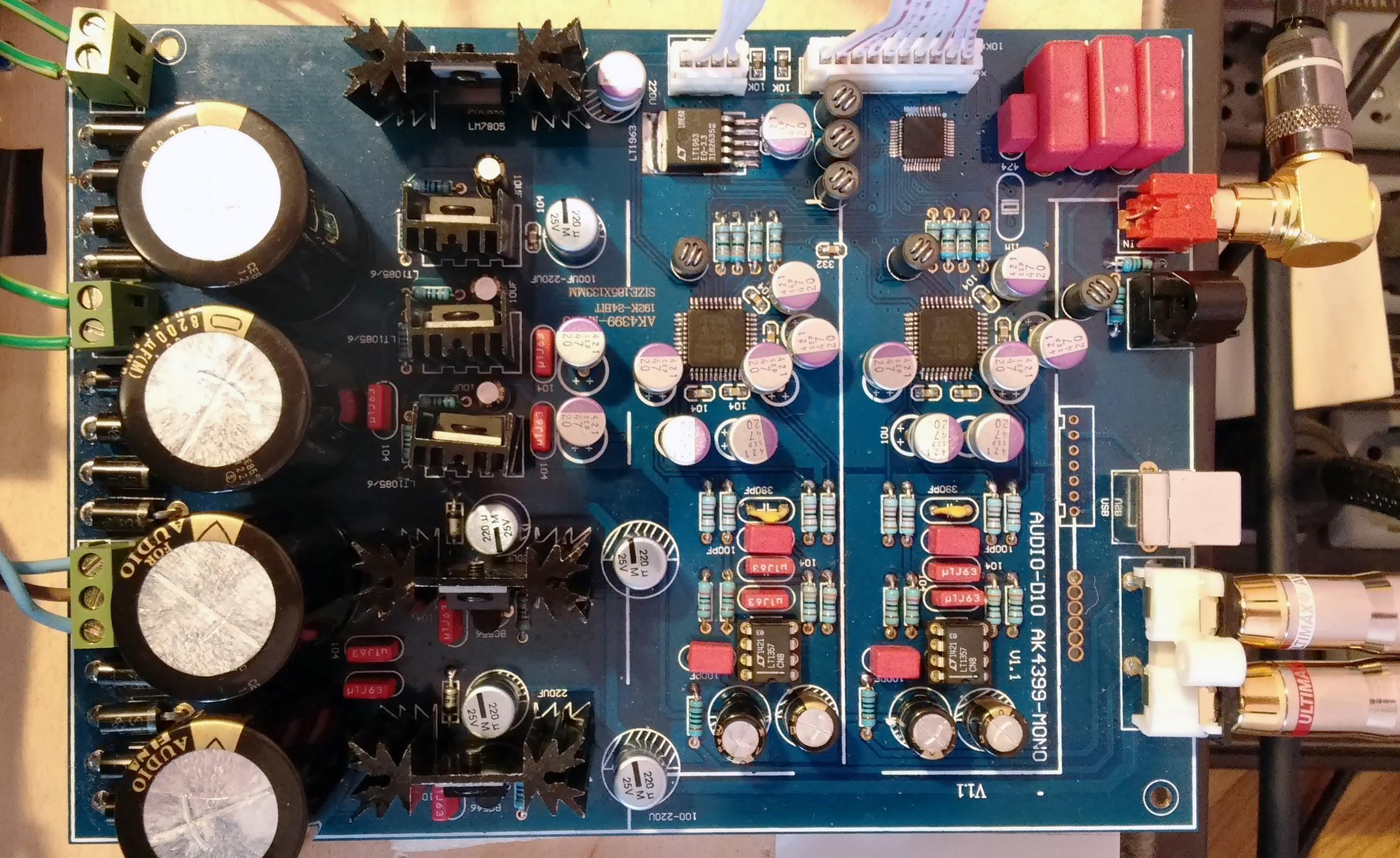

On my version II board (with ak4118) I managed to change all the decoupling caps for the dac and receiver chips with Panasonic Oscon, SEP and SEPF type from Farnell. Also, I have made tests with the output op-amps, testing Burr Brouwn OPA134 PAG4 and Linear Tech LT1357CN8, both in DIP8 package, both fake-free.
Before to change the caps, OPA134 sounded more balanced, with plenty of bass and laid back character (highs well controlled, not on the exuberant side - maybe not the last word in transparency and 3d).
After replacing all ERO labeled caps with oscons, the best IC choice seems to be the cheaper LT1357CN8, to my surprise. The SQ gained extension in upper and lower registers, as well as in speed and transparency. Lower registers of the organ on the_Symphony No 3 in C minor - by Camille Saint-Saens/ Eugene Ormandy - conductor_ (Sony Classical) sounded in a way I never dream-off in my rig!
I could state, on my opinion, that this version II dac is a marvel 'out of the box', for the spent bucks. Changing the decoupling caps give a minor (but welcomed) change in SQ, compared to the change of the output IC, if one think at the investment difference.

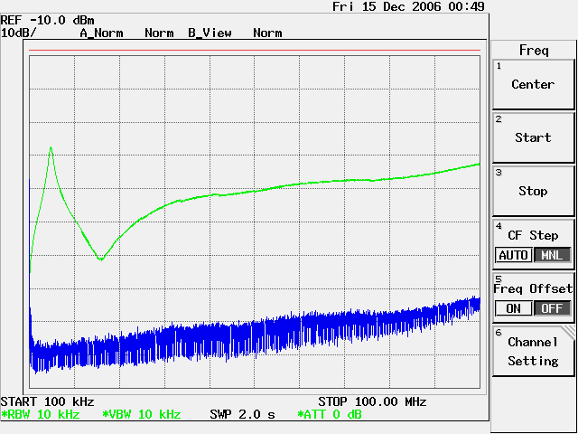

Guys...
Stop decoupling power lines without scope....
Oscon SEP or SEPC (47-100uf)paralel with 104 ceramic one...is *oscillator* at 80 or 150khz
Green line is oscon 100uf in paralel with 1206 x7r 100nf ceramic cap
Blue one oscon 100uf in line with leaded 4 turns ferrite paralel with 1206 x7r 100nf ceramic cap.
You can see at 150khz 60db difference in noise attenuation.

That's true about bypassing oscons, they don't like it.
