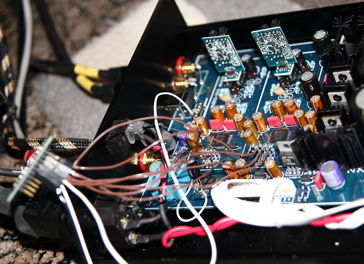

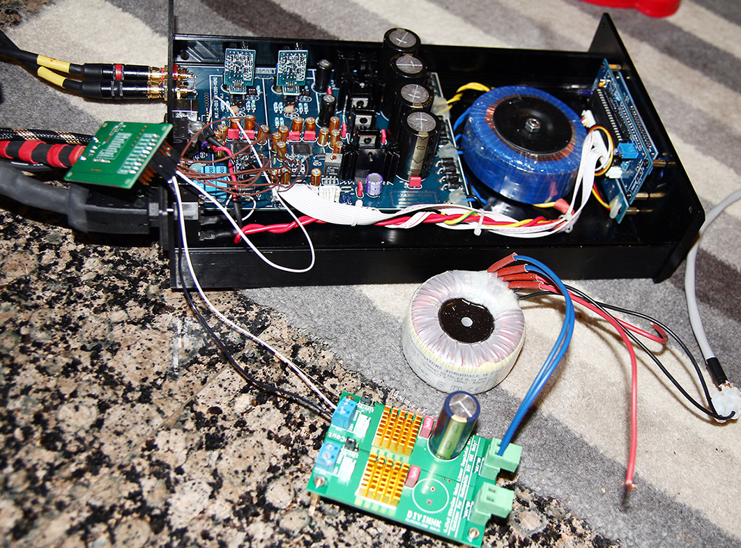

Good news guys, finally i managed to test I2S input using this Diyinhk XMOS interface: Isolated XMOS DSD DXD 384kHz high-quality USB to I2S/DSD PCB with ultralow noise regulator - DIYINHK
Results were a bit a see-saw but all ended reasonably well.
At first attempt i connected I2S outputs from XMOS interface to the 8 resistors shown in post #525, but i got only sparkling sounds without any sense. Connecting my Raspberry PI was a useless attempt due to the lack of MCLK.
At second attempt i added DGND connection from XMOS interface to DGND in the Weiliang XMOS connector on DAC PCB, leaving SPDIF and Toslink cables connected (if i remove SPDIF cable no sound at all - DAC only sounds in SPDIF input mode).
Eureka! Good sound out! But still a bit sparkling playing 24-bit files (strangely enough), clean sound playing 16 bit PCM or 32 bit DSD files.
Then i disconnected Toslink cable and... miracle! No sparkling even playing 24 bit files!
Sound is just amazing, very rich and powerful but very open and clean, with very good and natural highs, quite a bit better than a good SPDIF input (even if I2S cables are nearly 15cm long).
Occasionally some sparkling starts again after switching the DAC on, but i simply have to plug/unplug Toslink or SPDIF cables to stop the noise: no doubt AK4113 mode signals to DAC chips are to blame. But i can easily stand that...
Just a piar of pics to show the test setup (don't mind bad solders, that was just a test...):
Next step will be implementing a multiplexer I2S switch to allow the use of SPDIF and Toslink inputs as well...

I had to connect I2S signal GND from XMOS board to DGND of Weiliang XMOS connector to get rid of most of the scratchy sounds.
I didn't remove the Weiliang MCU, but had to keep SPDIF cable connected to the DAC, otherwise i couldn't hear anything; i connected Toslink cable too. I only could get the sound out in SPDIF input mode.
Files of certain bit depth (mostly 24 bit, that's strange) kept producing little poppy sounds, but unplugging Toslink cable did the job; the cable had to be connected before the bad sounds started to pop, otherwise i couldn't stop them.
More, i don't think feeding the USB board using DAC's 3.3V is a good idea. I used a separate, small low-noise linear regulated power supply from diyinhk, with its own thoroidal transformer. Sound was really good!
