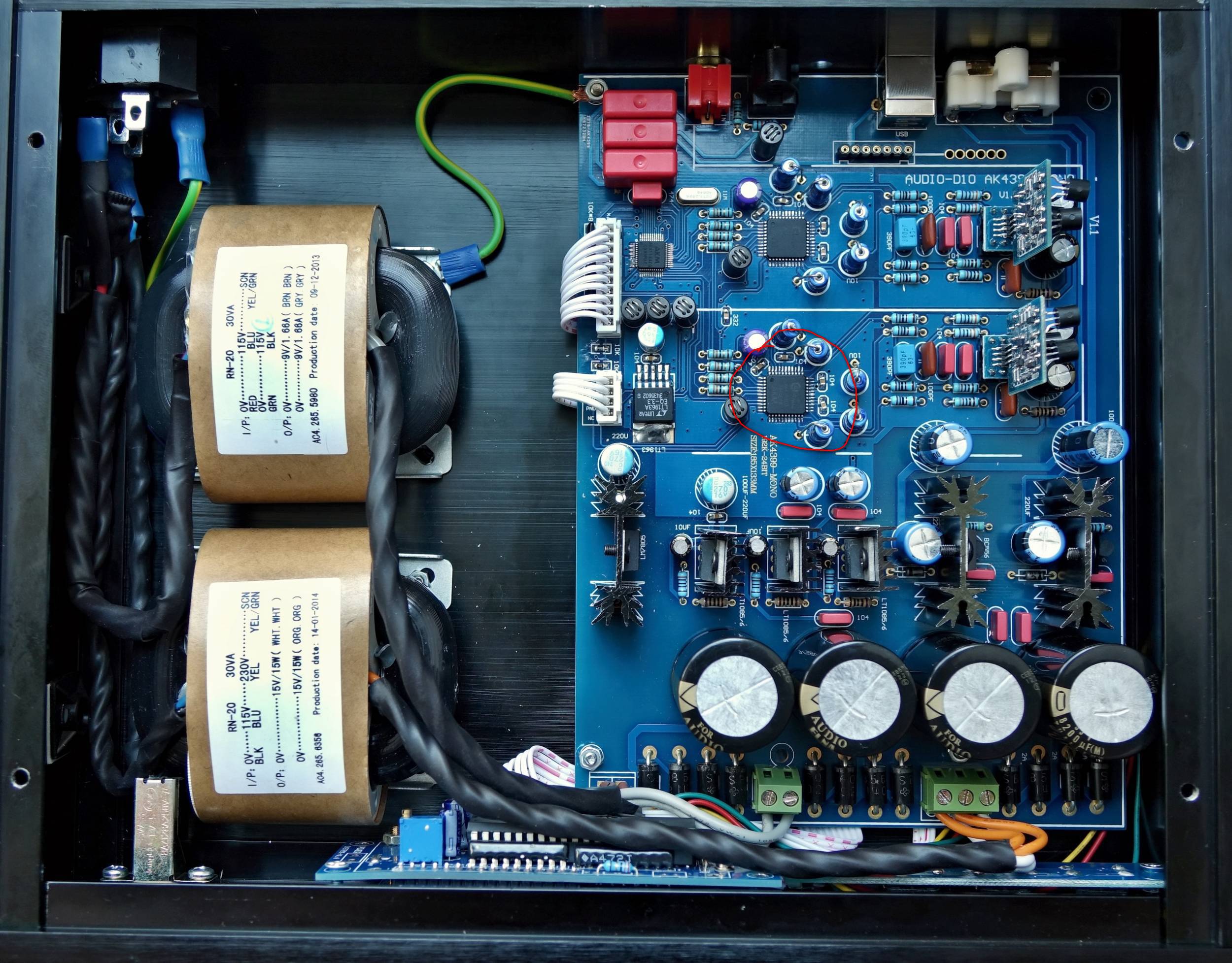

Guys! There is a small problem. When replacing I probably brought down stabilizer. Сhip DAC shown on the photo on the voltage VDDL VDDR AVDD - 1.2V. On the other DAC - about 5V. Which of stabilizers has failed?
