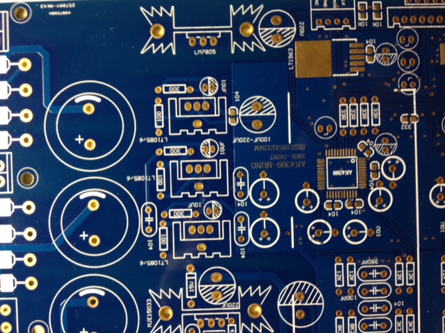

Did you check analog supply voltage of chips? Since the chips supplied separately, probably one of regulators got out of 5V.
Hi terranigma,
Thank you for a good advise. No I did not make yet good troubleshooting. IT is planned for tomorrow when I will have oscilloscope.

Excessive load on analog outputs warns with highly distorted sound at first, thus imbalance of sound between left and right. If you didn't observe such thing, you have to check voltages on both analog and digital supply pins of both chips before replacing the dac chip.
Hi Valeri100
terranigma made some good points
I checked your pictures. I think the adjustment pin capacitor of analog +5V regulator for left channel has wrong polarity. It's the small 10uf cap of the middle regulator. Please check that regulator and cap.
edit: sorry, it's correct in your version
Nino

It seems that one AK4399 is out of order. Output voltage is +1,8 V on VoutL-, VoutR-, VoutR+ which is not normal (must be +2,5 V) and + 2,5 on VouL+. I have checked that all 3 LT1085 regulators provide +5 V on its output.
I did not checked it on AK4399 pins due to small size of pins and small distance between pins.
I was not sure that I could put oscilloscope probe exactly on pins without short cutting 2 neighbor pins.
I think the described measurements lead to conclusion that AK4399 is faulty. If you don't think so please post your opinion. I'll appreciate it.
I thought that was obvious due to brownish color of dac in question, if it is not something else than burn.
Maybe the IC has died because some loose little chip of solder came between the pins...When I received my assembled PCB, I discovered some little solder threads/spots on the board, due to sloppy soldering. So I carefully removed them, to avoid damage to the components in case of coming loose.
If you are going to solder the new DAC, I would desolder the decoupling electrolytics around it temporarily , to have some more working space with the iron. You must prepare well, you don't get a second chance if the chip isn't aligned well on the pads. I use the aid of a lamp with magnifying glass for this kind of work.
