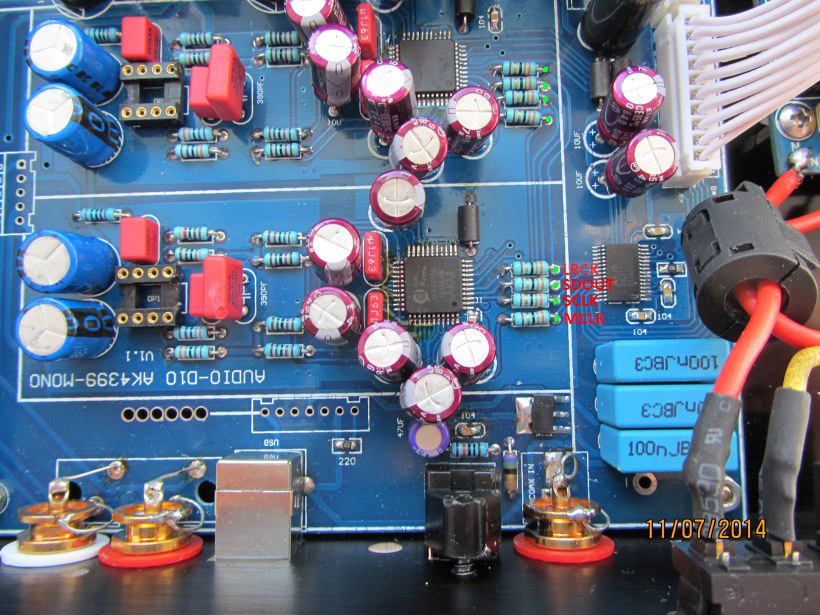

Hi Valeri100,
I'm sure that on the DAC PCB there's pins for mclk, dck, lrck, etc... This xmos module has to be connected using I2S, it would be stupid not to anyways. So there should be a GND, the USB data pins + the 5v and the rest of the pins should be I2S related... Just a wild guess of course... :D
Ciao!
Do
Hi Pinnocchio,
This Xmos board is connected via Spdif. It simply converts Usb to Spdif and not to I2S. I am sure about it.
This DAC signal is on the bus i2s.USB-SPDIF-I2S-4399. Can be mounted so that odoemene all from the receiver. 333.jpg
pinnocchio: no idea, I bought it just for better selling purposes, I've always used toslink connection where I do not have to deal with jitter at all, why would u need I2S connection if u got all standard connections available? u can always use I2S to spdif convertor if neccessary
Hi Guys.
I think the board converts I2S to SPDIF because this way the input can be selected with the AK4113/AK4118 receiver. The receiver doesn't accept I2S.
I2S is considered better, at least for short distances, because clock and data signals are separated. This way it's less sensitive for data related jitter.
kukynas: Toslink isn't a cure for jitter unfortunately. Jitter is a clock timing problem, which can even be worse when using toslink. Optical link requires the signal to be converted at both sides, which can cause further errors. It depends still on the receiver IC if/how these errors (jitter) are corrected. Toslink has the advantage however, to electrically isolate source(transport) and receiver (DAC), reducing noise transfer.

I2S connection
Hi NinoSimona,
Thank you very much. I missed the post.
My CDT is CDPro2 and has I2S output. Does this mean I can skip the receiver and connect the I2S output directly to the 4 resistors and a GND signal? In this manner, I think I have to lift the resistors from the PCB and connect the two corresponding resistors together. Am I right?
Yet, from my manual, I saw my CDT has different names in output pins. Does they corresponds to the names here
MCLK (MCLK)
SCLK (BCK)
Data (SDOUT)
LRCK (LRCK)
GND (GND)
The connection is short (about 50 cm). What kind of cable should I choose? Ribbon cable or Cat5?
