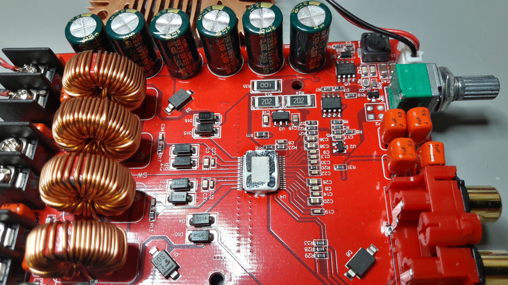

Are you talking about the reverse polarity protection diode? If I understand correctly, those diodes are to be shorted to make the power input capacitor more effective. Alternatively, I am thinking of a simple capacitance multiplier.
i am not really sure what you mean. i see it on the board that the upper layer seems to be shortet and if you measure on both pins of the diode you get an short.

He means the D8, it's pretty good visible at this picture:
653167d1514323995-ebay-cheap-tda7498-boards-20171220_thermal-fluid_1-jpg
Right bottom corner, D8.
My guess is that D8 serves a mechanical insulating purpose as a spacer. The rather large metallic heatsink is hanging not much above several SMD components. If the heatsink touches these components it may destroy the amplifier. And, the heatsink is riding on top of the small TDA7498E with only two elastic fixation points.
My suggestion is that D8 acts as an insulating spacer together with the two polarity diodes (that takes care of three corners of the heatsink) and one of the SMD components in the last corner.
Machine mounting of an extra diode costs nothing and D8 has a high (insulating) profile.
