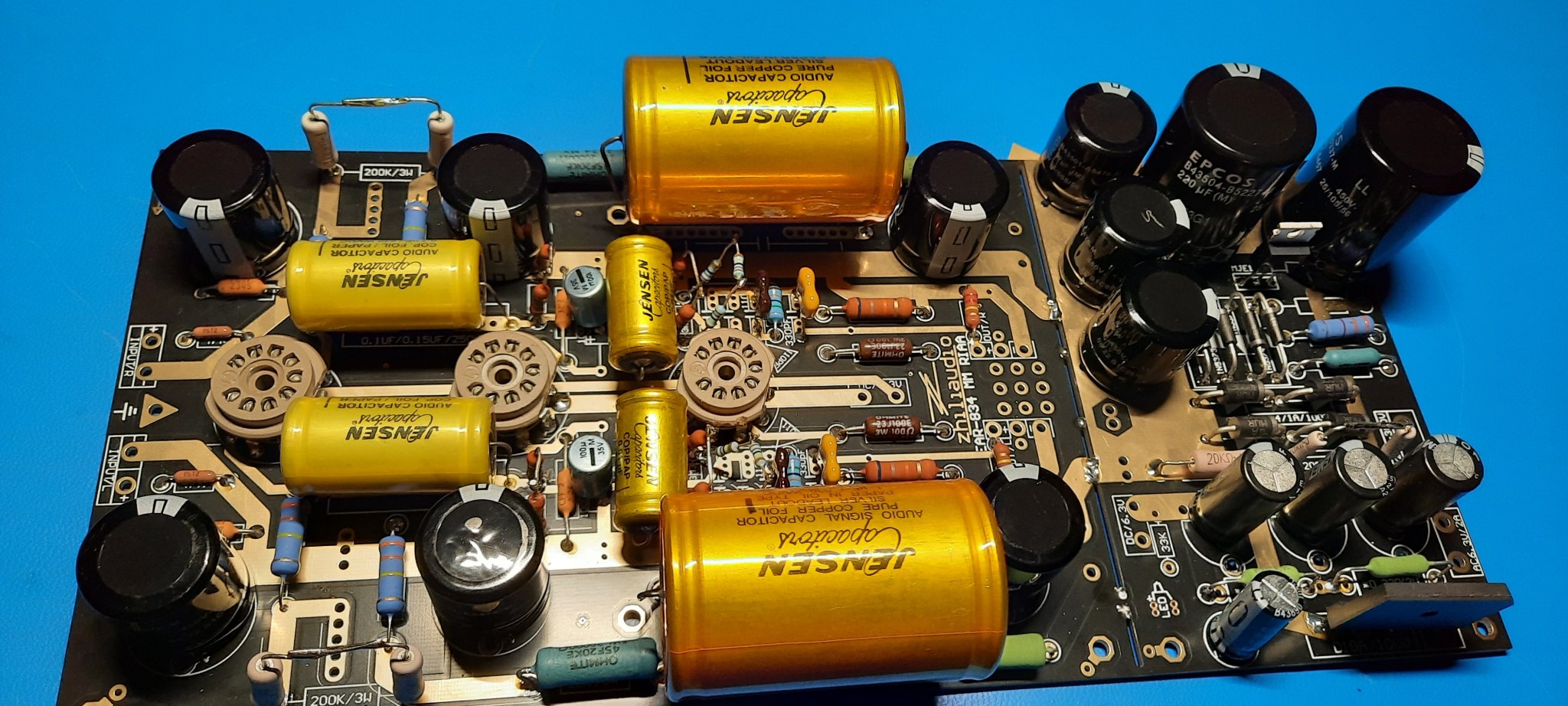

This shows the effect of observing proper orientation. Which way is which depends on the manufacturer and perhaps the specific model of cap but as I say it seems odd that they chose to have the signal going the opposite direction from the writing. I've not seen that before.

@pete- If you look closely in those pics from the link you posted, you will see the Audio Note cap and the Jensen cap are just like mine, with the shield opposite of the writing. Even some of the new Auricap XO's are like this, out of the 8 I bought 2 were opposite of the rest so the writing doesn't mean anything about how the signal should go. Before the Auricaps had Red and Black leads to show which direction was the outer foil, they don't do that anymore and I had to use the scope to see which side had the outer foil with a Scope. The caps will work in both direction but they say it more quiet with signal enter through the end where the outer foil is due to it acting like a shield. Anyways, the Jensen are correct.
I also corrected the two EPCOS caps so I can mount the Transistor now. I just need to install 4 more parts in the pcb's and its all done and I can start to mount it in the Chassis. I will just need to hook up the Input and Output wiring, Wiring between the PS PCB/Transformer/Preamp PCB, Mount RCA's, Mount TKD 50K pot and IEC Filter Module with NTC, mount the Choke, and all is done.

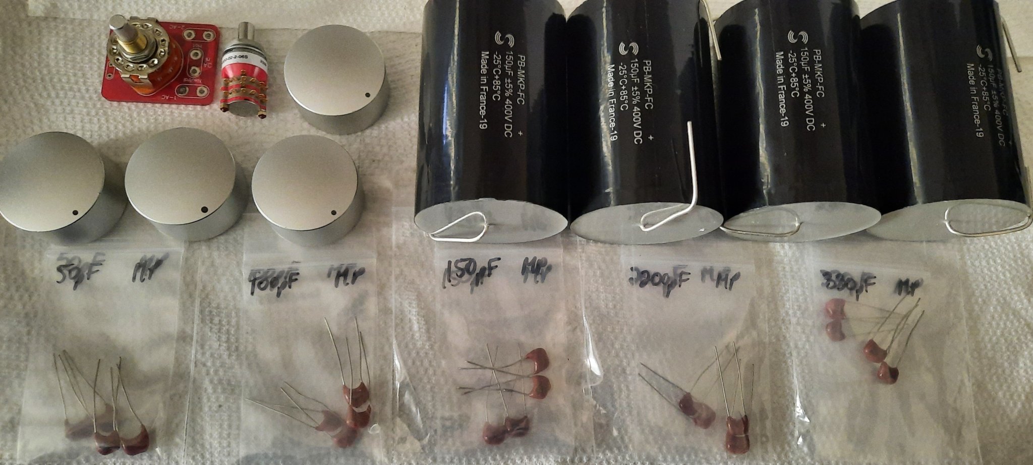

Going to add a switch to my to my DIY EAR 834P clone all out build. I was thinking of these cap values. I have ordered a nice selector switch for 6 inputs.
50pF
100pF
150pF
200 or 220pF
and 300 or 330pF
Hopefully these will cover most MM cartridges.
The MC cartridges will use a SUT so no need to add resistance loading for MC carts.
Anyone see any value missing that I may need? The first input will be a bypass with no value like the EAR has on their inputs.

@pete- I received my other parts this week and here is a pic of them.
I received the Power switch, the selector switch for the different capacitance with the different cap values, Power supply film caps from Solen, and Knobs I will using on the the front of the chassis. on top of these I have already received the 30uf caps for the main PCB B+ line which are Solen film caps and need be I will use the 0.33uf Auricap OX film caps to by pass.
I already have the Antek power transformer, Choke, and all other upgraded parts for the build which I already built up and ready to install. Next will be the internal wiring and RCA's which I have already as well, Cardas Rhodium RCA's and Furutech Rhodium IEC plug.
I'm seriously thinking of adding a timing circuit for power ON. The switch I got is capable of turning on the the heaters first and then the B+ .
here a pic of the parts.
I will post more when I get the chassis up and built.

Take maximum care on Jensen copper foil.Finally finished the All Out Build PCB's and will now mount and test them
This type, with the Silver, have ha leak after some time
Walter
Thank You for the heads up, I actually experience this with some of the caps before. These have the better end caps that the rubberish type and measure good for value and leakage.Take maximum care on Jensen copper foil.
Walter
I have Jensen's in my VTA build from back in 2015 no leakage so far, I keep an eye out for that. I do Duelund Alexanders caps I can put in as well but they will be off PCB mount.
