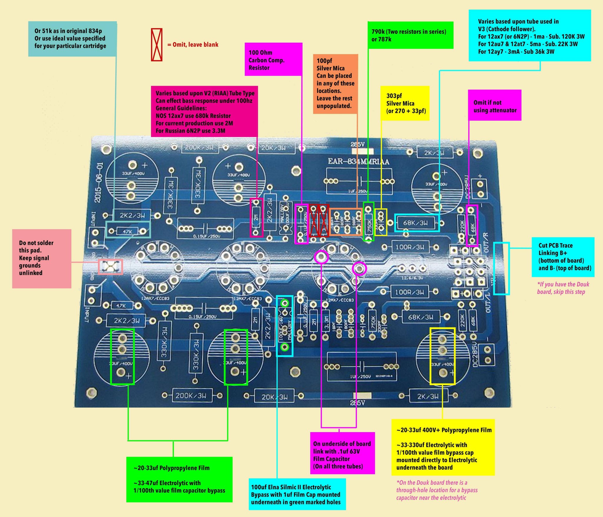

I replaced the 33uf caps with 82uf Nichicons as I think that we need more capacity here. Before I made this change there was a certain congestion to the sound as the music became more demanding that improved afterwards.phono preamp side to finish the installment of the 30uF Solen Film Caps in place of the 33uf Electrolytics
The Lenco Heaven thread that I have been referring to suggests bypassing the electrolytic capacitors with film caps. I have them but I haven't installed them yet. Watching Stephe's latest video about the effects of running a good film cap in the power supply has me rethinking this.
The point that I'm trying to make is that I think that a larger value than 30uf would be a good idea. The 100uf caps that are recommended were out of stock so I got the next largest available size. Increasing these from 33uf to 82uf was a sizable improvement. I would expect that changing to good film caps would also be a step in the right direction, but I wonder if the best results would come from larger electrolytics with good film bypass caps.The bypass caps that I ordered are 0.82uf based on the 1 percent rule but they are really too fat to fit under the board. I think that I am going to try 0.1uf.

@pete I think we need to see what the power transformer specs are and what its capable of handling, just can't throw high value capacitors blindly in that design or you may stress out that PT and can get hot. The power supply we are using are the updated EAR clone PS with increased capacitance going from the (2) 100uF caps to now a 330uF and a 220uf before the regulator with a inductor in between the caps. I'm don't need more capacitance on the preamp board than 47uF, if the caps in the power supply had remained the same at 100uf for the two, I would have upped the capacitors on the preamp board to 100uF like I have on another EAR 834P pcb ready to put in in case.
If the power supply is good and up to the task, then there should be not need for more capacitance then the 47uF recommended. I really think if you are having congestive issue it maybe somewhere else in the EAR or in your system via cables or matching to the preamp that it's going into. I do know that playing with the pot levels does change the sound of the EAR clone and sounds better when turned down around 12 noon on the volume pot of the EAR. If I turn it up to around 2pm on the knob it gets a little messy due to the gain with it being used with a SUT and being set too high. When I ran the the EAR clone just straight with the Sumiko Amethyst cartridge I could turn the volume on the EAR higher with no signs of congestion or messiness in the sound. I have seen this when using MC cartridges and SUT once you get past a certain amount of gain things get messy and unfocused in the music presentation.

It wasn't completely blind, lol. I think that I combined what I saw here, in the lower right hand corner in yellow:throw high value capacitors blindly in that design
And this comment:
"So, if you are using 100uf, then 1uf bypass is appropriate, etc." in the discussion about bypassing electrolytics.
There is also a mention of using 2x33uf in each location, so I don't think that I am asking too much of the transformer. I was quite sure that I read about replacing all of the 33uf guys with 100uf along with the part number but I can't find it.

I was talking about if you were going to use 100uF caps in those spots were they mention 47/33uF. The bypass caps are fine. I also saw about 100uf caps in those same spot and I even built a second preamp PCB with them in there but that was if I was going to use the 100uF caps in the power supply.

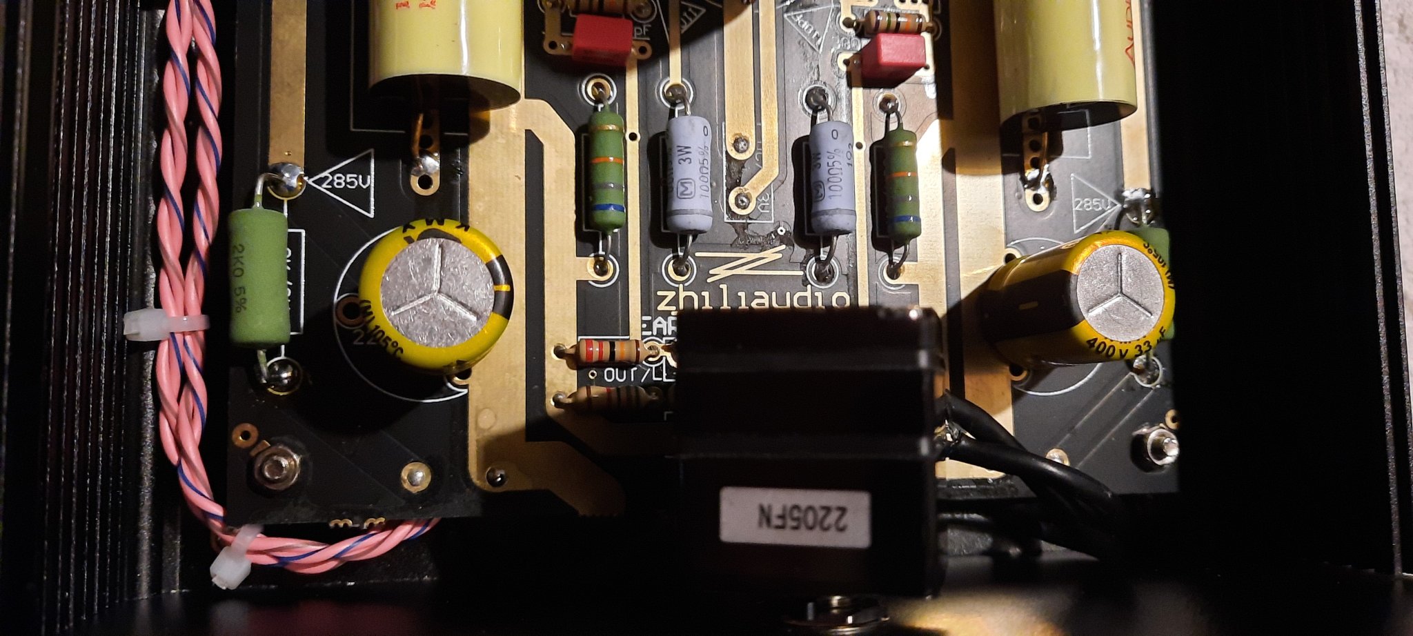

Another heads up for those that are using and or tweaking the seller assembled EAR 834P Clones, I found on another issue on my EAR 834P on the assembly side. When I was loosening up the 6 nuts that hold down the Phono PCB, the one with ground wire on the corner was loose. I barely put the driver on it and it was turning with out any pressure. So just make sure this is Tight. I was getting weird humming noise when I was putting the cover on like the ground was not connected when I was tracking down the hum on the PS in my earlier post. I had to fix that one since it was not grounding at the main PS ground point.
Both grounds are fixed now and unit is dead quiet with just noise from normal tubes rush but at the very highest level and even then it's still very quiet.
