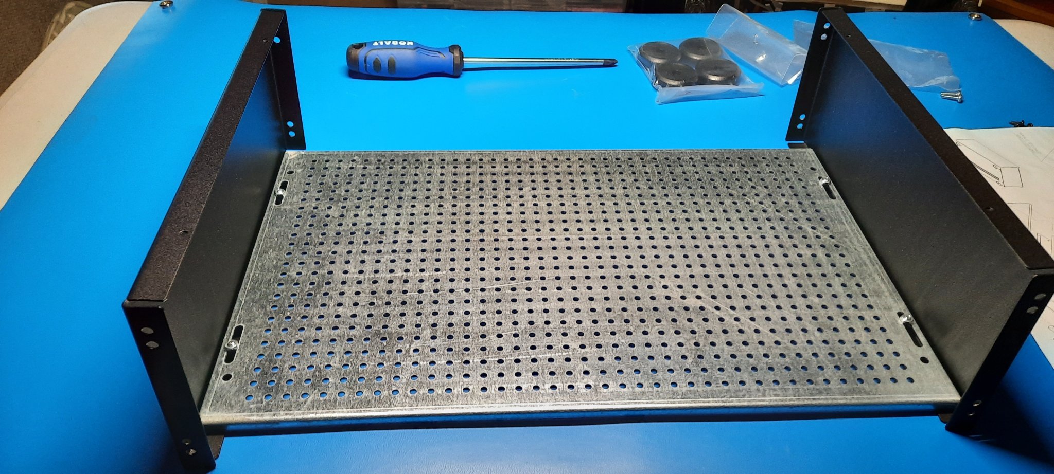

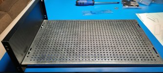

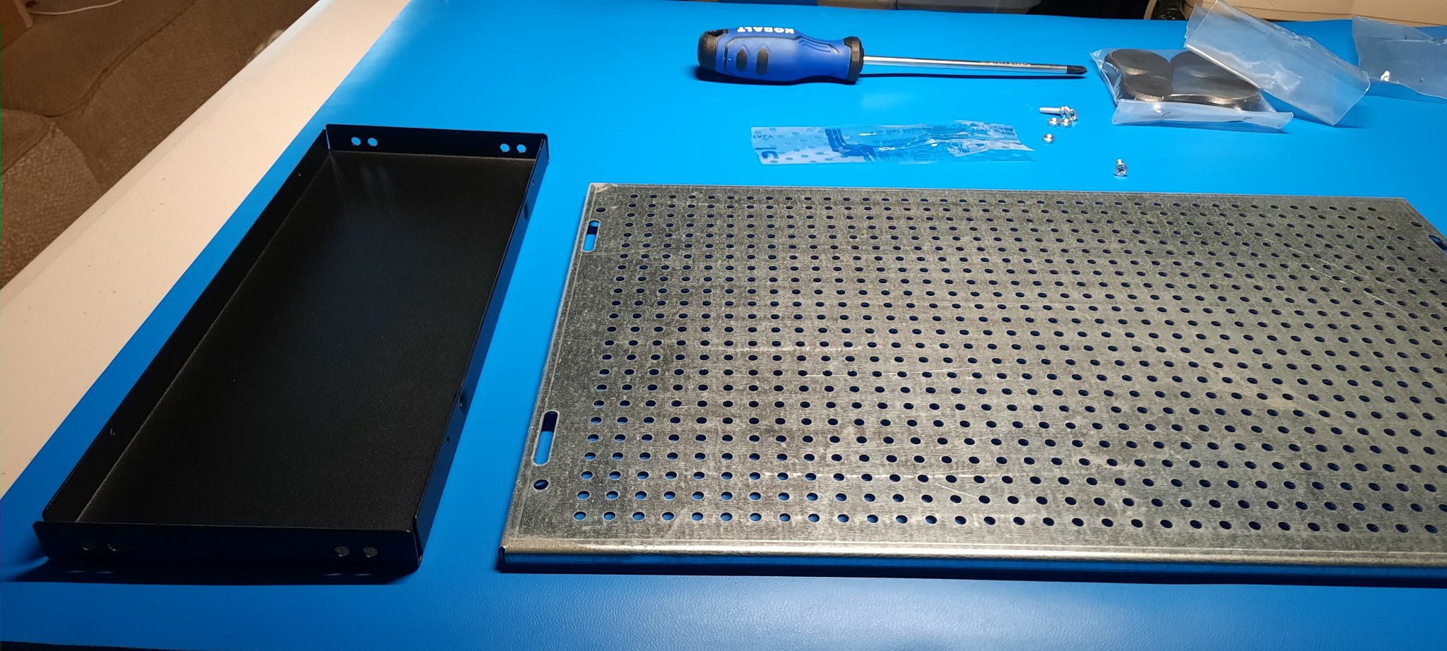

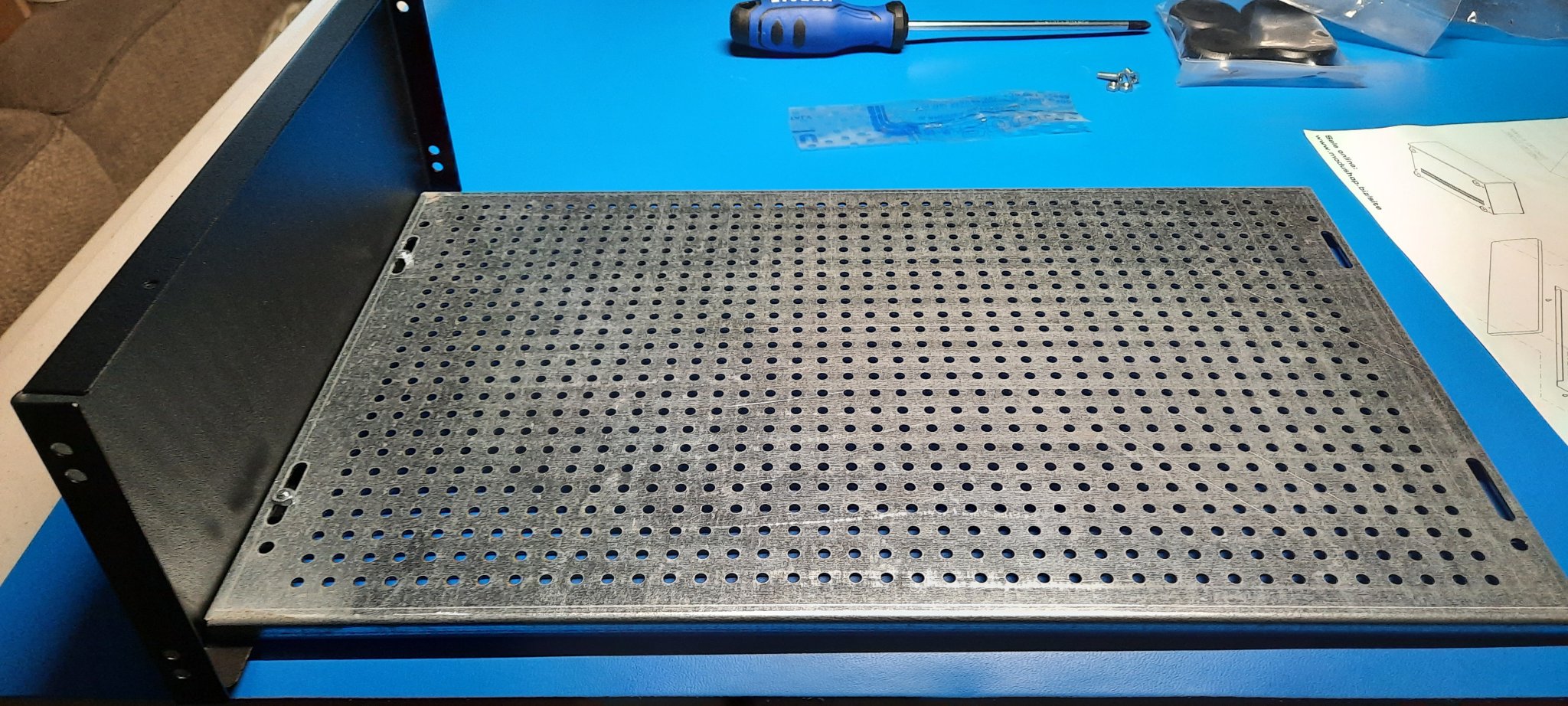

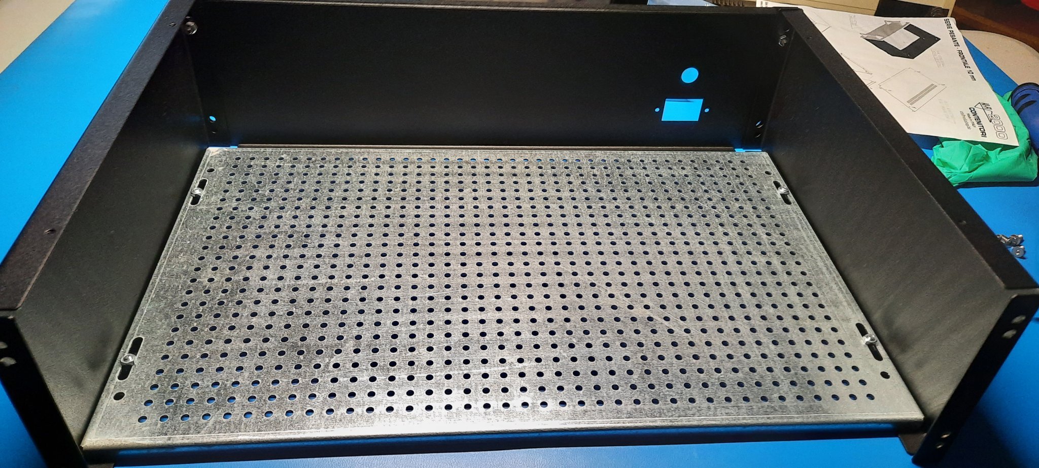

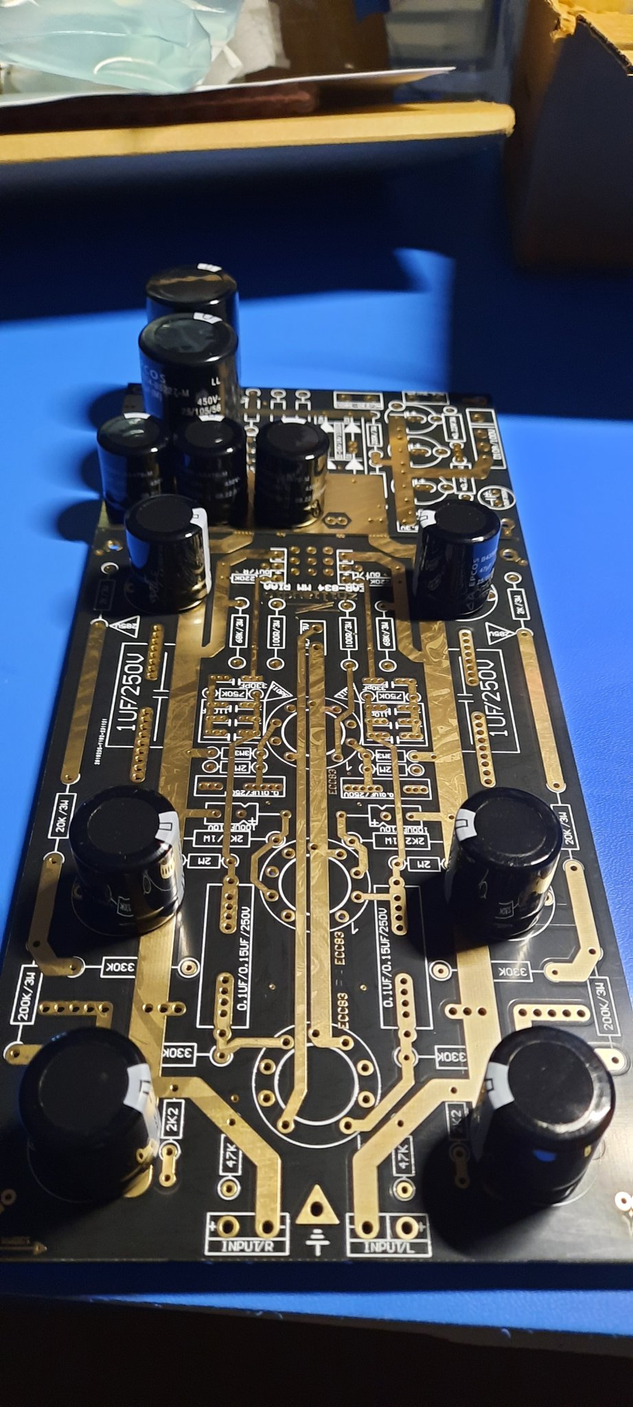

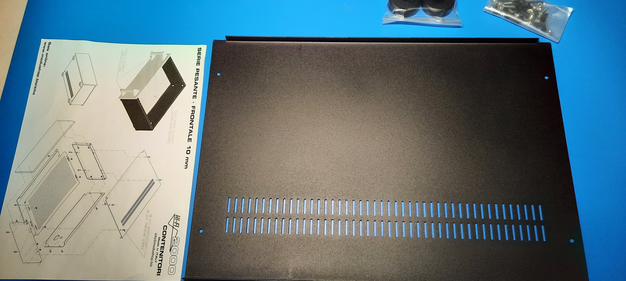

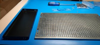

OK, I finally pulled out my Chassis that I bought back when I first ordered the EAR 834P Zhili PCB kit, it's been in the shed for 3 years and today I pulled it out of the shed to start the Dry Run Fit with PCB layout and Transformer position. It' a good size and great build quality. I still may move the transformer outside but will try it inside the chassis first.
This will be an all out build, the EAR 834P clone I got a few months ago that I have done quite a bit of upgrades and mods has turned out so good, I decided to go ahead with what I had bought back during when covid first hit. As you can see there is plenty of room and height to this chassis and now I can use all the TOTL parts that I have order and will fit. Just don't know if I'm going to separate the Zhili pcb's or keep them together and if I want to place the Cinemag SUT inside the chassis. Too many components and I cab reduce 3 into one. As you can also see the Transformer with have a think cover to eliminate the stray fields that may induce hum. I ordered the Transformer from Antek.
I already have all the Rhodium Plated RCA connectors. Mogami wire, AC Inlet with EMI/RFI filtering, and Hi grade IEC Plug. Also will be adding some nice isolation feet to it when its all done and working correctly.
I have learned so much with the EAR clone I have upgraded that this "Should" go well without a hitch.
Any constructive feedback is welcomed.

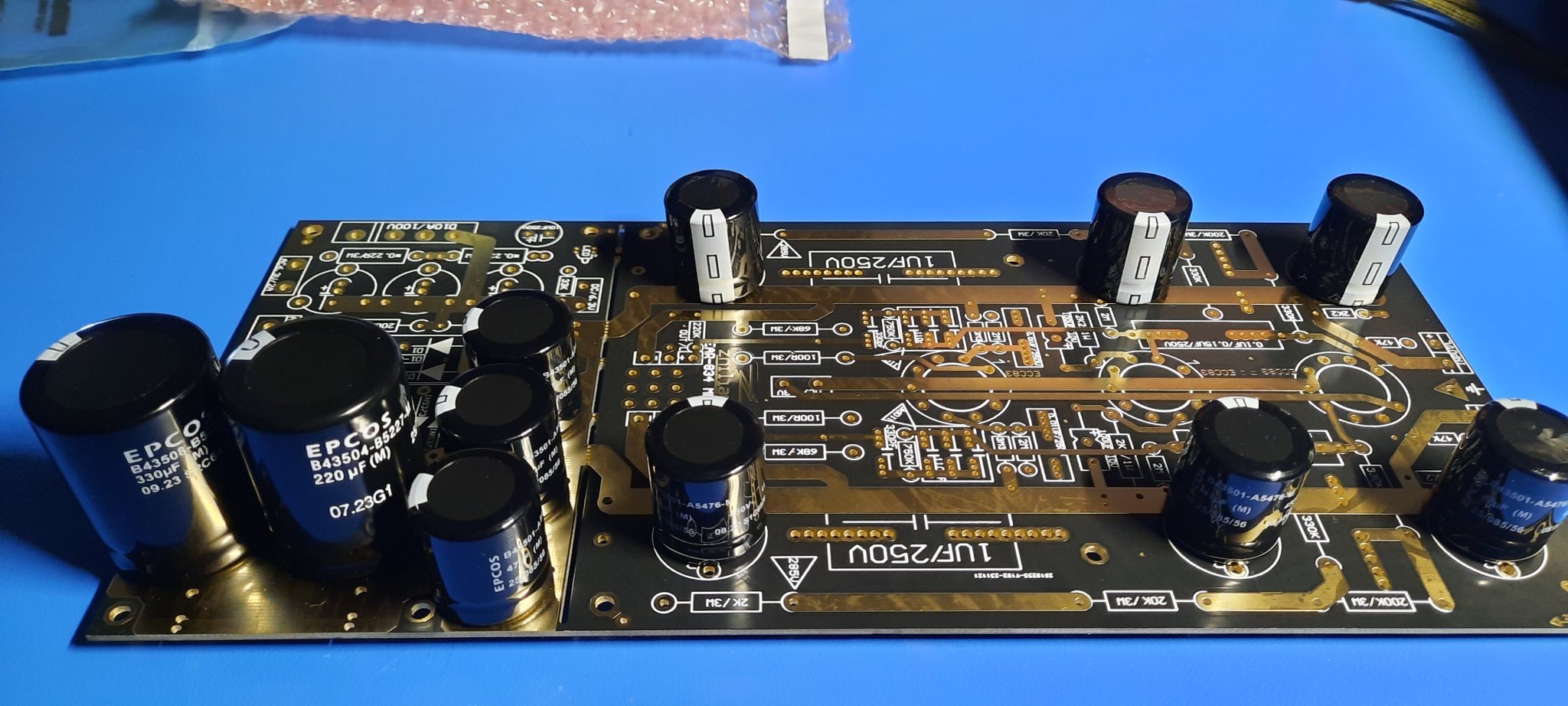

@pete- Yes, This PCB will have the Thorsten Mods. I have the PCB that came with the unit that I have upgraded the power supply and some caps/resistors on it along with the TKD pot. Then I have a PCB with all Nichicon KX 100uf (6) caps. I will do the same with the resistors on this one. The 3rd bare PCB I just got will have the Thorsten mods along with upgraded 100uF Caps and the Jensen Copper Foil PIO caps and the Duelund Alexander caps. The power supply will have the same upgrades as the one I did already but I will upgrade the Bridge rectifier for the Heaters. This final build will have the very good RCA's and IEC inlet along with a nice power switch. I will also maybe put the Cinemag SUT's inside too.

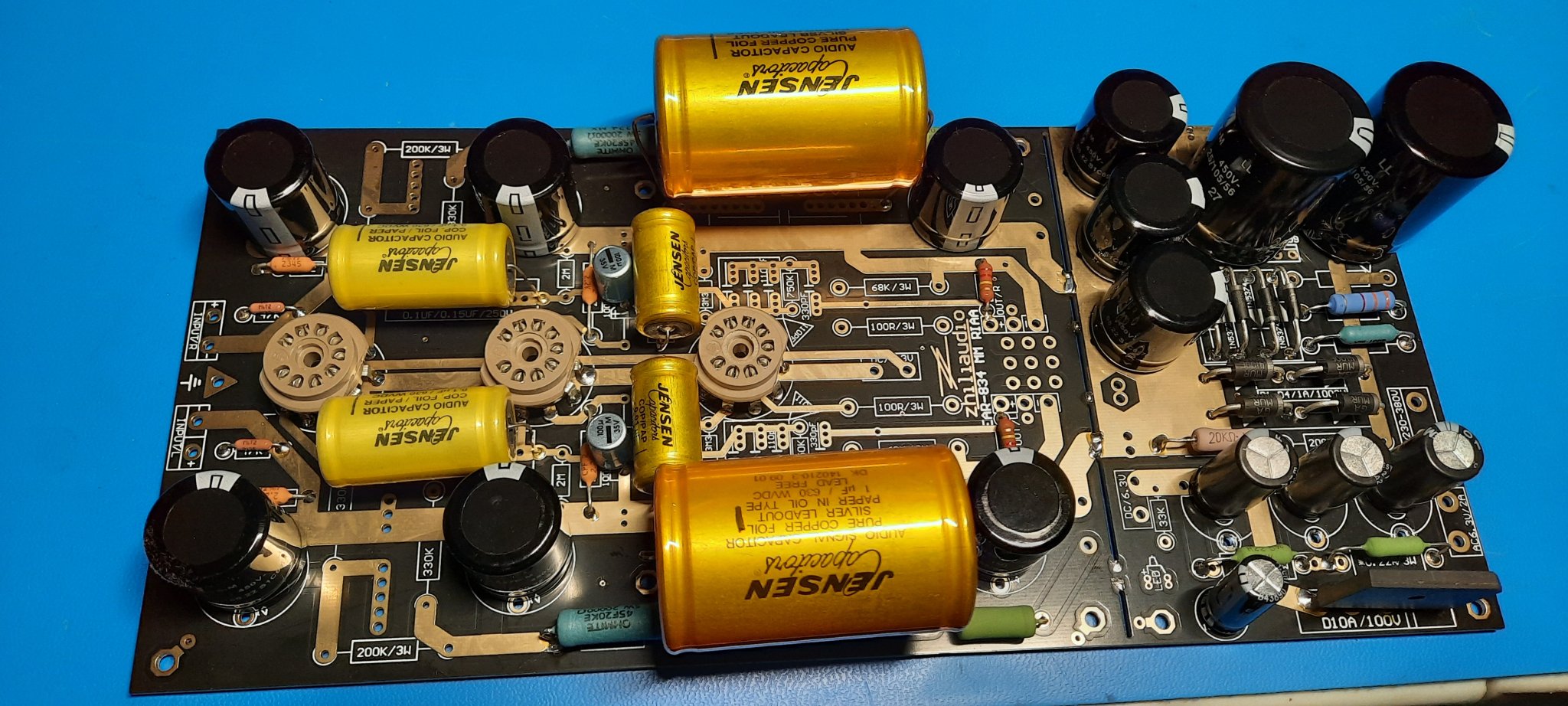

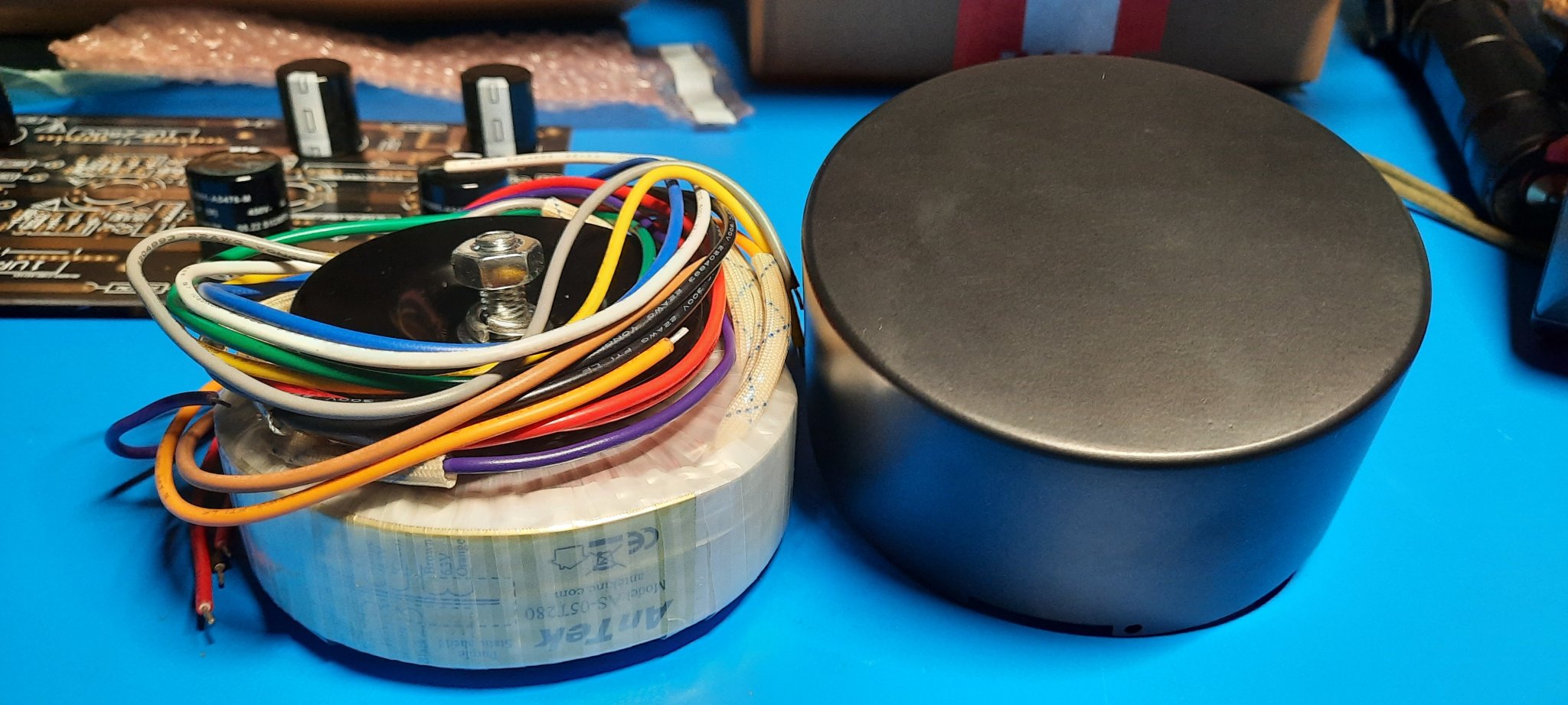

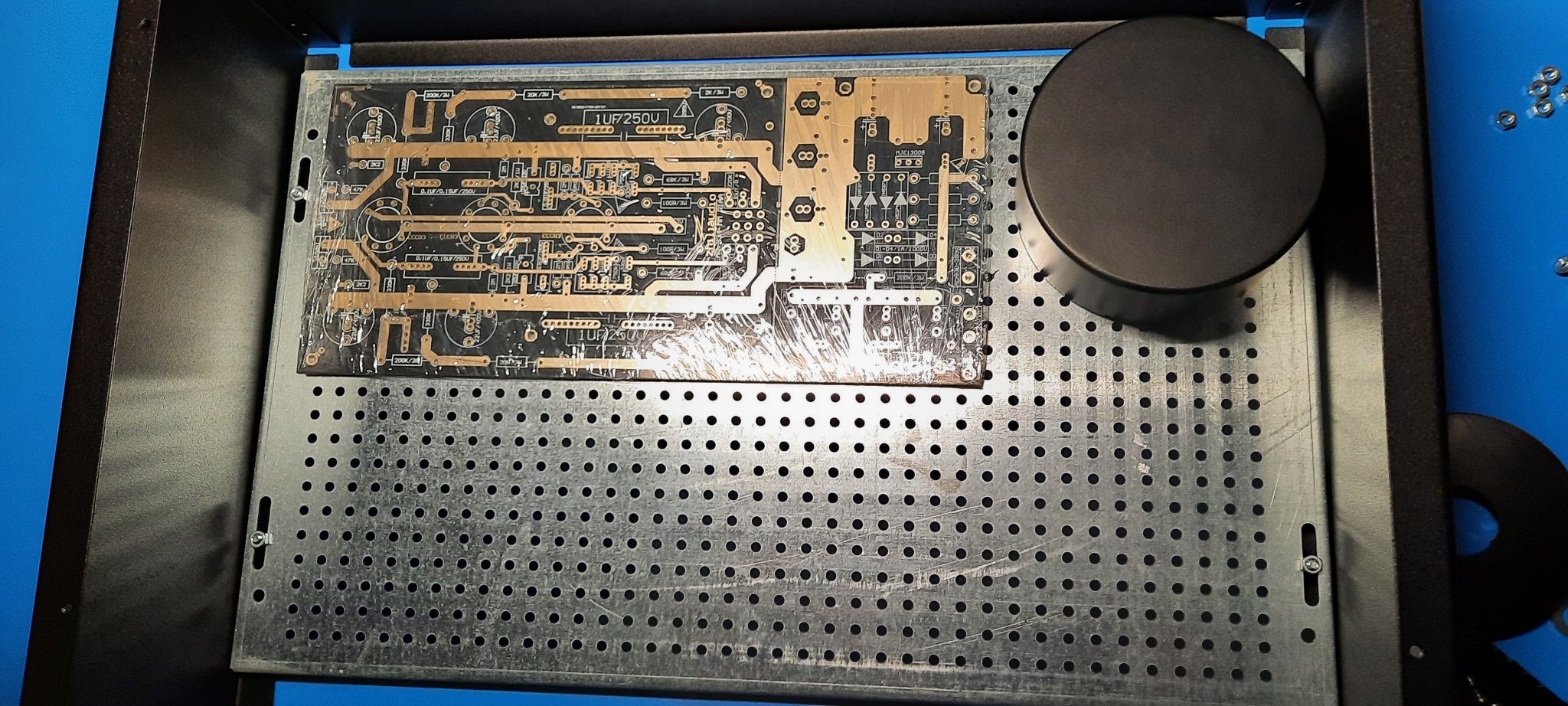

Today I started sorting out my components for the All Out EAR 834P build. I finally tracked down where I put the Antek AS-05T280 transformer and cover shield for it. I also did a dry run of how to mount the Filter caps in the power supply and preamp pcb's, they all fit with a little different placing. For the power supply filer caps I'm using all EPCOS caps and for the Heater Supply again I will use Kemet. Here are some pics.
I have another order of parts coming in and I will start the assembly portion of the PCB's. I think I will use Mogami Quad interconnects for all the internal connections. RCA connectors I already have along with good Isolation feet. Still trying to find a nice place for both the luminated power switch and Volume Pot on the Front Panel.
This PCB will have the Jensen Copper Foil PIO caps and those Dueland Alexander Copper Foil PIO caps.

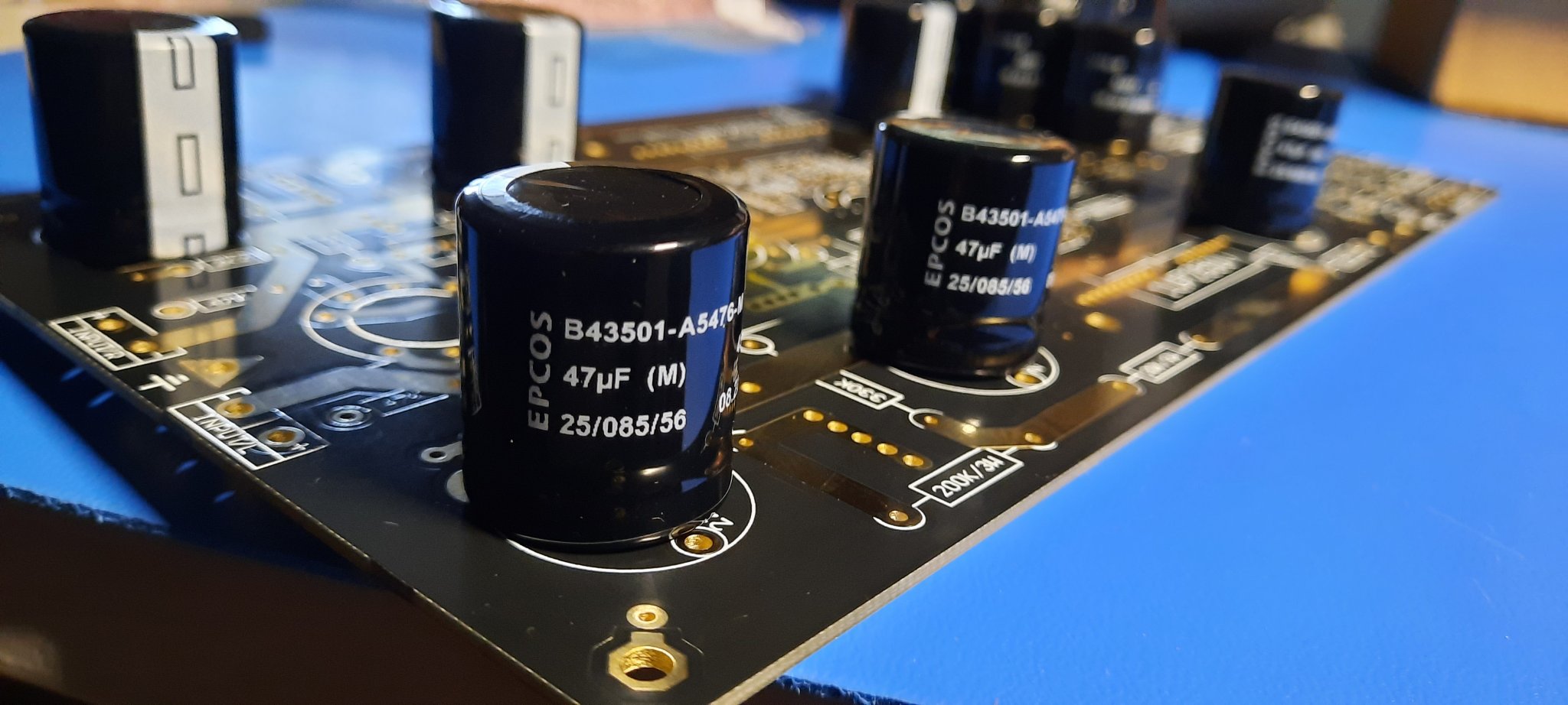

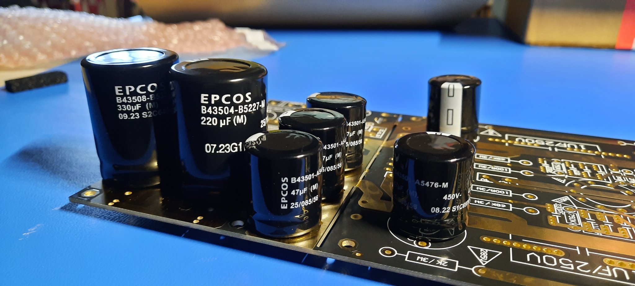

@Pete- They look funny but are correctly going to the big Negative trace on top and Positive spot where it should be. I had to move them over so the EPCOS caps could fit. I just turned the Negative on the 220uF and 330uF to right but now looking at the pic, I see I may have to move the 220uF back and reposition the 47uF cap at the end so to make room for the 220uF cap going back to the original spot to make room for the MJE13009. I do have two spare PS PCB's just incase there is any damage in the rework process, but should be no biggie.
So as you can see here in the pic of a bare PS pcb, it's correct just looks weird.
