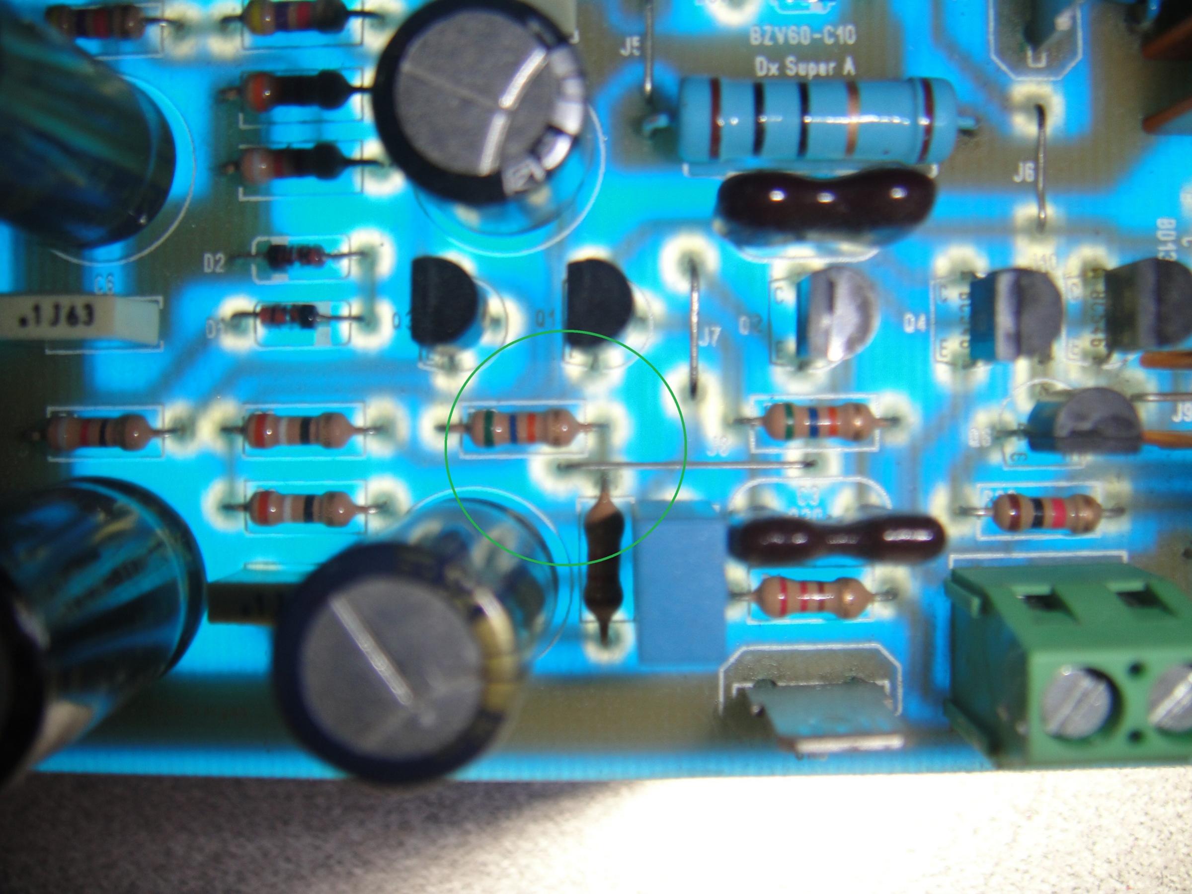

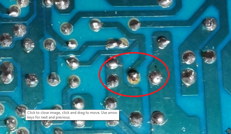

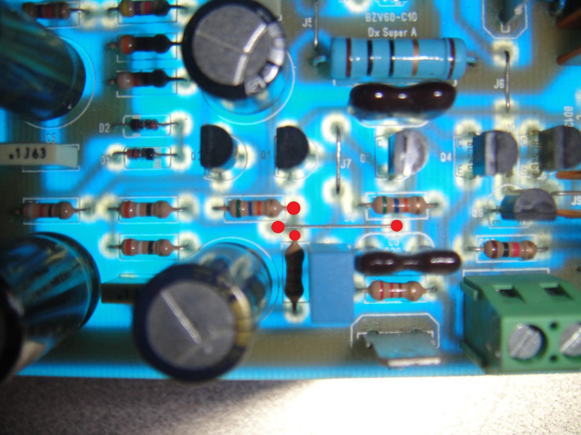

Apnneto,
Yes I saw that. I checked for continuity and it is good. It is from replacing parts and over heating while trying to remove solder. Hopefully I will not have to disturb that again. If so I will add a wire.
Earthquake,
I will sit down today and mark up a schematic. I can only get it to about 15V rails before R4 gets too hot. R4 and R35 are both dissipating a lot of current.
Andrew, That is a shadow. The only resistor that has smoked so far is R4. It still reads ok because I caught it in time. I will replace it when I have the issue settled.

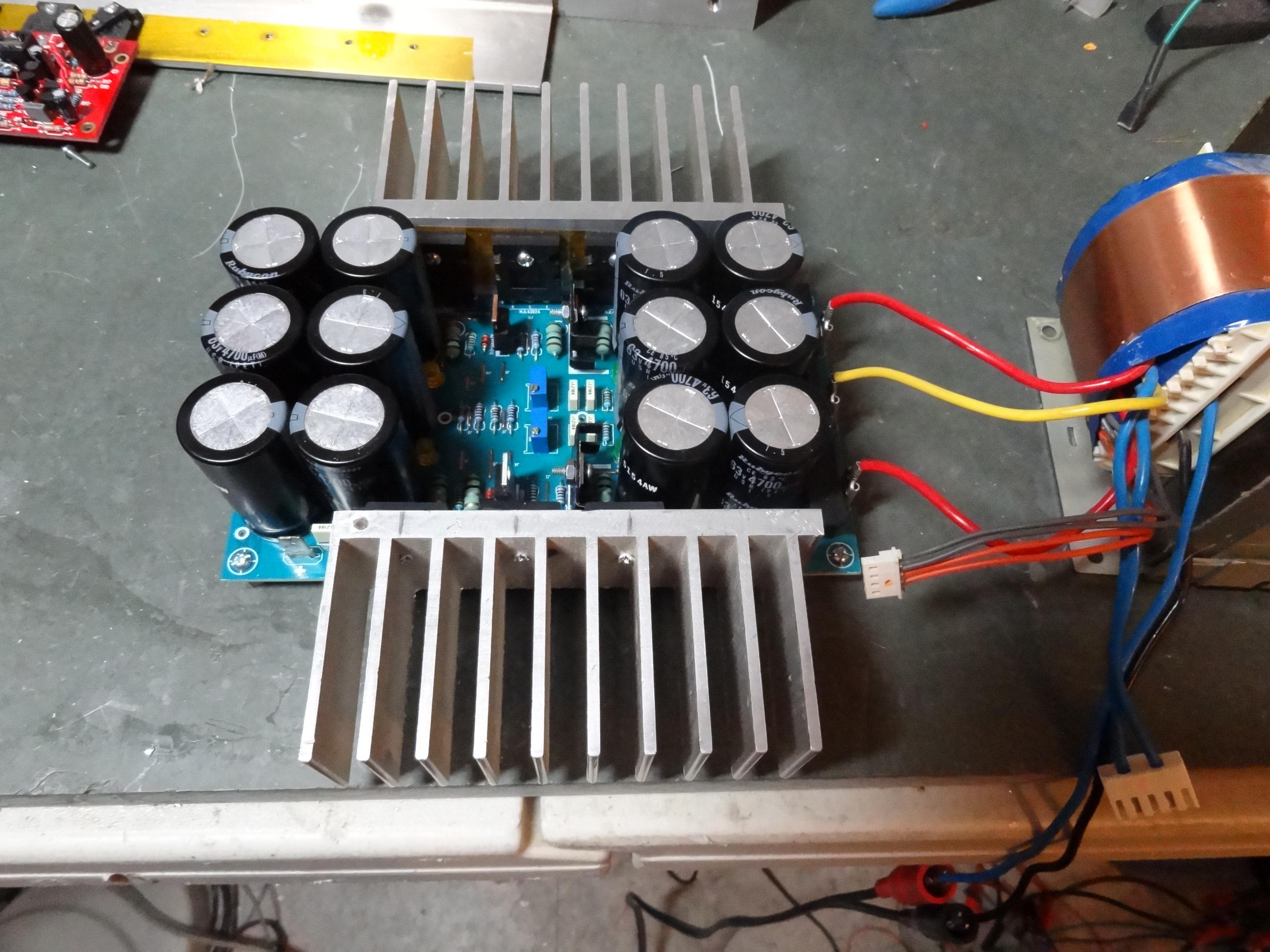

I did have one success today. I got the power supply finished. I tested it with a 150W light bulb and a 40-0-40VAC transformer. It will produce 55.7Vdc with no load and with the 150W light hooked across the + and - rails it drops to +/-52.5Vdc pulling 1.085A. I adjusted it down to +/-40Vdc to check the heatsinks. Current dropped to 9.75A. I let it burn for about 40 minutes and the heat sinks warm up pretty good but I can leave my hand on them right next to the devices with no problem so I believe they are ample.
Here's some pics.
I watched your video. The transistor you pointed out is the one I suspect. It is one ofthe BC556 transistors that I suspect is fake. They look like Phillips units with the silver face and they test OK on my meter but I suspect they break down under load. I have ordered some new ones from Mouser so I can replace them. I am building a SKA GB150 and used those same transistors and it is going high current as well. I should just leave both of them alone until I can replace those transistors so I don't burn something.
Here's some pics.

WOW mister Terry way to go !! I have goosebumps yes man way to go !!! this is fantastic ! I'm really happy that you got the Dx Regulator working you surely make my day thanks to show it that wow !

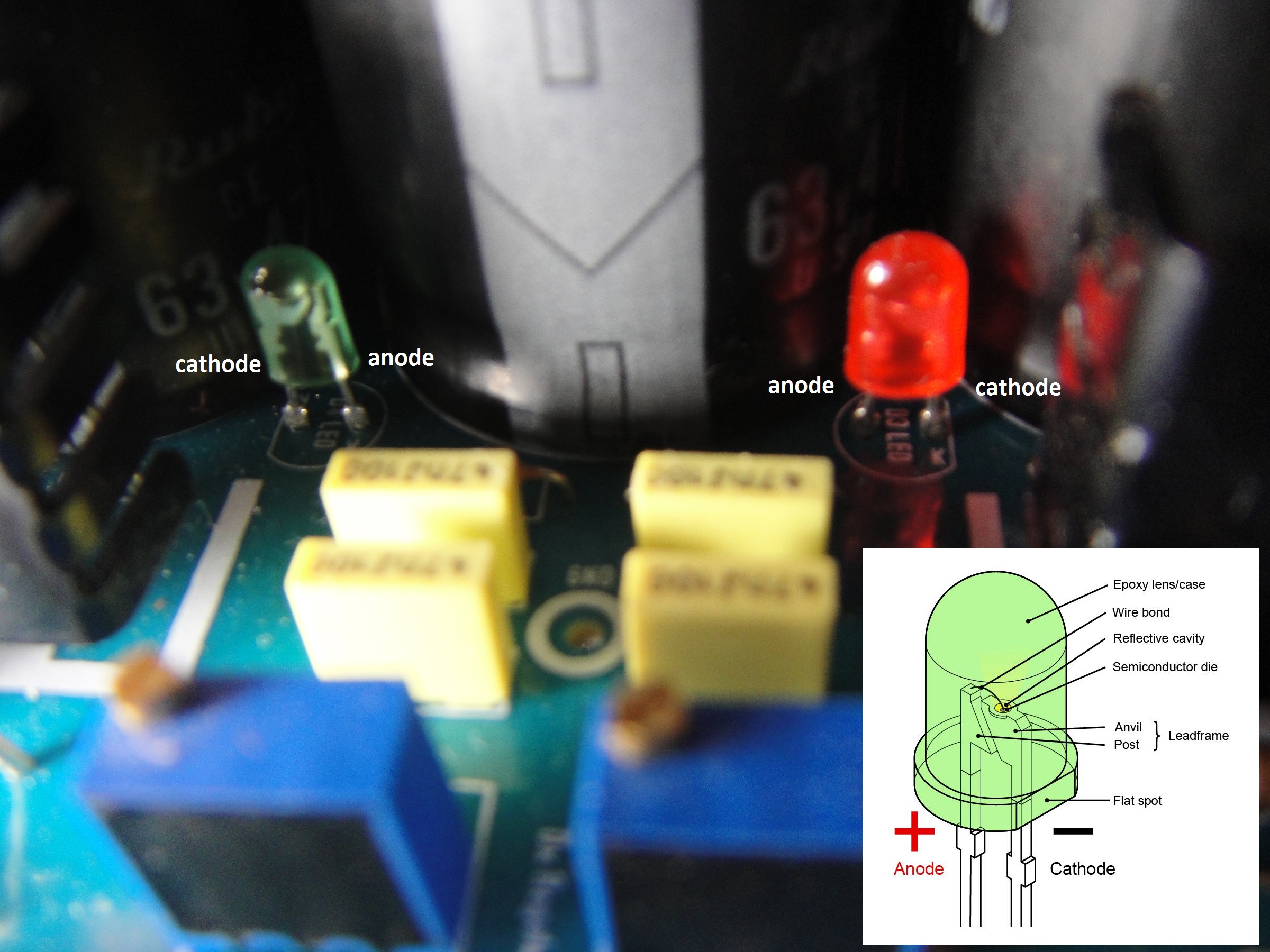

Thanks! I did want to point something out. The silk screen for the LED's on the positive rail is backwards. The LED's all have to point the same way. I found out the hard way. The LED's didn't light on the + side. When I checked the polarity I found it.

The same thing happen to me don't worried jejejejeje also that happens in the prototype so I decide to place the cathode upward on the positive rail see image attached the red LED is hard to see the cathode but you can compare the green LED
