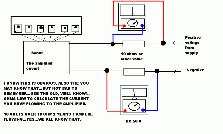

Protective resistances, how to measure stand by current
To adjust stand by bias current.
regards,
Carlos

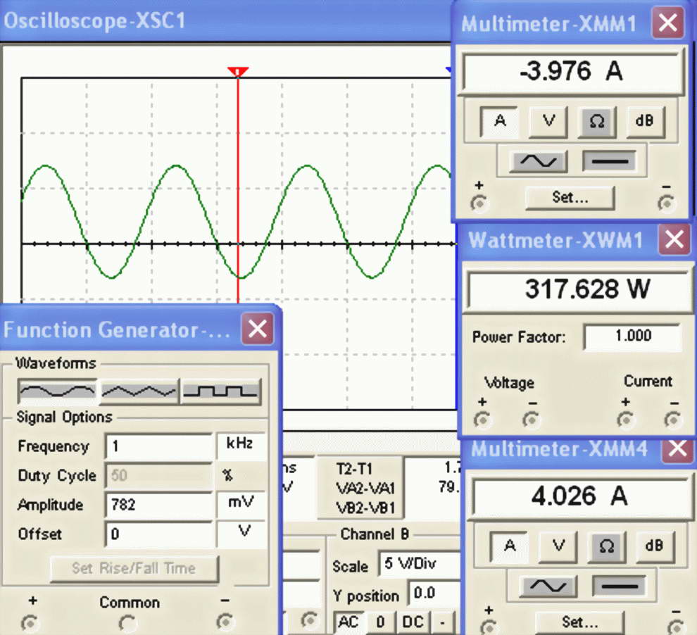

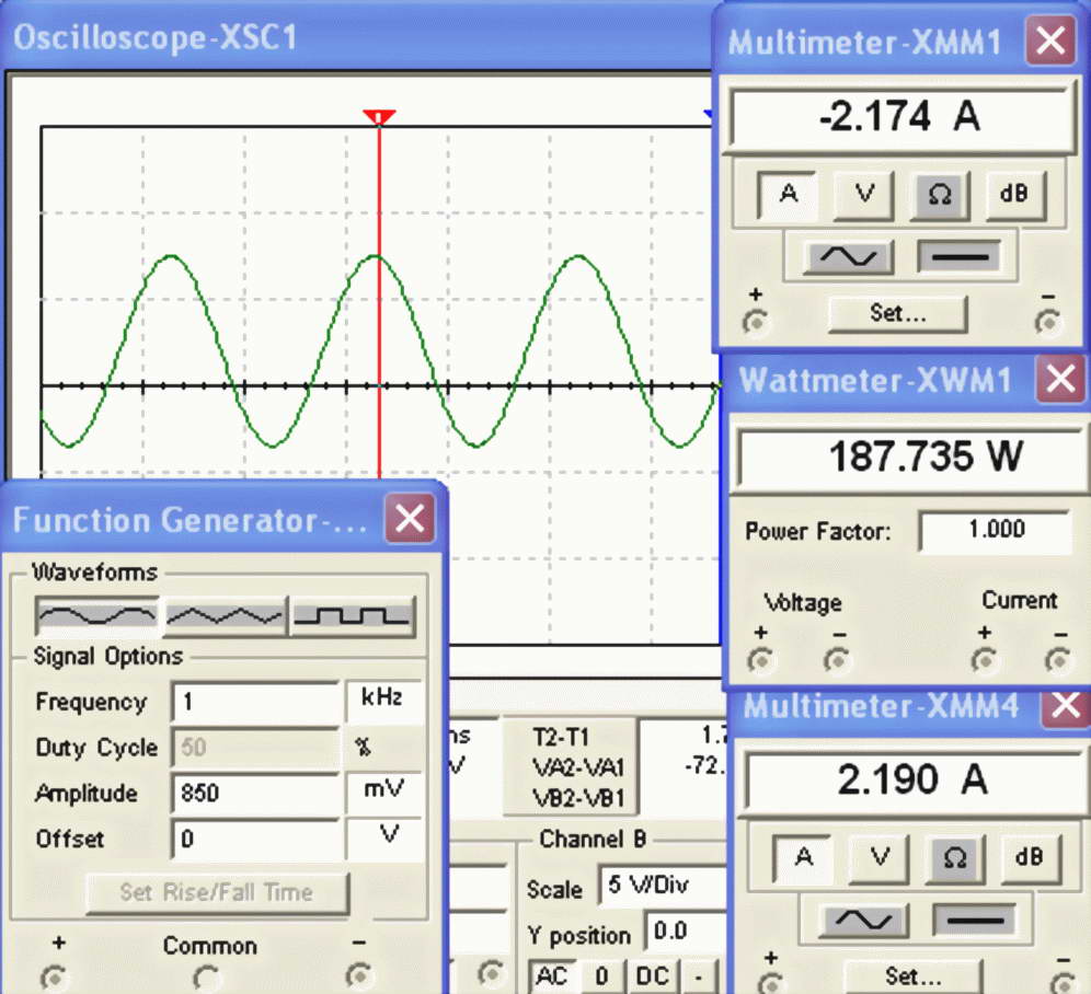

Here you have over 8 ohms loads
I would be happy to inform the unit was tested during 3 hours long, over 2 ohms resistances as load, full unclipped power into the output, sinus signal producing more power than the informed power and the amplifier show reliability and safety during operation... heat was controled, temperature was stable and not high... around 50 degrées centigrades to my 31 degrees celsius environment.
It is a huge, stable, excelent sonics amplifier that will turn you happy...for sure.... guaranteed!!!
regards,
Carlos

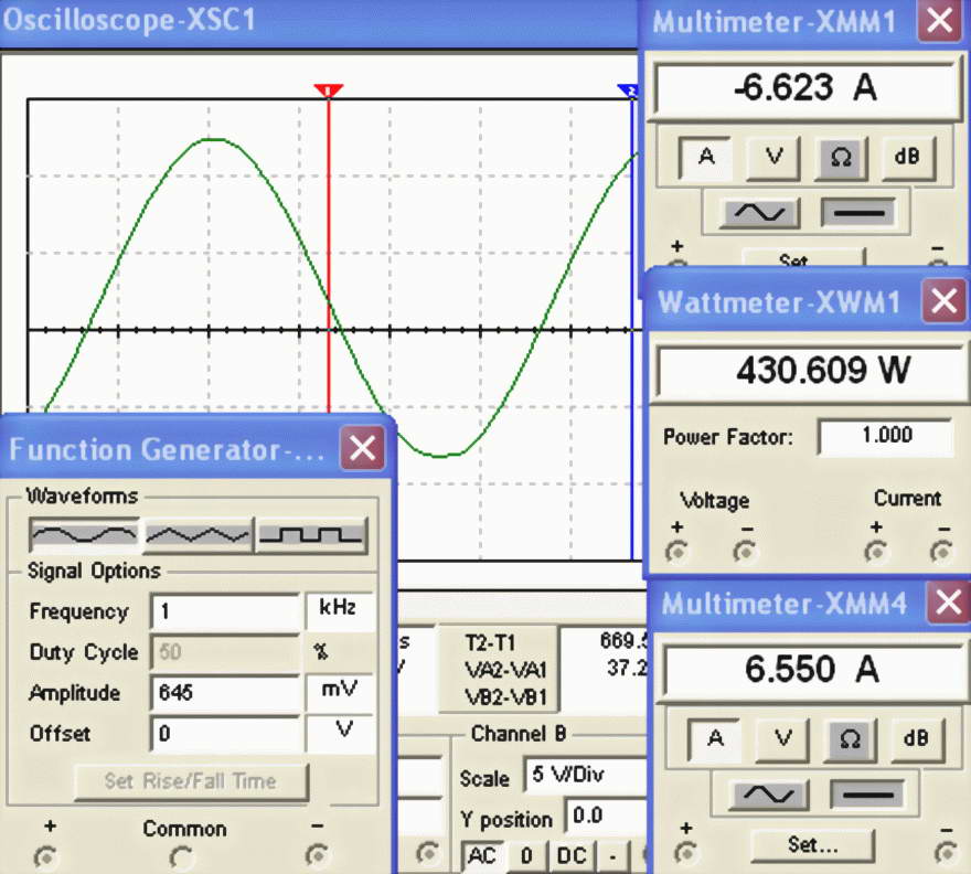

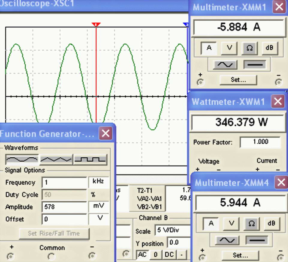

If your supply is huge, you gonna have a very big power
Observe into 2 ohms, if your supply can keep the 64 volts stable...or if it is 70 volts without load and dropping to 64 during high consumption periods of time...you may have this power continuous and much more during peaks...and if you accept some clipping distortion you gonna have more than 1 Kilowatt into a stereo Precision unit that will eat a lot of good brands you have into the market.
More transistors will be needed to continuous operation under such condition.
regards,
Carlos

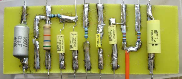

Very slow progress this side... been sick all week, and now its turning into bronchitis.
Attached, some more unusual technique... the black is from the pen I used to draw the pads with before etching... this is the main circuit board for my valve stage... I told you it is simpler than transistors...
All I need to do is wire up the pots and groundstar to one side, and the valves to the other...
I am more of a believer in good components... something that stays the same capacitance as my schematic calls for, rather than swinging in value with increased voltage/frequency.... so do you... I have seen you use micas...
Also on the market you find similar components for diffirent intended uses.... someting that will stand powered on for hours or something that is just used quickly.. like appliances..
Also based on usage and design, caps can vary between a few hundred hours to a few thousand before they start the final drift towards decay... I like the idea of once something is build with components that will stand the trial of time better, it will be a long time before that case ever needs opening again.
Lastly I have pretty good ear, and have personaly experienced/ and often do pick up clear as daylight changes made by small things like bypass caps etc...
