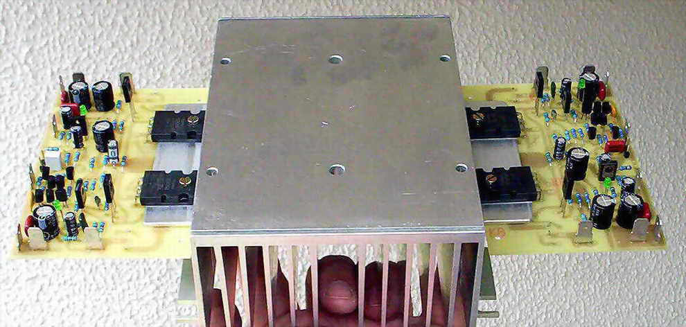

PhongVuTuan... to be more safe use voltage around 50 volts plus and minus
Power will be around 200 watts into 4 ohms... and transistors will share this power, this will be safe to them...even if you plug 4 ohms they will survive.
Use 15000uf each rail to the supply filtering, and this is to each channel
reduce your zener diodes voltage values, to 30 volts and 18 volts, and this, in series will result in 48 volts.
Just that!... and use the Precision I schematics provided.
Search of a good voltage amplifier transistor, something good as 2SC4793 or a lower capacitance unit...high speed unit that can hold more than 100 volts from colector to base...use heatsink on it....MJE15031/31 can be used..of course the NPN unit must be used (do not like them..but works...loves to oscilate too).
Yes Phong, i know your transistors are huge...they can hold more power...... not really too much power dear Phong.
They dissipate more power but under 25 degrées celsius.... in real world temperature, the good idea, safe idea, is never make them dissipate more than 60 watts each one.
Good luck Phong.

Got around to takeing some measurments now.
Offset... well my meter is haveing a hard time reading any... kind of switches between 000 and 00.1mV surprisingly as it was a little higher before transproting the parts over to the factory board... checked vbe of front transistors and all looks good between 590 and 700mV... remember I am running off a higher than standard rail voltage. Also there can be up to 10% diffirence between models just because of zener diode tollerances....
It was pretty neat to see voltages measured compareing pretty well to simulated voltages Carlos supplied me with...
I recommend 2 BOM changes...
R16 still 10k but 3 to 5W... can be easily added under the board if too big for on top... I think I have a 2 or 3 watt in there and it is running too hot to my liking 120V over it....
R6 still 3k9 but 2 to 3 W... also because it runs very warm. seeing 40V+ over it.
Fully agreement Nordic..if you said.... it will be changed
Understand this stuff as already changed.
Near future we gonna ask Todd to include the watt value into the schematic.... for a while we gonna keep builders informed about that.
So, R6 and R16 to be changed by 2 or 3 watts resistance..same resistive value.... good... Hello Todd Johnson!... are you there?
