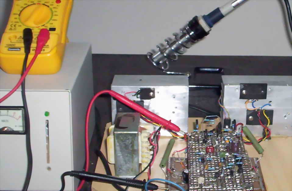

need help for DX-Precision I
hi,
my Sweet sound amp need help.

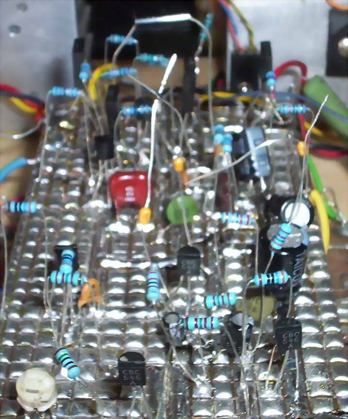

i need help to understand the problem arised recently. i just made DX-precision I, last time it was ok, when i reconstruct my circuit, now i can operate on low voltage without any problem like 22-0-22, but when i opearate 56v, it's showing some problem like every few seconds making loud some sound "chuik, chuik, what can cause this problem? i checked all transistors.
main power is 59v dc, + rail zinar 22v in series with 33v ( found 53v), _ rail zinar ( found 57v). 4.7v zinar (48.4v). 12v zinar (12.2v).
R16 10K is little bit gets hot. voltage is 103.5v resister oneside to another side.
i checked transistors, all voltage from E-b are fine showing 500mlv to 600+mlv only BC547 E-B voltage is 0.197v. do you think it is correct volt for BC547?
From gnd to R18 and R19, voltage is same 57.5v.
transistors E-B voltage....Q6=0.620v, Q7=0.197v, Q9=0.606v, Q10=0.552v
BC547 placement...it is oposit then 5551.....bc547 like CBE. so i checked it was placed correctly.
i checked the transistor there is no sign of damage. i also changed another one but voltage still arround there.
Bias is ok.....C26 volt _ + volt is 2.42v, but it can adjust to low or high.
Thank you for help.

No transistor can measure less than 500 milivolts
You have errors to search for.
BC547 and BC557 are not a good idea into this circuit, as voltages are high.... BC546 and BC556 are higher voltages units.
At least they were, if factories have not changed the rules about them.
Human error... the same old story, happens with everyone of us.
Go searching, you have something wrong, assembled wrong way, error in resistance values... well.. hundreds of possibilities, and all them can be explainded my the sentence.
Human errors that happens usually... and daily.

hi,
thanks for help. what is the moderate voltage shuld be opretate pricision I amp?
yes i changed bc547 now it is Bc546.....no more "chuik" sound
but must adjust output transistor E-B voltage, it must be above 580mill volt then the sound is nice, if i reduce below 580+ mill volt it producing distortion sound like lack of power sound.
i feel like i am driving by over voltage. it should be reduce bit more then 59v...
i think 40+ volt should be nice right?

Update and problem, may be solving
latest update precesion-I, problem may be going to solve.....
after i change the BC547 into BC546, no more "chuik" sound, at first it wasn't stable then now getting more stable. i am now opeareting 2hrs +, no problem found......temp is now reading 39+ in moderate volume. voltage is still 59v. i took test on BC546 E-B voltage there are still below 500mil volt its arround 179millv, it dsn't show any mzor problem should i keep as it is or find out why cause this voltage drop in bc546?
*still have one problem, when i power on the amp, speaker makes loud sound then goes to quiet....i don't know what cause....sound is ok...
sound is great then last time. its more clear and more dinamic. trble is sharp too, just nice.
