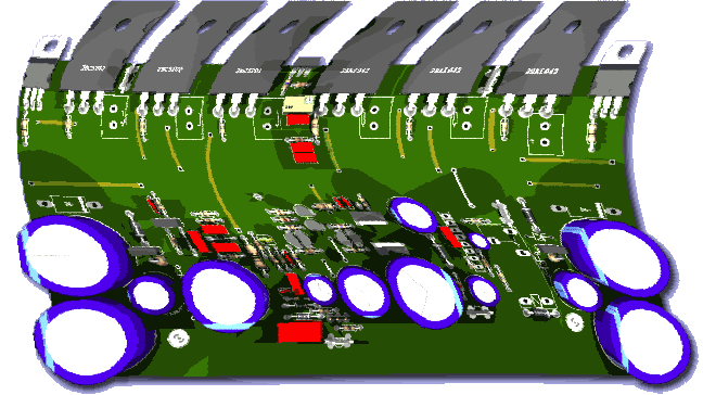

Audio quality is already excelent, and huge condensers will not add nothing to the
audio....but can make the amplifier loose a lot of Elegance.
Smaller condensers gives more "Class" to the way an amplifier looks.
Image proportion, ratio...alike someone that have pants number 32 and use pants number 50!... the bigger one seems oversized to the user.
Well.... i have already tried to "sell" my opinions about..... this is Democracy, so, be confortable to decide.
My vote was more than clear.
Sorry the image quality, was made only to give you an idea of how may look with smaller condensers.
regards,

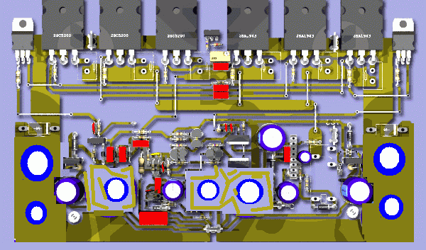

I'm afraid you are going to learn to live with 1 inch capacitors...
I hate empty space on a board... I made provision for 2 sets of caps so people can choose to use just one, or even paralleling 2 lower values... Nothing prevents you from useing small caps there... and nothing prevents me from useing 100V caps... it does not affect board size.... so we must all live hapilly with the compromises...
My experience with the large caps has been nothing but positive...
Oh and damn, the PC rebooted during the night, and I am back at the previous step... never saved the last changes... stupid auto update.
The lenght of the board is 20cm, which is the max length I can fit on my heatsink... I don't think a smaller sink is viable for this amp anyway...

Board dimensions
Nordic, thanks for the enticement of Precision board shots.
What is the planned width of the board? It seems that heat sinks will have to be at least 12.5 cm wide to accommodate the board width plus power transistors. Wanted to start looking for the right heat sinks.
Francois

thank you for sharing your design to us.
I eagerly waiting for the dx precicion pcb and layout to try my hands on.
I'm not so sure if there's protection circuit build in on your precision amplifier,
so I'm wondering if one supply voltage (ie V+ or v-) get cut off
will the o/p stay at 0V like leach low tim amplifier?
or it just give max V dc on the o/p?
once again thanks.
