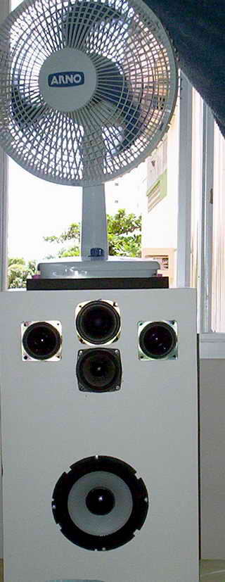

Yes Mihai...thank you very much.
i have prepared the "Speakiller"..... an instrument, not a speaker... it has 1.6 ohms impedance...speakers are in counter phase, opposite..to complicate things, not push pull, not spherical speaker aproach...also i have zeners, power zeners limiting and producing 0.5 ohms shorts into the output, both rails shorting..also i am using coils with ferrite inside...to saturate, low power capacity ferrite.... some milihenries...also have capacitance enougth.
The Speakiller is made for testing purposes.... the amplifier will be tested receiving square waves into input, overdriven, much more than needed, not only subsonic, but also high frequencies will be used...a sweep generator will send sinal to the power amplifier.
It will be tested (was already, but not so hard this way) to be reliable.
Precision II will be able to hold almost all difficult loads people can attach to it.
Precision I (One)...if to four ohms loads (also 8 ohms of course) and nothing more than that....but the other will be made to resist to huge testings.
VAS protection will have switch to put it into the work or not...also the output will have a switch...output will be connected to the NFB, so, generating EMF back to the amplifier and will have the option to be opened, not connected to the NFB, also the mirror, the CCS i am using to feed energy to the VAS and VBE multiplier will have a switch too.... the amplifier will have the condition to operate with CCS and with Bootstrapp.
This will finish with doubts...the one that will have the unit will have a laboratory to test...
What is really better...a CCS or a bootstrapp?
The user will know for sure...also the dinamic disturbance that protectors creates into the VAS...the user will know for sure...also the EMF.
So...we gonna offer the best amplifier we could make, that will eat thousands of others, and a laboratory of experimentation of audio, hahahahahaha...included and for free. (the laboratory is for free, the board will be not...ahahahahah)
No one are offering so good ideas...and if someone copy...i will offer more things.... and faster than the competition will flip their eyes.
There's another 150 watts woofer into the back panel, they are 4 ohms each one.

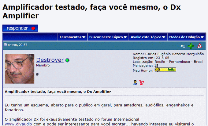

Yes, I'm sorry, but things need to be done carefully when you work with other people's money (groupbuys), circuits needs rechecking, and boards need prototypeing, as it saves money on haveing work redone at the factory... a big problem when there is no profits to recover such losses from.
Neto e falantes da lingua Portuguesa.
to Neto and other portuguese speaking personnel.
I am posting into a Brazilian forum, the HTforum, the Dx amplifiers are there, with schematics and pictures and explanations about how they work.
Here the link:
http://www.htforum.com/vb/showthread.php?p=937280#post937280
Dx Amplifier will have boards made in USA and will be sold into the Brazilian Market... the standard, vanilla, Classic one.
