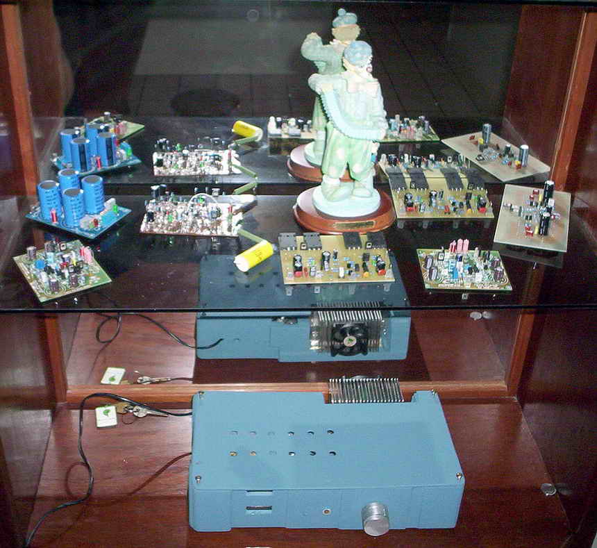

Carlos,
Nice amplifier shrine, amplifier goddess?, hehe. I really like those boards close to her feet, they seem to really jump out almost as though I can hear them just from looking at your picture, amazing!!.
Always enjoy reading whats new in your threads, to top it off I always get a good laugh from Crazy Uncle Charlie!.

I am glad you have apreciated Colin.
The Precision schematic was made in September.... after readings of Doctor Self...and also Giaime had published "my amp" and used the input i am using.
I was waiting the HRII to take off.... to have people constructing.
Uncle charlie is turning more and more crazy...but productive..they will not lock me inside hospital as i am usefull.

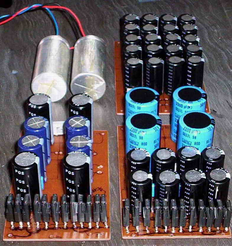

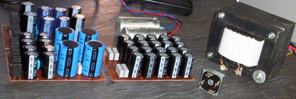

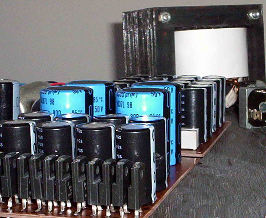

I am building supplies, not ready yet
Two voltage supplies, i am showing you a non complete supply for a single channel.... huge supply, able to feed energy to the amplifier to face 2 ohms loads.
Small condenser are cheaper, some of them in series because of voltage, having resistance voltage dividers to help the voltage sharing and to discharge the supply when not used too.
It is not ready, i have to construct coil and install many snubbers and small capacitors, also some resistances, Leds too.
Higher voltage and lower voltage to Precision II.... the Precision 1 will use the same HRII supply with small modifications.... a single voltage into the output.

The big alluminium ones will be for the 63 Volts supply
It will not face high current consumption into the Precision II, but i will use it as bench supply, and so, those big ones, 10000uf X 63V will be good to install after the coil.

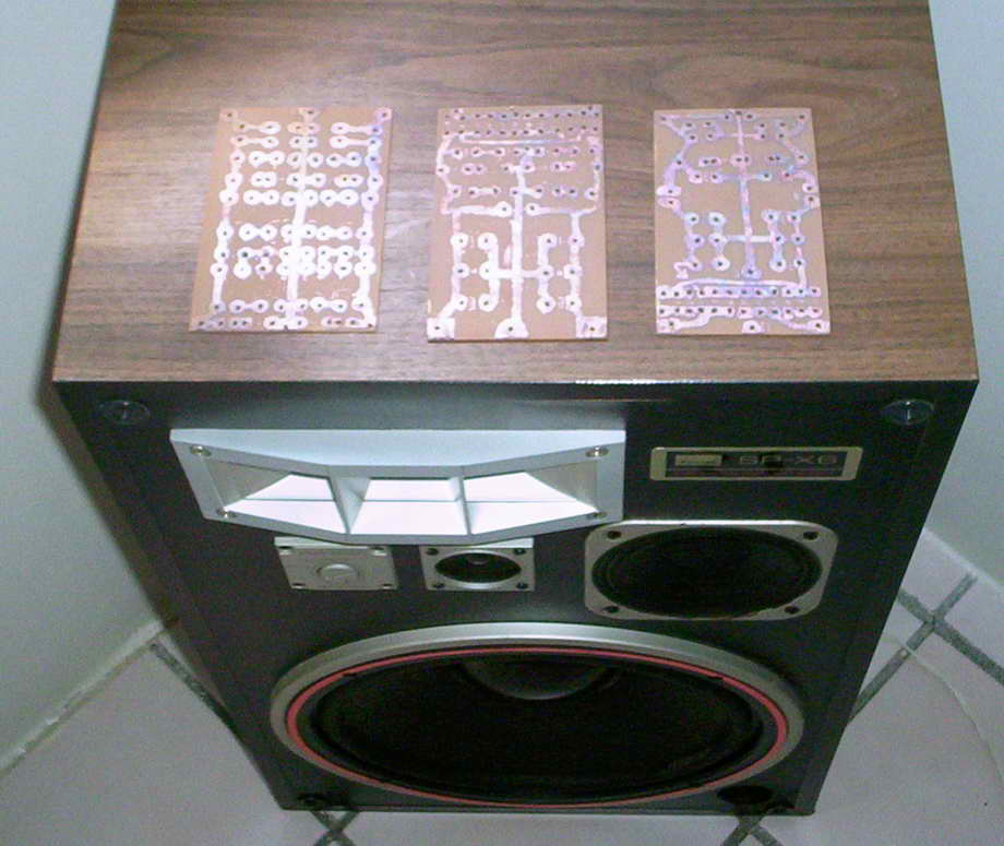

I think we will go with the version with all transistors inline... it is much more flexible to match cases and heatsinks.
I have it at the point where the board is ready to prototype.
After which it needs to travel to Carlos for verification, testing, etc.

Some folks wrote me saying that long strip is better.
Go ahead... i will be waiting to produce board testing to allow you to offer boards into group buy.

Precision I - power supply
Carlos
Got a message from SC: he is VERY happy to see that you are making good use of all those caps and fast diodes.
In the last few years I stopped using 2~4 large caps for my power supplies and started using lots of smaller size ones. Yes, the board is larger this way, but I do not really care. It "looks more impressive".
Besides all the obvious advantages, this approach also allows me to use an "universal" PCB for different experiments - all I have to do is to select the caps and diodes accordingly.
My hope is to assemble my DX HR-II by the end of this week and start enjoying it... just in time to start ordering parts for the Precision I.
I am thinking about a multi-channel system... powered speakers...
The last remaining (i.e. two) brain cells are at work...
