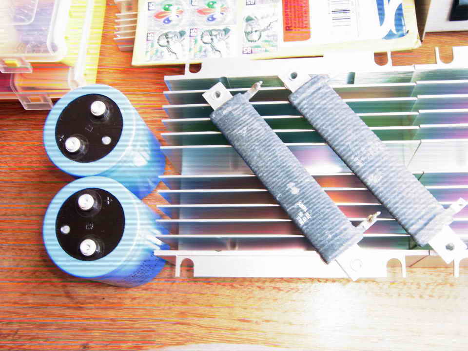

I am showing (sorry the image, foto machine damaged) some boards that will hold 24 high speed rectifiers, 2 voltage supplies, and electronic regulation is not shown here... this is for one channel only.... no rectifiers shown, not inductor, no resistances, not capacitors, and they will be more than 100 each channel.
I will start soon, the burn testings...wanna see reliability...can burn transformers, speakers, appartment mains..but cannot burn amplifier...if something happens will be fixed and will be more and more huge (hard to kill, to survive generations and to sound better than others)

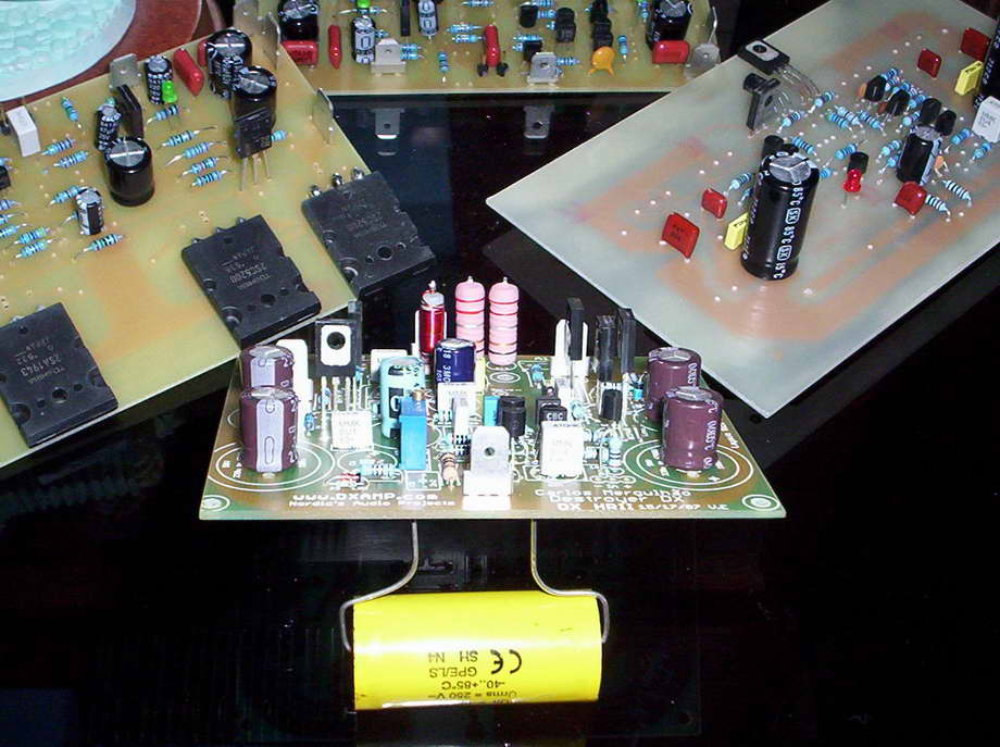

I was preparing some boards to show friends that will visit me, they are not audiophile, but they love music and sound equipments...i remember they have asked me if i can describe, very fast, in a short sentence what is to be an audiophile.
I told them.
- "Exotic crazy folks, they may like this capacitor here".
Then i install the unit down the board and they could see what i mean.
regards,
Carlos
