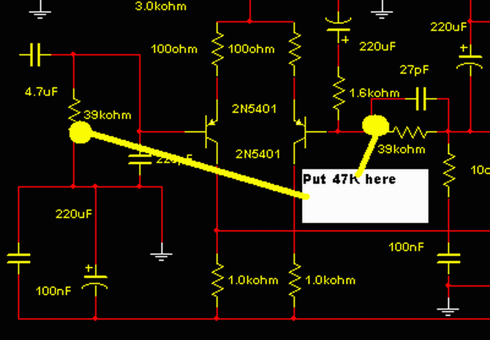

Uncle Charly, back on topic... is there a way we can increase the input impendance of the amp without loosing all the gains we made and possibly adding a bit of Johnson noise?
The reason is, I'd like to try the lightspeed attenuator this year, and it will not work driving loads as low as the input on the HRII, it may still work with the original DX... or as someone called it, the DX Classic.

yes,Nordic said:is there a way we can increase the input impendance of the amp without loosing all the gains we made and possibly adding a bit of Johnson noise?
just change the input and NFB resistors and alter the matching caps to maintain the same turn over frequencies.
Finally, check that the mods have not affected stability.
Edit,
DX's pic shows it.
the 4.7uF and the 39k on the input and the 220uF with it's series 1k6 and the other 39k all need to be changed in proportion. The 27pF may need to be experimented with to bring back the stability margins.

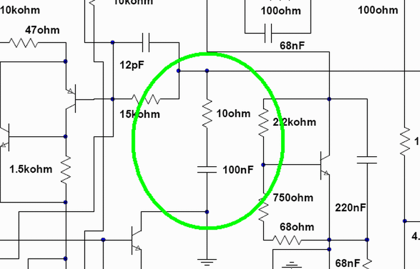

Re: Todd Johnson (TAJ) made the kindness to prepare a nice
I noticed a mistake in the latest schematic. The complementary device to 2SC4793 should be 2SA1837, not 2SA1819. I'll update it when I get a few minutes.
..Todd
destroyer X said:
schematic for us.
here it is:

Sorry Todd...the 10K ohms resistance is the trimpot into the Differential
The VBE multiplier transistor has a resistance from base to emitter...it is a variable resistance unit, a trimpot... 1K is the value and adjusted to 820 ohms as a good starting resistance value.
Zobel is here, drawn more to the left as Nordic said.
The ouput coil is not needed...people is removing those coils now a days...but they are needed if the amplifier user connect long cable to the speaker.
The Dx Standard had not output coil, The HRII has output coil and the Precision do not have output coil.... was not needed.
Into the HRII i had to use, to correct a small over shot i had into the square wave... just for the guys loves to watch waveforms....this made waveform more pretty, and also made the corrections into the waveshape i have told you.
Todd... dear friend... this was already explained...take some time.... 10 minutes a day and read the thread (only the Dx thread i am asking you..i have readed the whole forum 3 times!!!).... about zobel, the need or not needed, reasons of it..the coil...all those things was already explored, discussed and explained.
Or ask me directly by mail, because i will be repeating myself, and the ones have readed the thread knows i have posted, many times, comments about those things.... so...for them...the big majority,... i will be repeating and repeating the same old story once again...they may feel tired to read this stuff once more.
Go directly...you have my mail and you are specially welcome.
