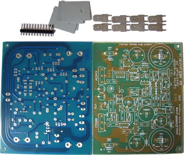

So, to assemble Nordic board you need board schematic to check things, because of that i have asked Nordic to print the values over the board, values printed directly in the silk screen.
Greg site has other schematic, offered by a friend, if not Greg the one could be Sparkle.... and the part numbers are different, but no board there, so, that schematic we have at Gerskine site has not pcboard matching the part numbers.
I think i may have the copper side inside my backup HD, when found i will post it, the one matches this board made by Nordic.
Maybe we will have board from Taj, and this will be even better, because Nordic is unreachable, he has disappeared, i am afraid he has passed away, i hope i am wrong about that.

  • HRII - Nordic board upper view.pdf

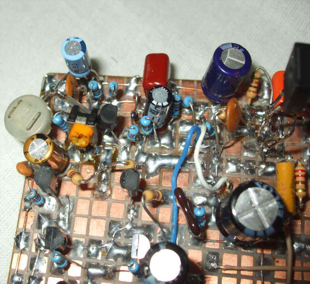

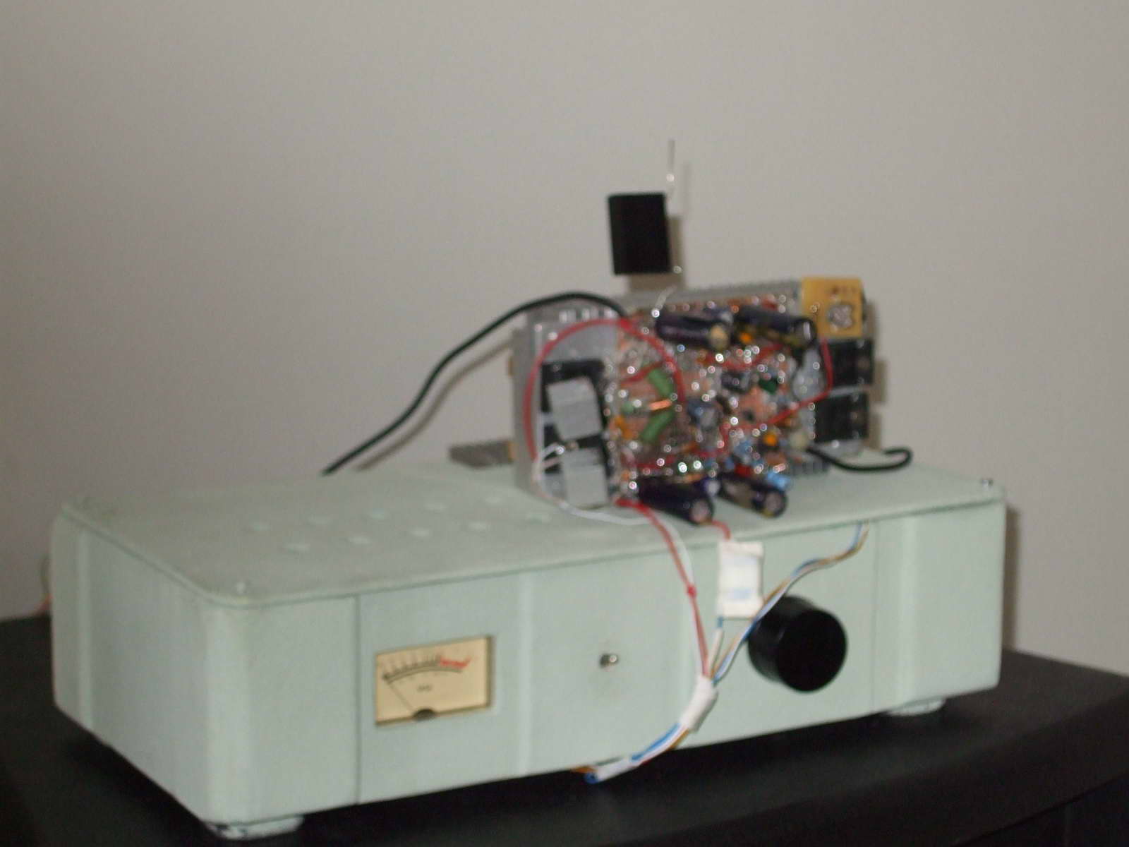

I have made the HRII, the worst way i could, to force unstabilities
The circuit is the one posted in the schematic, i have installed a CCS, and will search a micro switch to listen zener voltage regulator OR, ccs.
The bad focus was made intentionally, too much ugly, wires crossing...all the bad things to unstabilize.
It is running very well.
I am having fun...
Merry Christmas folks.
regards,
Carlos
